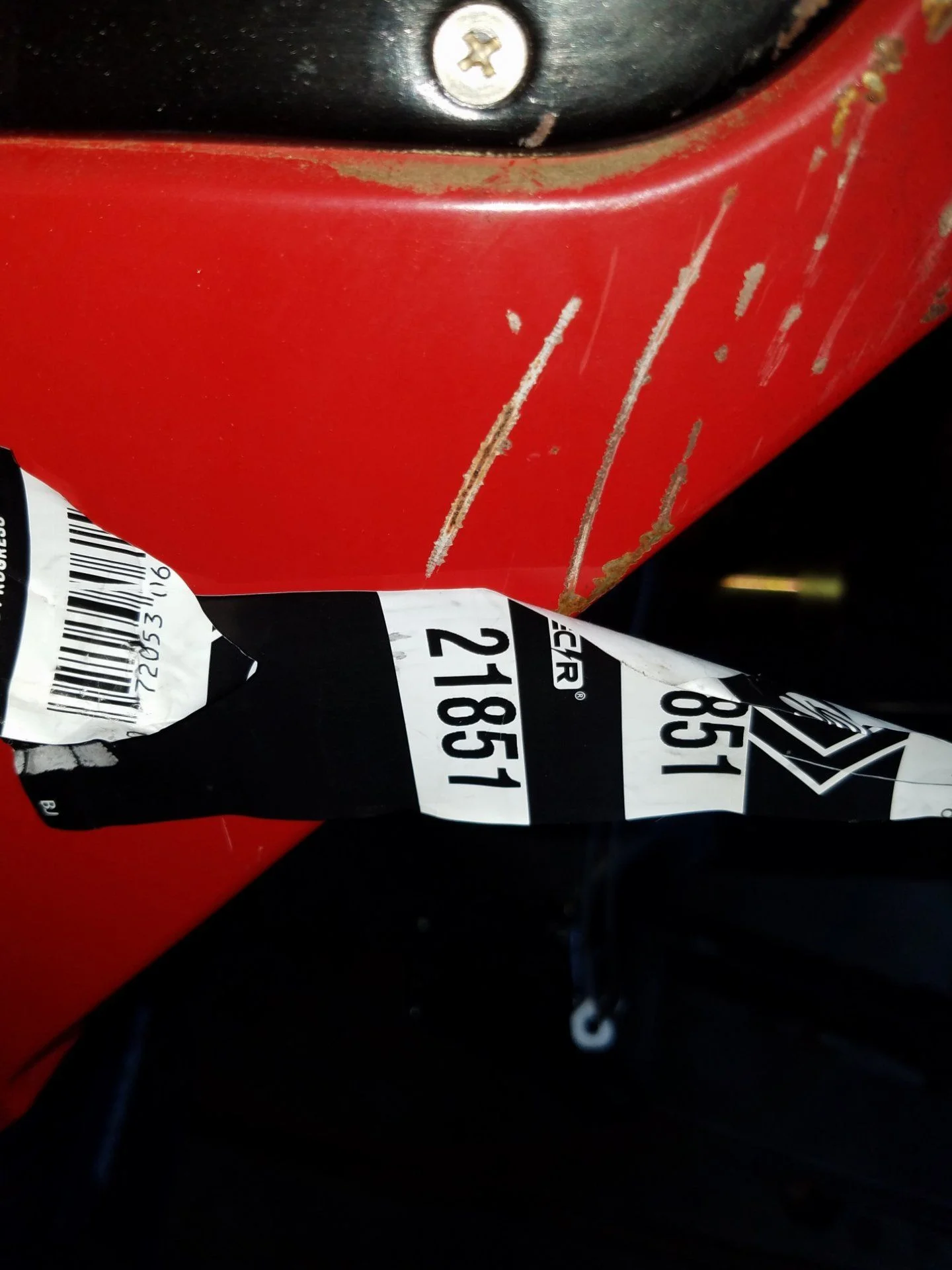

Finally found a lower radiator hose that is a good fit!
Gates 21851.

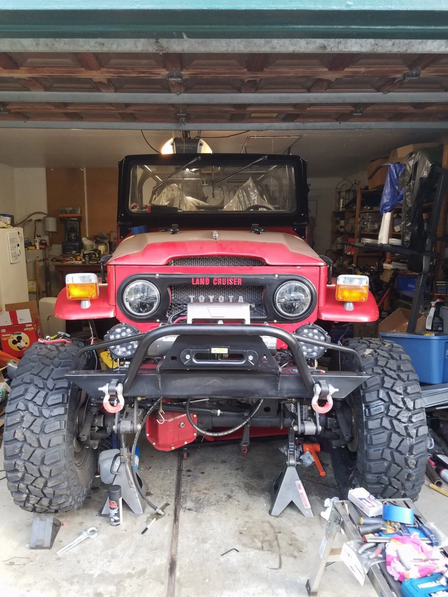

Start up should happen today. I will take and post video.
The saga of wiring continued today; with the relay activated circuits almost complete (I ran out of isolated female spade connectors today) I realized that the great majority of the wiring from the painless harness will actually be discarded, which gave me a huge relief.
So CTW will be it's maiden voyage?
That's the plan. I'll drive it around the neighborhood and for errands to check for leaks and get the gears broken in, but CTW will be the first trip in the woods (fire danger allowing).
More wiring completed today. I need to go over my checklist, but first drive should be
this week (i hope).

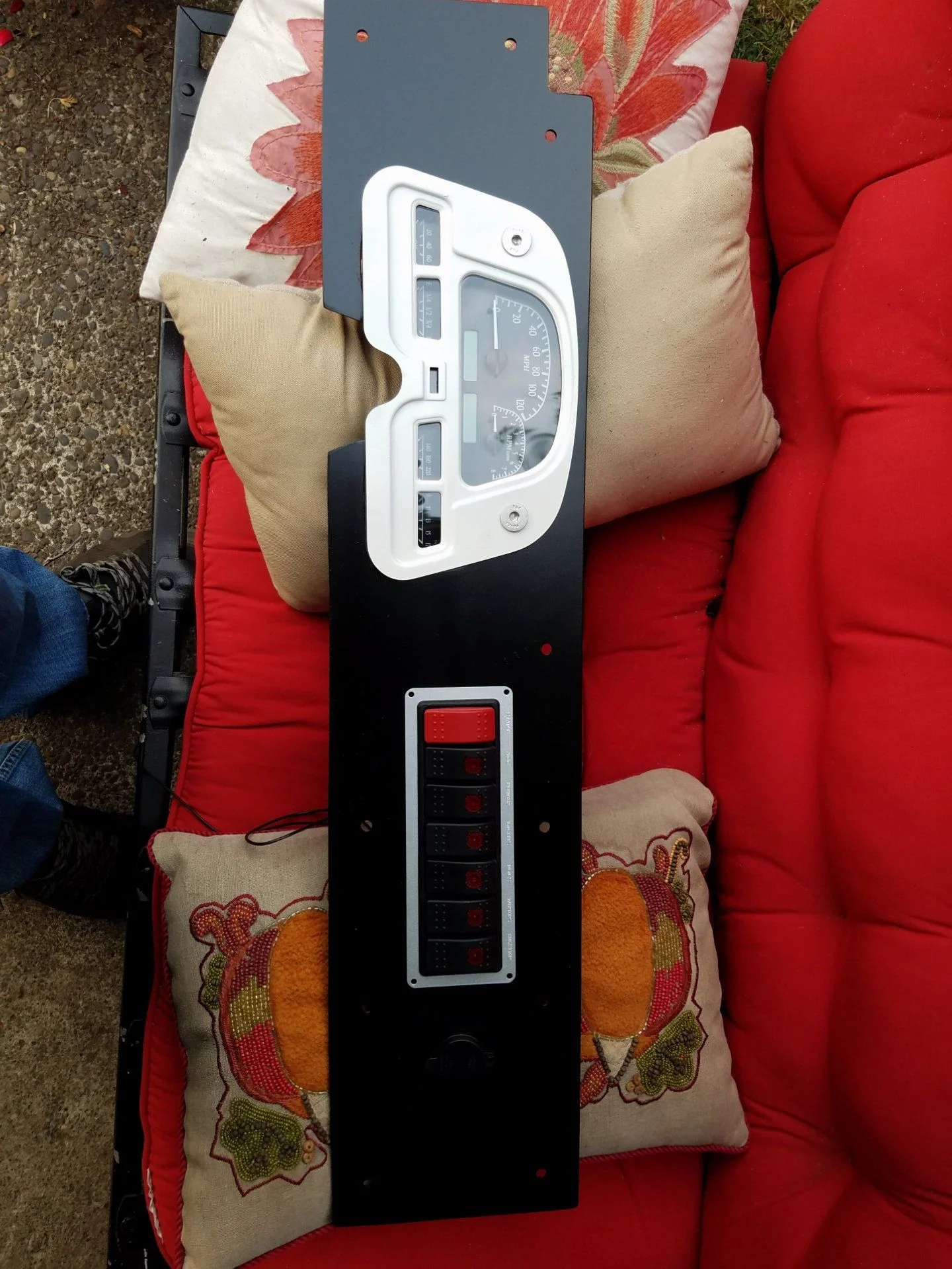

So I'm wrapping up the wiring (still need to make a dash to mount the accessory switch panel and Dakota dash) and found that I'm missing my brake switch. I have a fancy little dual function switch from PSI to actuate the brake lights as well as the torque converter lock-up function, but installation would require some fancy fabwork underneath the dash. Instead, I'm going to run a relay tied to the brake switch (ordered a new one) that will activate the TCC.

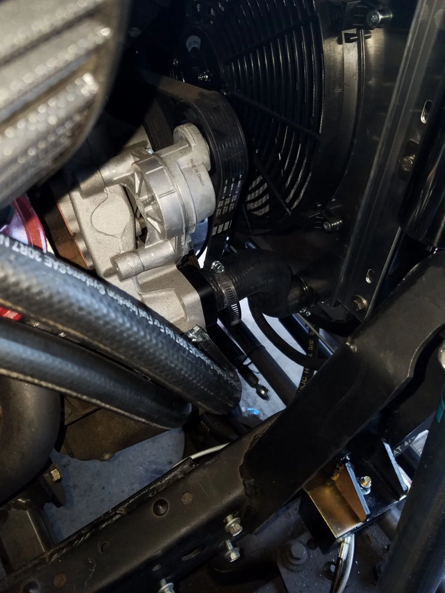

I then was wondering why my cooling fan never kicked on while the truck was running, so I tested it outside of the truck. It was dead. This is the second issue I've had with a product from Champion Cooling Systems, the first being their "FJ40" radiator did not fit in the factory mounting location without hood interference (I've since found I'm not the only person with this issue), and now the fan they provided as a part of their "kit" was nothing but trash.
