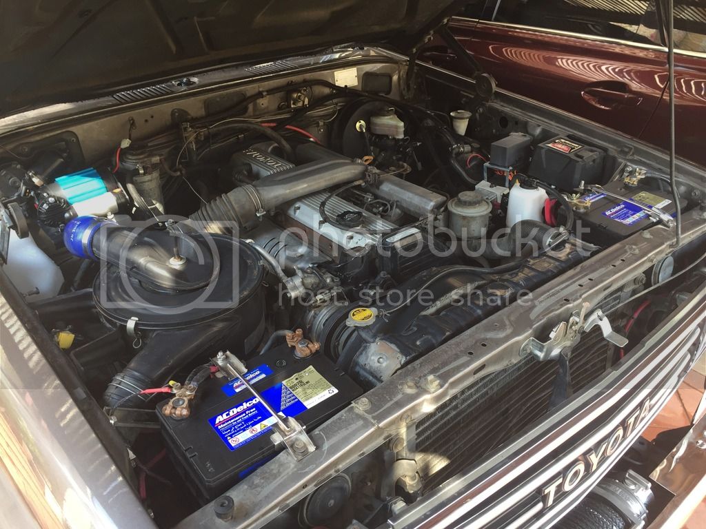

Suggest you give Georg a call (650-576-2023). He will give you all the options and cost estimates. He has a lot of custom parts (i.e. motor mounts) you should consider purchasing from him if you plan on doing the swap yourself. If you want him do the work, it will not be inexpensive, and his waiting list lengthly. He did my 60 a couple of years ago and I'm very happy with the results.
But get a turbo set up from the beginning
Agreed! I had initially considered NA, but I'm glad I went with the turbo. Even with a mild boost of 12#, it makes a huge difference in performance. For my install, Georg went with a generic Garrett, with a custom adapter. The 1HZ into a post 8/85 60 is one of Georg's preferred conversions, as virtually everything is bolt in except the motor mounts. Extending the wiring to the drivers side for the fuel solenoid, starter, oil and temperature sensors is all that is required. However, I would highly recommend adding an auxiliary relay in the start circuit, as the 1HZ starter solenoid current (18 Amps) is a bit much for the stock wiring.

Suggest you give Georg a call (650-576-2023). He will give you all the options and cost estimates. He has a lot of custom parts (i.e. motor mounts) you should consider purchasing from him if you plan on doing the swap yourself. If you want him do the work, it will not be inexpensive, and his waiting list lengthly. He did my 60 a couple of years ago and I'm very happy with the results. View attachment 1407016

It wasn't a kit; Georg fitted a Garrett GT2860 using a custom adapter to mount it to the 1HZ manifold. I believe several people are now making this adapter. All the intake piping was fabricated from locally purchased parts.
