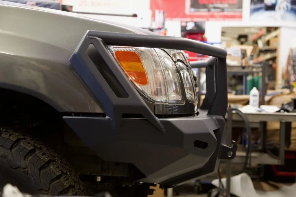

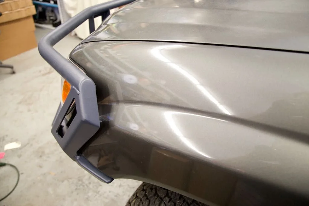

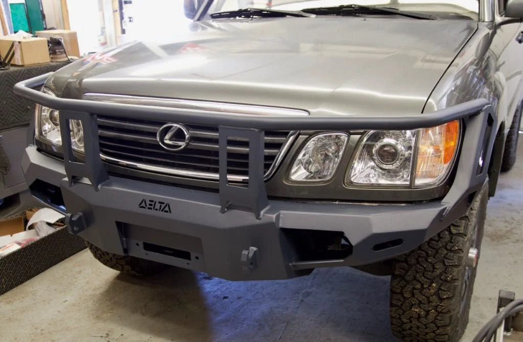

Wow. That's quite a statement.
I really like the bumper itself. Design is great. The recovery points are cool. Will the holes on either side of the winch bucket hold the same light options as the 80? I am slightly concerned there is no area for airflow at the bottom of the radiator. It's been mentioned once or twice in the forums before, ie: Installing light bars in the gap on an ARB. Probably not really an issue, but having seen temps recently spike on trails, I'm more conscious of it lately. Will anything be offered for external light mounting options? Are your winch boxes fitting inside the bumper or are you mounting under hood?
I'm not sure how I feel about the bull bar yet. This is coming from someone comparing to the ARB combo on my truck, that I don't love, nor like enough not to keep my eye on other options: The extra protection behind the headlights and on to the fenders is awesome. Assuming clearance isn't an issue with minor deflection against the paint, that's a badass feature. I worry that it does leave the headlights completely exposed. In the areas I wheel, it's pretty common to need to push small brush here or there. My ARB does a decent job keeping anything from the lenses, but it looks like this would be pretty wide open.
Thanks for putting some thought into your reply, much appreciated. Yes, the light mounts are the same idea as on the 80 bumper: blank, Rigid Industries style (they fit the real RI lights and 95% of the knock-off "off-road LED fog lights" on amazon/flea-bay), and Baja Designs. My preference is for Baja Designs as I like that company a lot more. Much easier and nicer to deal with. Valid concern about airflow, but quite a few aftermarket bumpers for these have chosen to err on the side of more protection than airflow, and we chose to do the same thing. The lost area of airflow is fairly minimal though, but certainly have not done rigorous testing or anything for temp differences.
As far as external light mounts (bars/big ARB/LP9 style deals) are concerned, we are making a super custom bumper for an 80 customer and integrating little mount tabs for lights and antennas, so those will be available on this as well.
Winch controls are tricky for sure. We have a mount for the 80 bumper that bolts to the back side of the bumper, but I'm pretty sure there won't be room for that on the 100. It will kind of depend on the winch too, eh? Moving the Zeon controls is very different than moving Smittybilt X2O controls. The winch tray is 10" deep to give you a number.
The bullbar is definitely a unique approach, no arguments there. We will also have the center hoop like we currently offer for the 80 available, but this first one is for someone who lives in deer country and we went for our take on full protection. We are working on something very similar for the 80 now. There should not be any contact with the body with flexing, etc, plenty of clearance there.

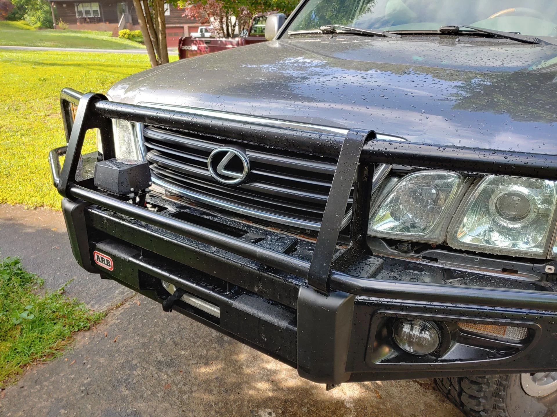

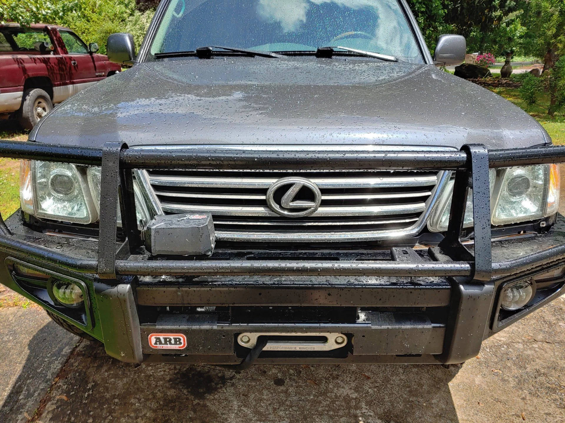

Airflow likely isn't a real problem. Just a consideration I had. I think mine is a little warm-natured anyway.
For winch controls, mine is pictured, for an example. I'm not familiar with what most others have. Worth noting- it does not fit in my ARB with my 9500lb winch, but the bumper does have tabs that I used for external mounting.
For the ARB's bullbar, here's what I'm kind of seeing: The ARB's rearward vertical terminates in front of the lights, vs behind them. In theory, a relatively straight object could make contact with that point and the forward vertical without ever touching the lights. With the rear vertical behind the lights, that straight object would make contact with the lights before both verticals. There's also that very low horizontal you mentioned which I have in fact seen catch pointy sticks from moving up toward the lights and grill. I recognize based on what you mentioned, that my uses for the bull bar aren't the same as the intent with yours.
None of this is to say any bumper needs any of what I'm talking about. I don't know of any other being produced that would be exactly what I'd want in every aspect, so this is just conversation from someone doing some early homework. I think your stuff looks great, hence so much thought about it.
(FWIW, I mainly bought the ARB because I got it NIB for a couldn't say no price)
That is a good looking bumper. I am not a big fan of the bull bar look but yours looks the best of any I have seen. I thought the bumper was going to look like a Road Armor overkill design. I was wrong, it looks proportionate and complements the Hundy. Not an easy feat to create a new bumper design that looks good and provides front end protection. Job well done, cheers!
