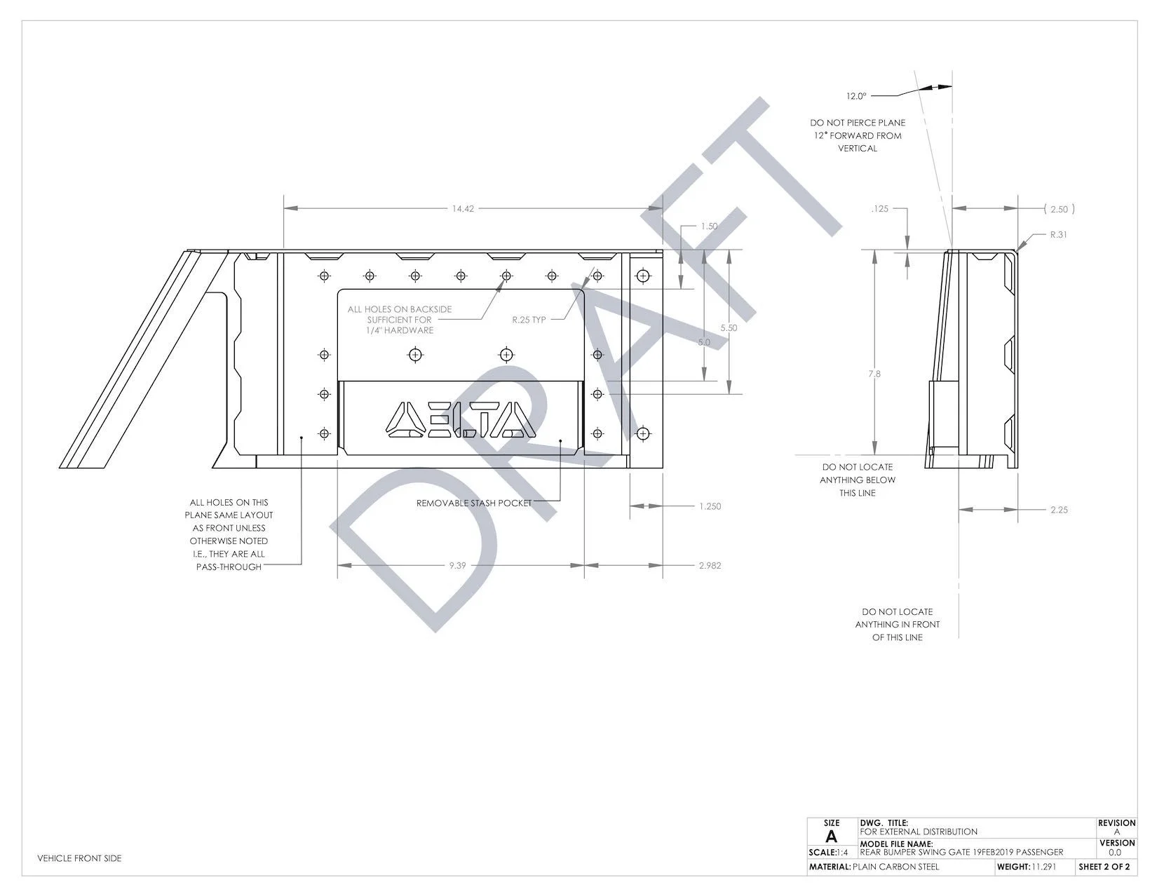

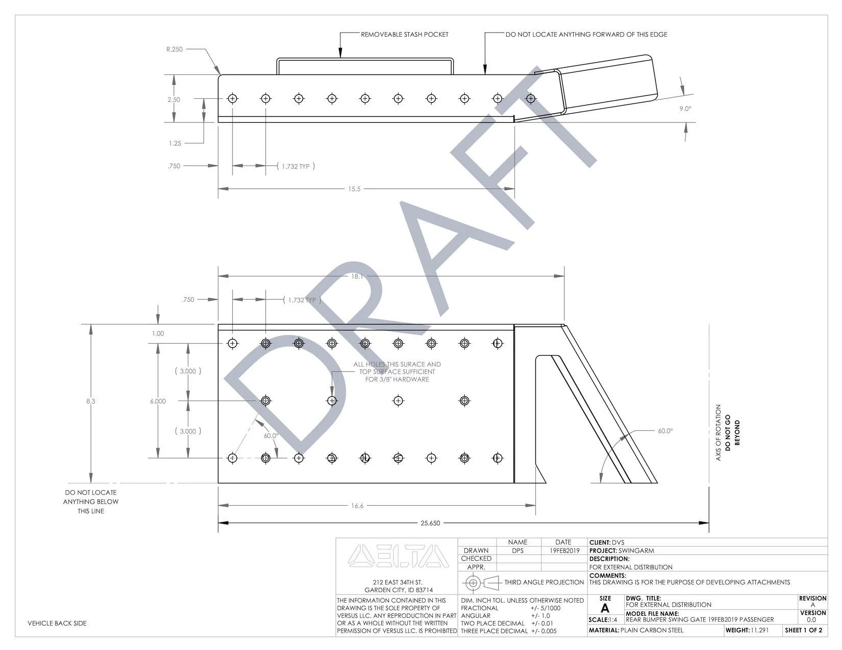

Howdy folks! We are getting frighteningly close to releasing the rear bumper and have decided it's time to release the data for our swingarms so other folks can start planning how they want to design components that will attach.

Anybody who has any other ideas on what would be good accessories can use the data below to design their parts. We are happy to work with people on this and can provide more data if necessary and there is proven effort on the individuals part. We are open sourcing this data for use by the community on the condition it is used to make accessories for our swingarms, not to copy our swingarms. You are free to sell the accessories on your own, or we can work out an agreement to sell them for you on our site, that is up to you.
Attached below are DRAFT drawings with the appropriate data. When they become FINAL they will be available as a PDF download from the bumper page on our site.
If you have any questions, ask away. But let's keep conversation on topic (this data, how it can be used, any deficiencies, interpretations/understanding, etc), k guys?
No, we will not be posting 3D models of anything. If there is a dimension you need that isn't on one of these drawings, please send an email with marked up drawing showing the data you are requesting to info@deltavs.com. I will get back to you quickly.
Yes, the distance between holes is "wonky". This is because the distance between holes is driven by the 6" height differential and the 60* angle. This is a very easy layout to deal with in CAD, so it drives everything moreso than an "every 2 inches" kind of layout. This supports CNC cutting more than blunt object cutting.

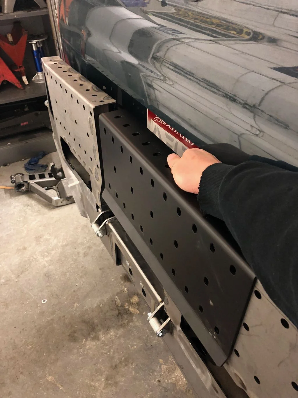

Edited to add this photo so it's clear what the drawings are for. This is the mounting surface for all of our attachments and components. The drawings should provide all the details so anybody can make their own attachments.

Hey Phil, what do you mean by interchangeable? The arms themselves? Or the stuff that gets bolted to the arms? The above drawings are for the upper part of the arms, I'll edit the OP and add a photo of where the drawings sit relative to everything.

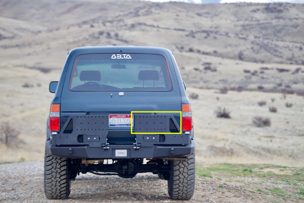

I'm guessing the center extension works with either arm? And does it get in the way of the opposite swing arm? Noticed on IG you only had one arm mounted on the pic with the center extension with tire carrier.
The center extension does indeed work with either arm. It is designed to work with one arm as a way to carry a tire and hilift attachment on one arm. Haven’t actually checked clearances to see if it would fit with both. Will do and report back.

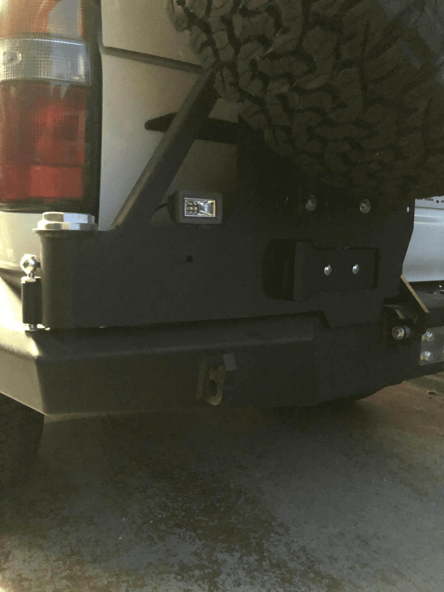

may I see a closeup shot of the swing out latches, if allowed? They look interesting from a distant!
I have this picture. Not optimum light. I was showing where I put a back-up light.
