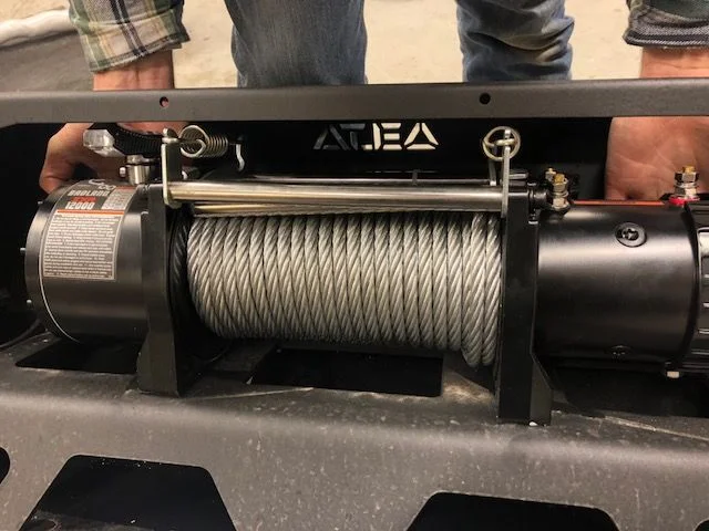

Update on winch fitment. Got a HF 12K winch the other day for the shop trailer and test fit in an 80 series bumper. Squeezes in there just fine, 100 series has tons more room so winch size should be a non-issue.
Have a mess o' parts in the shop now to weld up the first one. Will post up some pics on a rig in the near future.

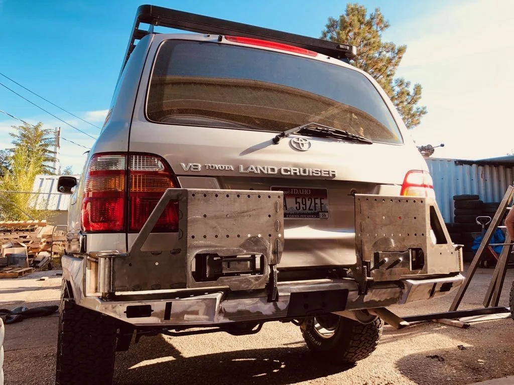

Six months since donating my '99 LX470 as the template for Delta's 100 series bumper(s) build....
Hopefully they'll be finished and on the market soon, for all of us to enjoy.

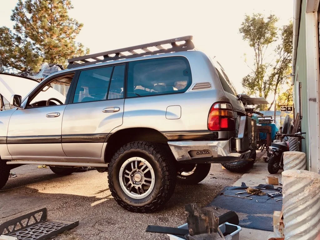

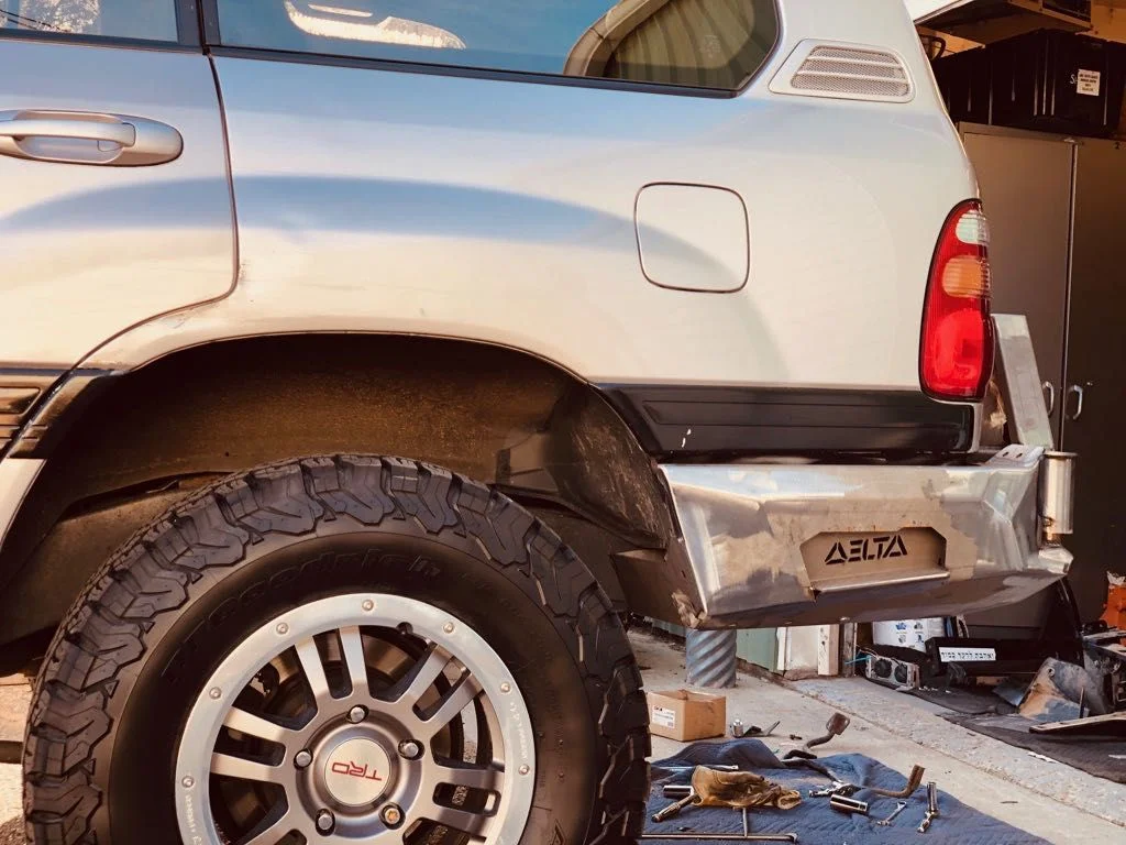

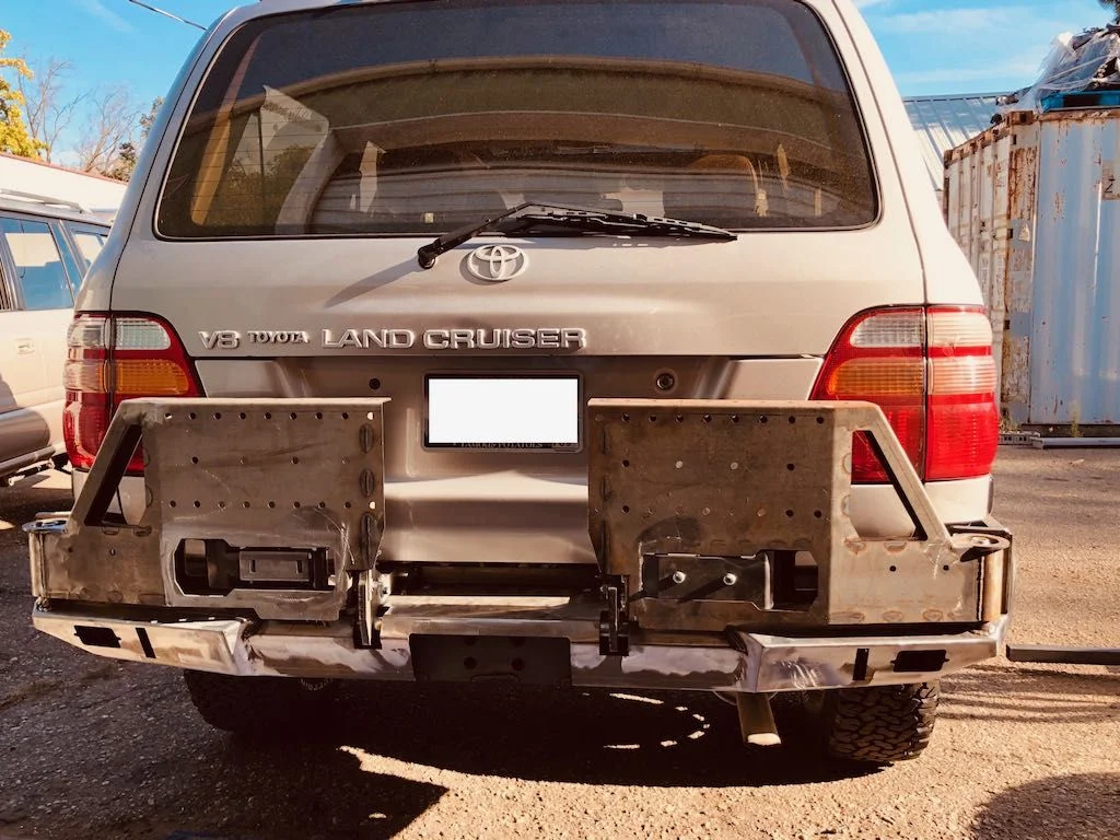

Time for a quick update, rear bumper is getting test fit on a second vehicle so we can be confident fit is good. Off to powdercoat, then installation for first vehicle.

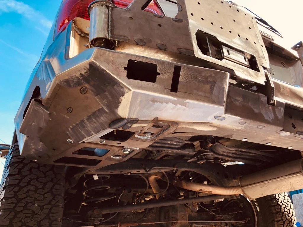

I'd like to understand the reasoning behind the overhang on the side, I understand that it makes it a nice step but... I'd rather not have a tab to get hung up on the trail, or walk into... I'd make that trade for a smaller step. Same is on the 80.
Couple notes from the 80 bumper I saw... pretty easy to resolve, but things I did not expect to see on a "top of the line" product and things that I hope to not see on the 100 bumpers when they make it into the wild.
- Fastener grip lengths were all pretty short, probably need another 1/16 or so for thread protrusion. No reason a fastener should only half engage the locking feature of a nut. 1.5 thread protrusion if you wanna be legit.
- No washers under some heads/nuts... bit of a bummer, there is no reason a top of the line bumper should ever have nuts turning on the finish. Never ever.
- Strike plate overhangs on sides.
- Swing outs hit head of socket head cap screw when fully open instead of pin catching the hole. Chipped power. Use a pan head instead.
