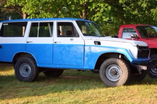

I don't think what you're looking at will be bad, I've got 3" on mine and it's not terrible for the family to get in and out. Another local Mudder Jason has a stock height pig with 31s, a little lift definitely helps the rear departure angle ;-). I'm also adding sliders with a step for the same family concerns, look for pics in my thread soon.

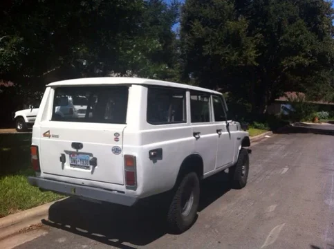

From thread....love the all white Pig, by the way. At times, wish I had held out for one that could be returned to, accurately.
Has [33x10.5 BFGs] the old MAF Safari 4" lift springs with helpers in the back, OME 70 series shocks and beefy shackles.
I've got 3" on mine....
It's difficult to tell in pics how "tall" any of these are, but it looks good, proportionally.

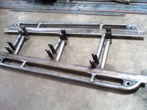

I'm also adding sliders with a step for the same family concerns, look for pics in my thread soon. Tucker
Saw and like.
Have every intention of sliders (need to add to weight consideration, I guess) as an effort to prevent door dings.
Justin,
Thanks, but haven't done much, yet. Getting there though.

Like the sliders and bumpers on your Pig. Still fabbing ?
Lol. No worries. We are 3 months out right now so our schedules wouldn't work. We are still fabricating. Actually we are about to do another 78 with the same armor as the iron moose. If anyone wants the sane bumpers or sliders. Let's me know we might be able to do a small batch for you all.

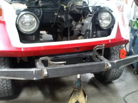

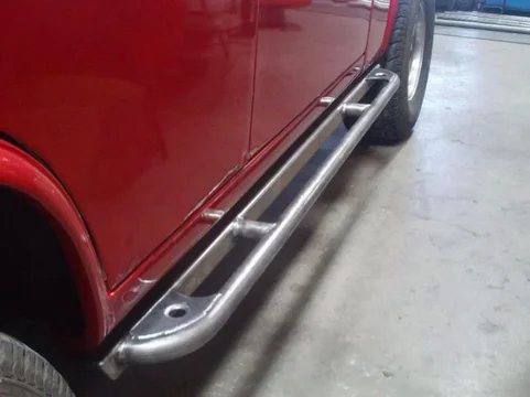

Posting pics here, since the subject was broached.
Sliders look good.....
I like the corners rear bumper, but need to swing out, nor provisions for.
Front would work for me, with a smaller hoop, no winch tray, not provisions for winch.
Could almost be happy with this...
Hoop
My goal for armor is protecting in the parking lot.
Had thought about attempting to wrap the rear quarter and reinforce the crap out of the wings, same with reinforcing the wings on the front, mostly as added rigidity to a minor mishap, not wheeling.

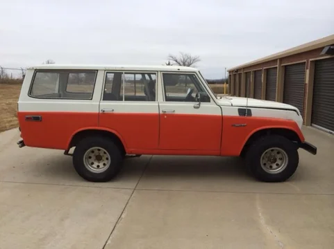

33x10.5 look too big on a stock height pig.
My '72 with 33x10.5 KM2s and flat leafs.
Don't think it's horrendous.
Going to pull the new KM2s from the '72 and swap to '76.
I had 31x10.5 on my stock height pig and it looked right,
Still looks taller than mine with same specs.
then I put some 33x10.5 KM2 on and the wheelwell was full of tire, just looked wrong.
Hmmmm.
So I iput a 1.5 shackle lift on..cheap and easy. Looks so much better.
I'm thinking about the same.

Based on pics, added +1.5".
