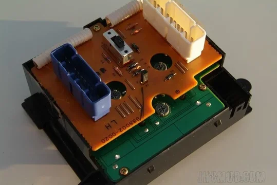

There are three B type bulbs that light the symbols. All others are soldered into the circuit board. These are the LEDs that light up above the symbols when you press the buttons.
The 3 B type bulbs can be seen in this pic as the three brown 'X's.

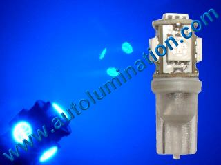

The 'dash' lights are the 4 main ones the light up the cluster. This doesn't include the P, R, D lights, the turn indicators, or the warning lights. The main bulbs for the cluster are 194 type bulbs. If you go to the autolumination page, they don't list part numbers. The description is:
Introducing the New 5 Led SMT Tower 194 168 W5W 2825
Outfitted with the latest Super High-Flux SMT Leds
Fully Regulated - Non-Polar Proprietary Circuitry. Protected Under (US Patent # 7,345,433)
The Widest, Brightest and Best 194 168 W5W 2825 Ever Made!
Only 10mm diameter x 32mm overall
Don't be fooled by cheap imitations, these are not available anywhere else!
(Note: these are slightly larger than stock 194 bulbs. Please measure to make sure they will fit before you order)
194 168 W5W 2825 SMT Tower
Super White Blue Red Amber
Order 194 SMT Bulbs (shown above): $8.99 ea.

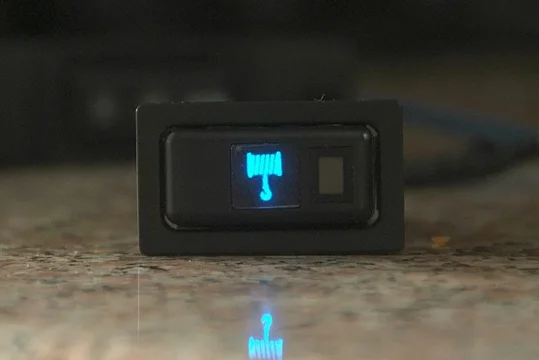

oh i like those winch switches, not the color, but love the switches! So how soon will you ship them to me?
LOL!!
When will you stop???
I'm waiting for you to mass produce these switches with LED color of your choice any day now!
Nice going!
I would send all my switches for the switch! Im just not that electrically inclined. Would love to change all my lights to led.
How did you get your switch relabels to look so nice with the light on? Mine throws light all in the [ ] area.

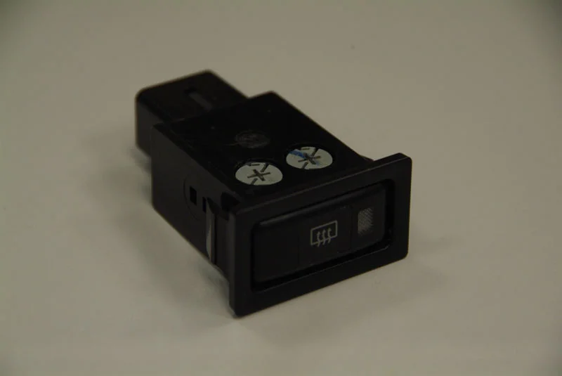

How does one take apart the rear defrost switch on a TLC 80 series? All the other switches have easily replaceable bulbs except the rear defrost. Anyone have instructions, or pictures?
attachment.php
via first page of this thread
the right bulb is the on that comes on when the rear defroster is on, and the left one is the illumination.
guessing yours may be the older dash style?
Mine is the Land Cruiser dash with the bigger buttons.
