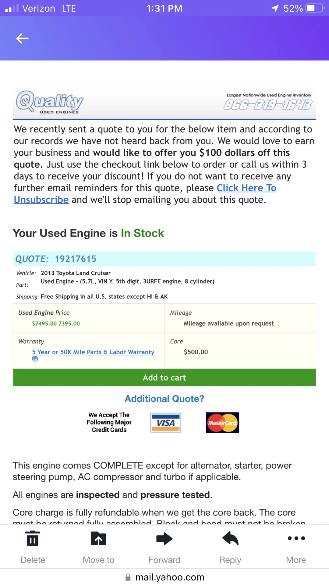

I have no affiliation or experience with these guys other then a coworker who has purchased a used GM motor from them. Looks like they have the 5.7 land cruiser engines available. They also have the 5.7 tundra engines which are a little cheaper.
Much cheaper to just buy a good used motor vs rebuilding this one....
