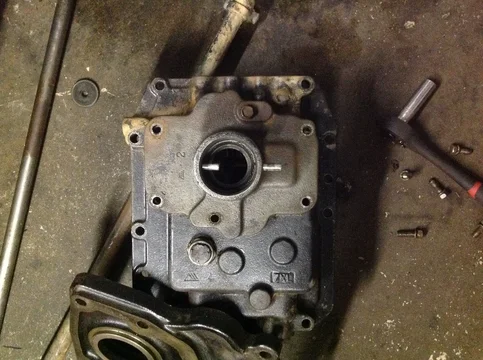

A little anomaly with the trans top cover. Once all the grunge was removed, I discovered that the pins for the s*** lever had been replaced with ordinary roll pins, as you can see in the photo. No way to stake those. I can get a pin repair kit from SOR, which works real good, but leaves two awkward bulges on the outside for intalling the lower shift boot, or I can just put on a good used cover, no boot issues.
Think about it.
