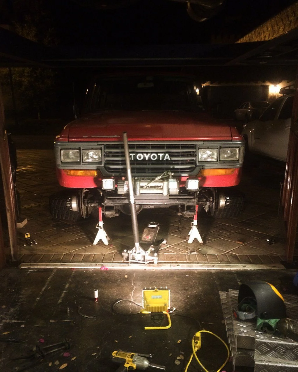

Finally got around to swapping the broken birf from my last wheeling trip. Here what your wheel bearings look like when you run with no inner axle seal for about month or two.
Also both trunions were roasted (lower fell apart in my hand), probably from when I jumped it.
Replaced those, inner seal and hub seal. Repacked bearings. All good. I'm sure I'll be back in there in three months or so.

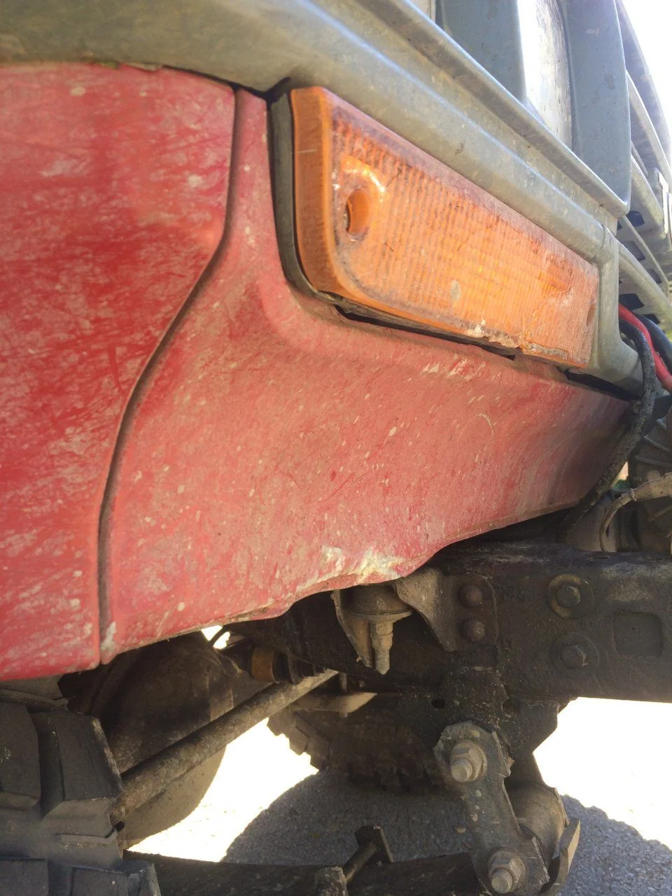

Then later in the day slid off a rock and nailed my front valence and turn signal (the fresh turn signal off course :bang:) need a front bumper

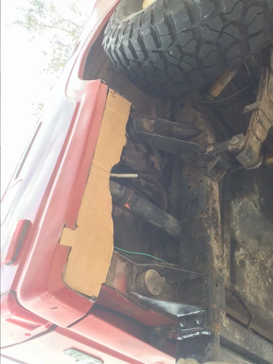

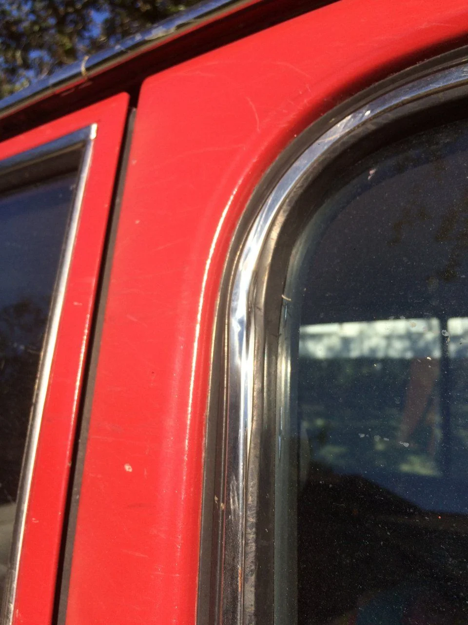

Instagram and we did some nighttime fast trail running through the National Forest, nothing hard 2WD the whole time but at one point We had to turn around and I was going in reverse about 20-25mph and I guess I snagged a tree branch on my rear 1/4 glass lockstrip? Annoying, but I ordered the last stock of black lockstrip from Wagongear so I guess I'll do all the windows.

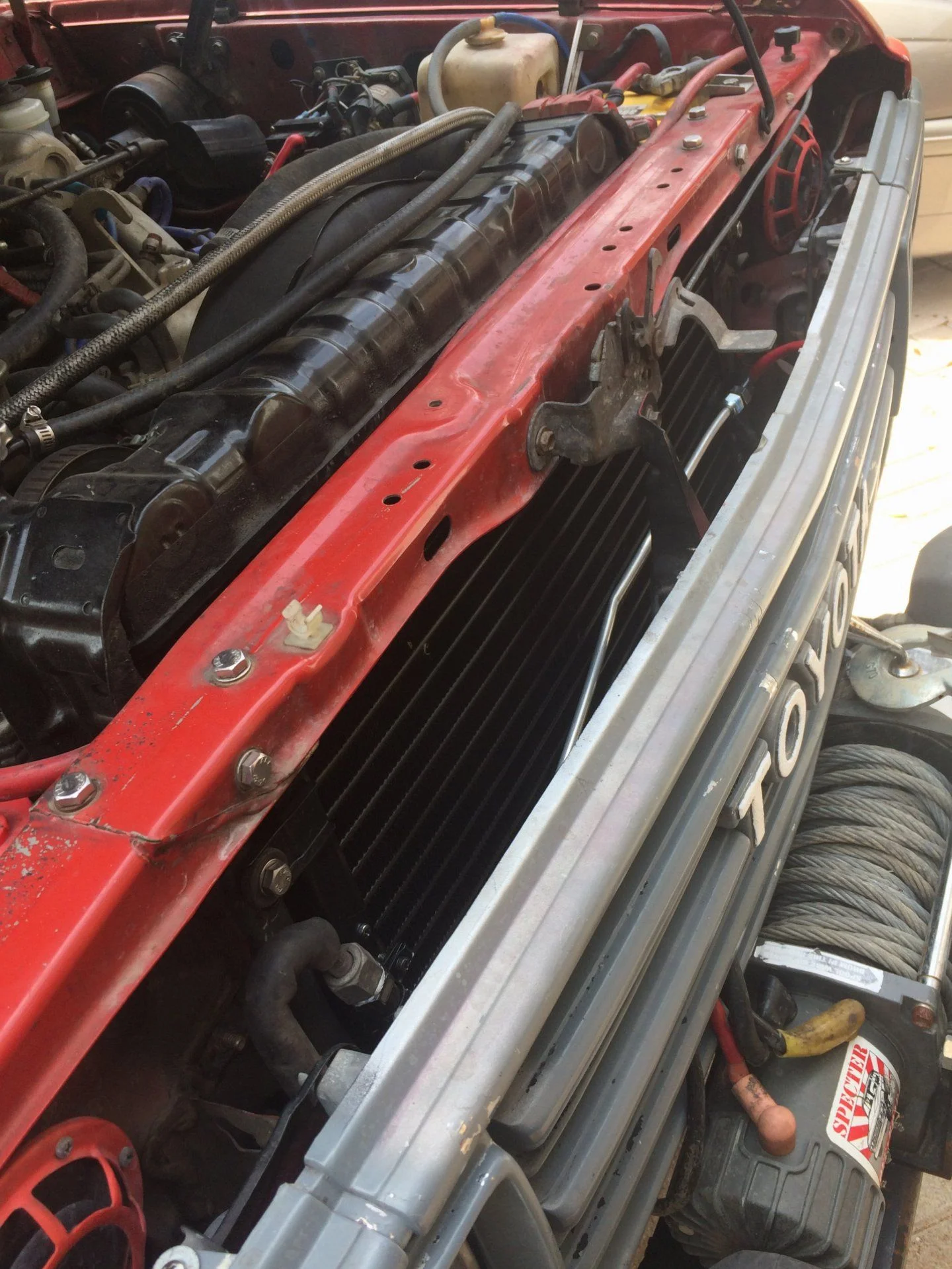

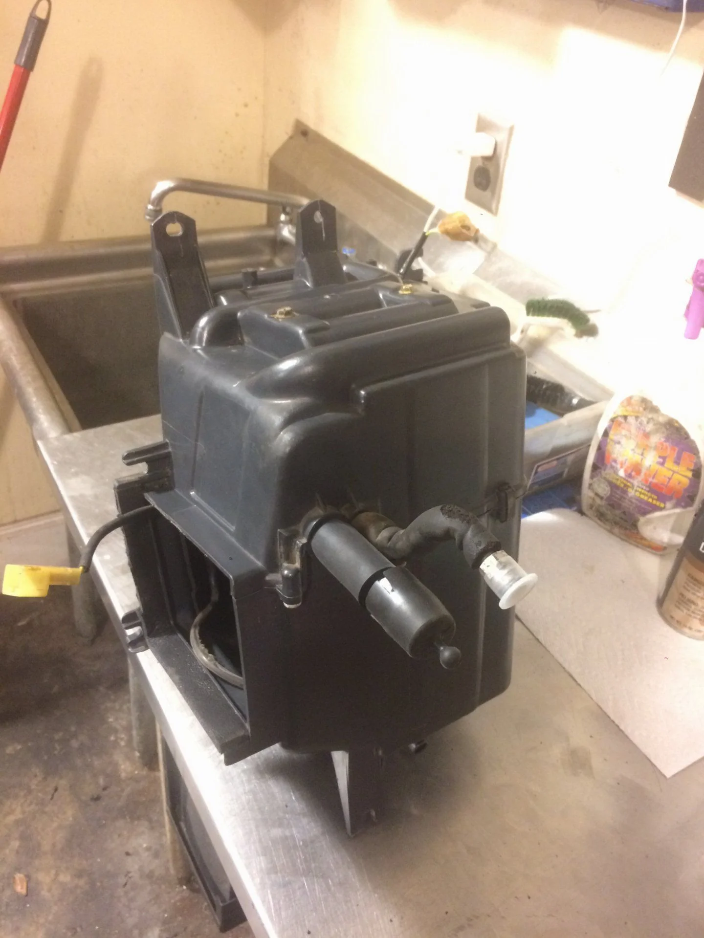

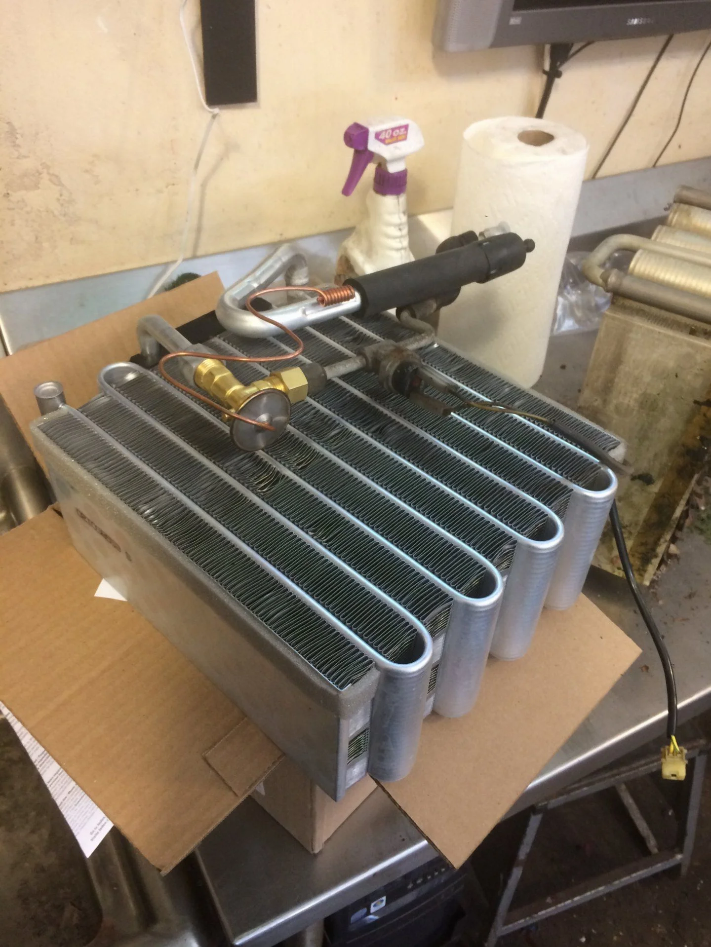

Two month update, have't done anything really besides driving the crap out of it up until this weekend, finally had a short life break so I installed my new Denso AC compresor and evaporator cores that I've had for months. The evaporator core was way easier then I expected it to be. Also installed new blower switch which is why I thought was why my blower wasn't working, turns out the actual blower motor disintegrated so I'm looking for one of those now.
This is what the old evaporator core looked like, Nature Hike!!

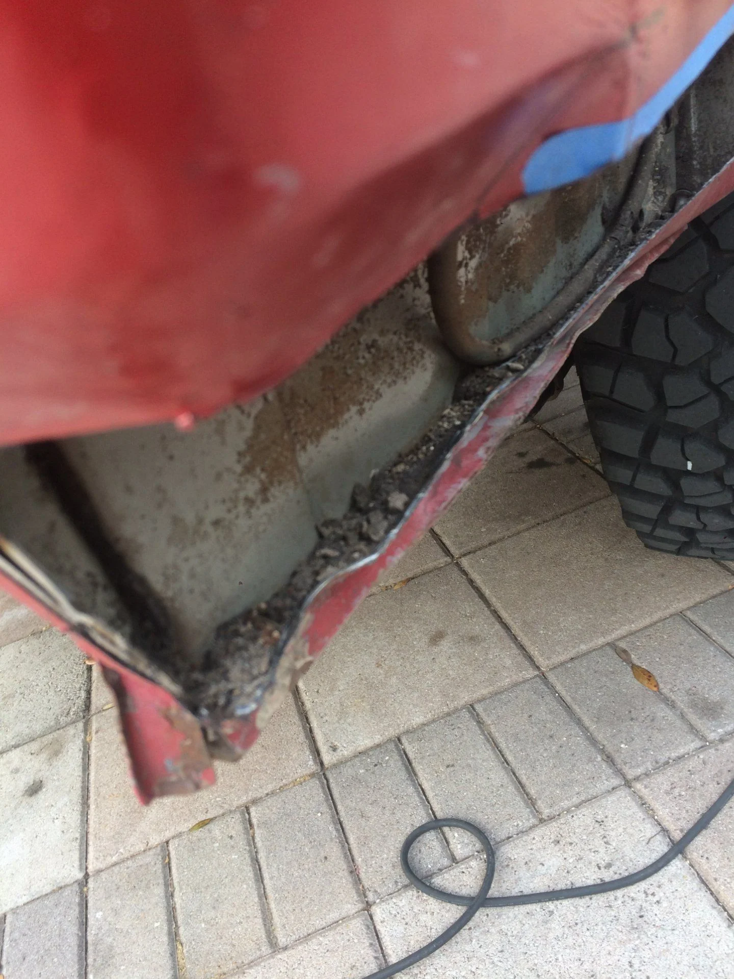

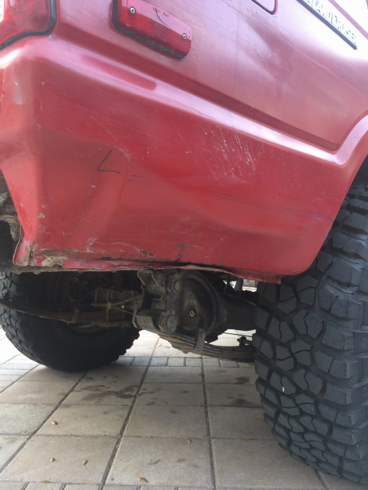

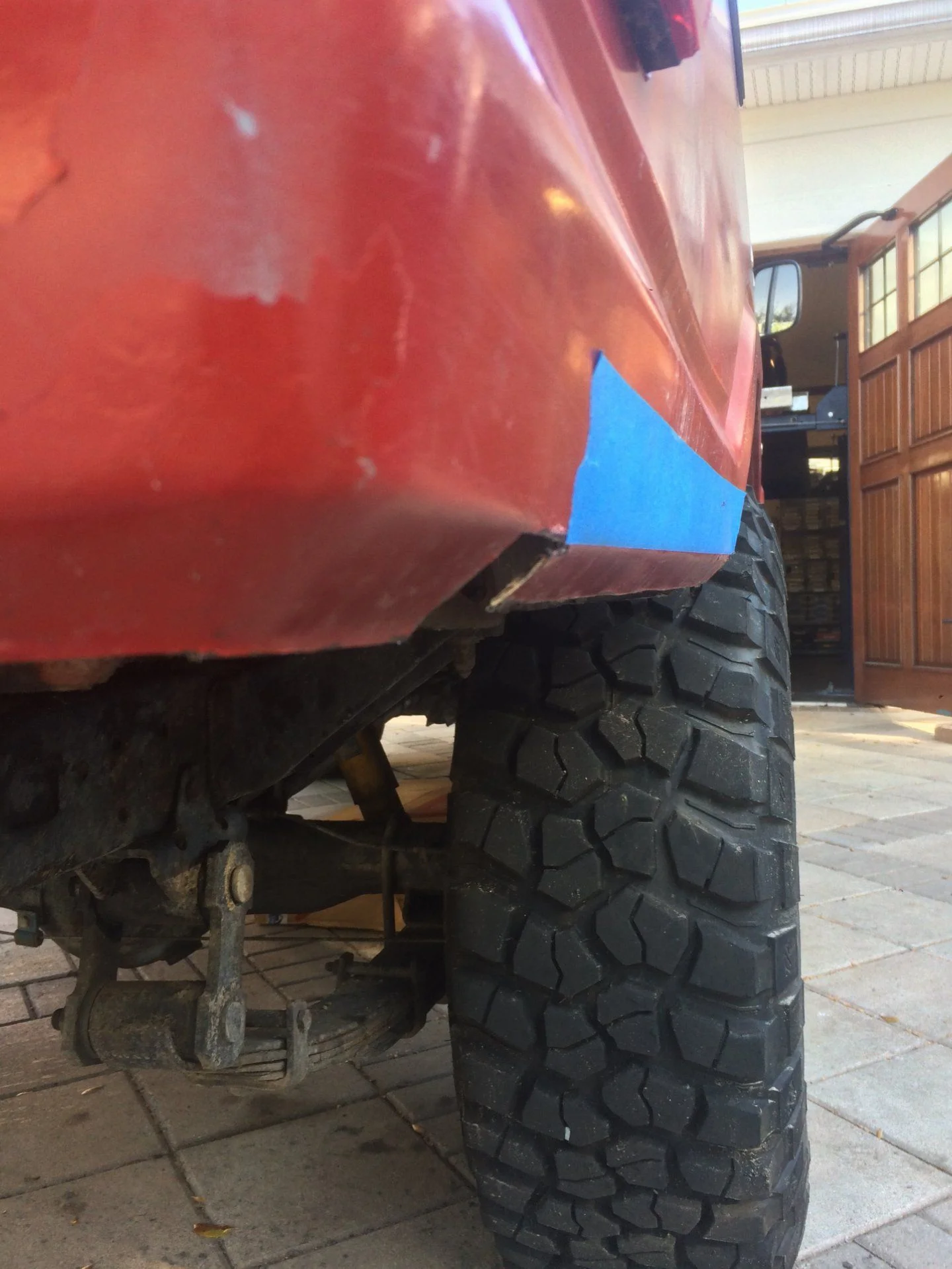

And I started my 1/4 panel chop last night. Already have the patch panel made but I need to bend the lower part to match the contour first before I weld it in.
Got my wisdom teeth pulled this morning so I'm in bed today but maybe expect to see me in the driveway grinding and welding with my mouth full of gauze? Lol

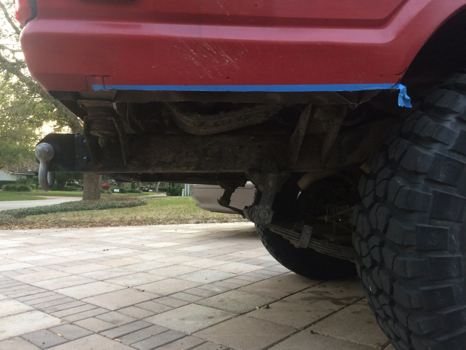

Just fine... I was out in the driveway the next day massaging the 1/4 panel chop, forgot to post where I got with that. It's not done (and haven't started the other side yet), need to hit it with some body filler and the orbital sander
