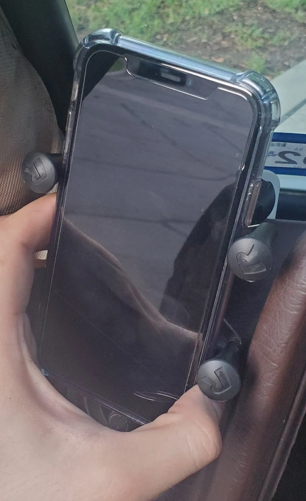

Would anyone be interested in a bracket to mount their phone to the left of the steering wheel. Like in the picture shown.
Im working on a bracket that requires no drilling/tapping into anything on the dash. I prefer to not permanently modify my FJ60

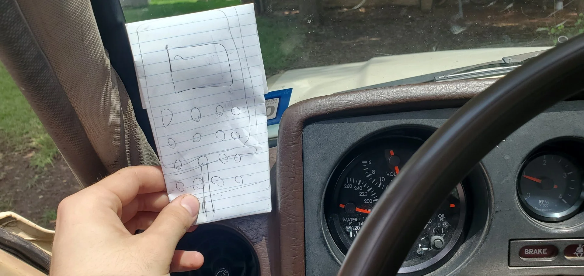

So how im designing it is to utilize the mounting points of the dash to the body of the FJ60. Both LHD and RHD FJ60's should be able to use multiple of these brackets. Ill post a design concept here soon

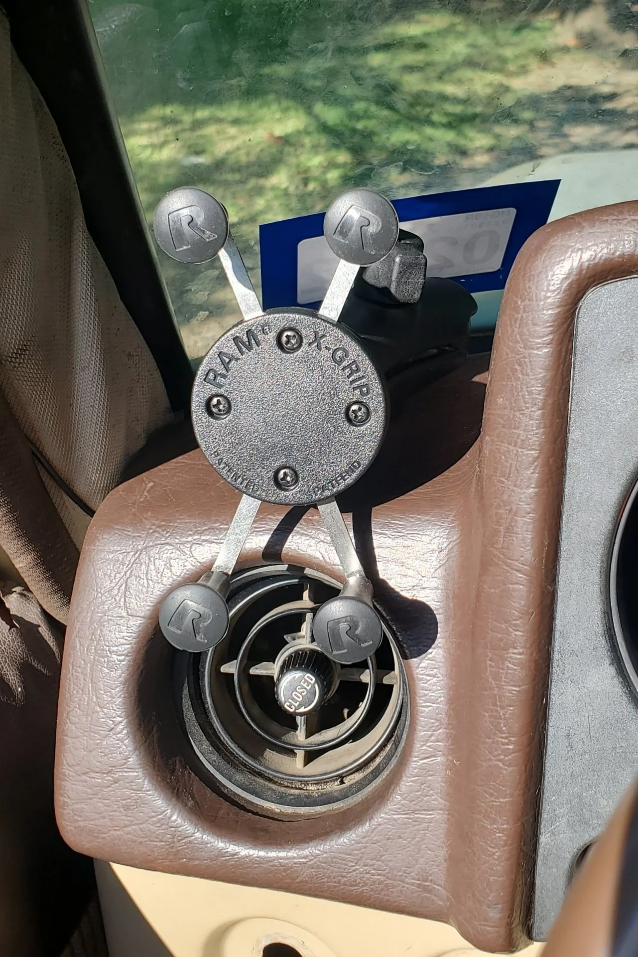

Theres a tad bit more vibration than Id care for, I need to reinforce the sheet metal around the stud I'm using from the dash somehow.
Other than the vibration and my extension arm being slightly too short I like this thing alot!
Im thinking about trying to find a piece of really thin channel to go around the lip of the immediate mounting area. I shoulda took more pics to better show what I'm talking about.

Looks like it is mounted I’m under the dash cap on the dash cap studs? Is that right.

Exactly! The revision im working on now will be slightly more complex but it should eliminate all vibration. A suction cup mount will work fine but if your in TX and you have a registration sticker in the way, mounting something can get complicated quick and bulky. The area to the left of the dash is pretty compact and hard to find usable space.
Im hoping this version will be a space sensitive/ compact / sturdy alternative.
