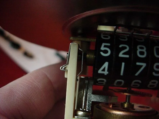

Can anyone tell me if I have the 4 pulse magnets or the 6 pulse magnets in the speedo pictured below?
