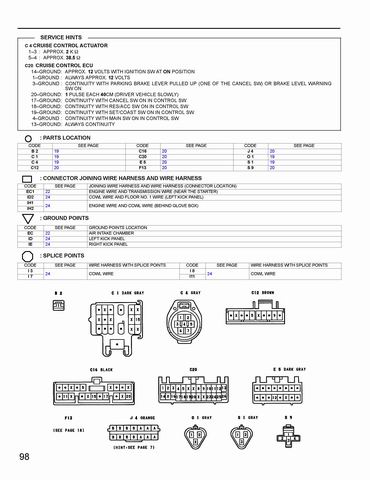

I do not know if the VSS from the transmission can be used for the ECU. I got it because it is used for the cruise control ECU. You can see from this page of the EWD that it outputs 1 pulse per 40cm (I think that's 4 pulses per revolution).
