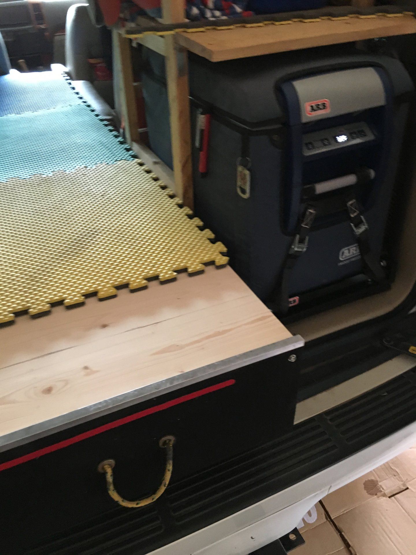

I have my storage box and saw "Frenchy", from ROF on Expo forums do this, so I decide good idea. simple and easy, makes a good sandwich making area when on the road or trail. Cost, some old wood and 30 mins, just trimmed the bottom side, so that it fits inside the drawer, so it doesn't move.

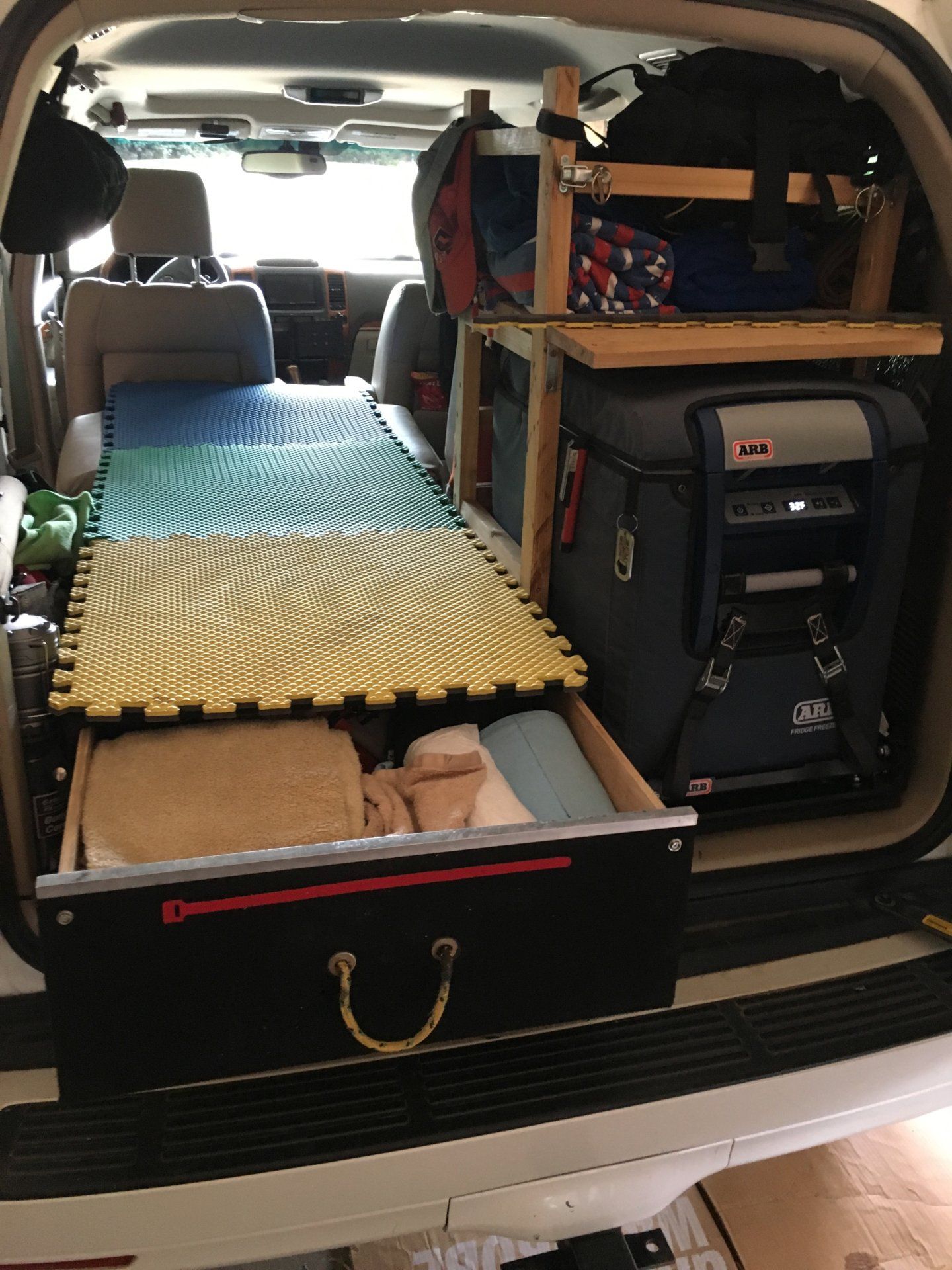

So I need a place to mount this board when going down the road, made a bracket to hold it.
I attached it to the underside of the rack over the fridge.
then I started working on another drop down table for thereat door, still need to hook up straps and a lock for while it is up.
Also need to decide on what I will cover these boards, since they will be uses for preparing food.
added a tailgate shelve for making food or something and a towel holder, need to get a pin to hold the latch closed
Great build...while the wood looks great, you can go to a kitchen supply warehouse and replace the drop down cutting board with a poly board for easier cleaning if you are using it for food prep. Just a thought for you!
Thanks, might need to do that. Next month I am rebuilding my off road trailer box and using POR-15 polyurethane and planning to cover the boards, but if it doesn't do the job, then a cutting board is next

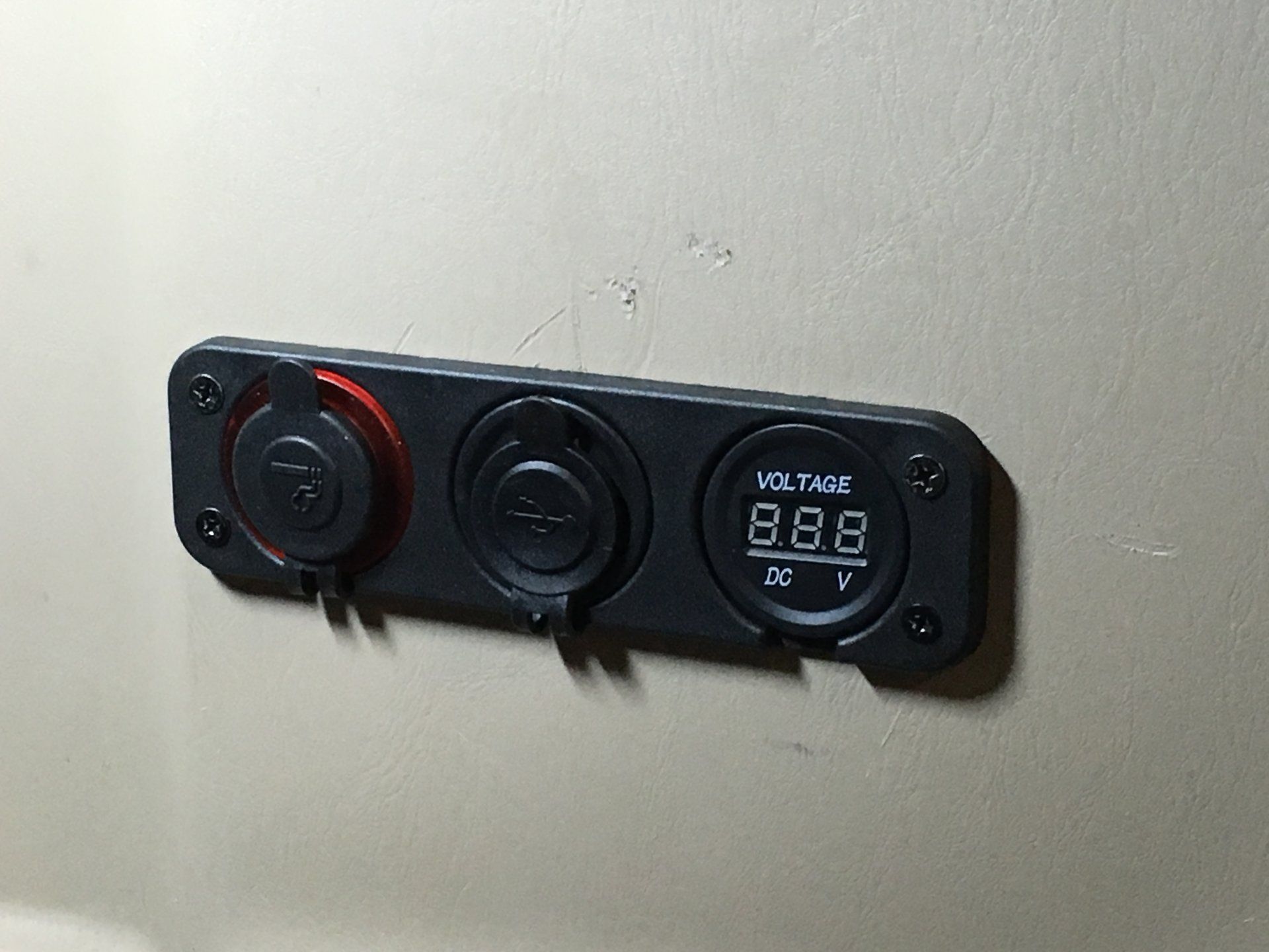

So today I added a power panel to the right rear, have not hooked it up yet. 10g power to the battery for the fridge and then jumper the for the USB & readout.
Wood poles are to build a area over the fridge
New GX owner here - great build thread, thanks for documenting so much of your work!
I have the same ARB fridge and am looking to run constant power to rear cargo area. What's the best routing for the wire from the battery back to the cargo area?
Thanks again,
-Roger
Thanks again,
-Roger
I ran the wire (8 Gauge for small power lost) from the right rear panel to the rear of the back seats (2nd row), then across and along the door still, then out through the firewall. When I did this, I also ran 5 more wires for future use encase I wanted power to something else inside the truck.
