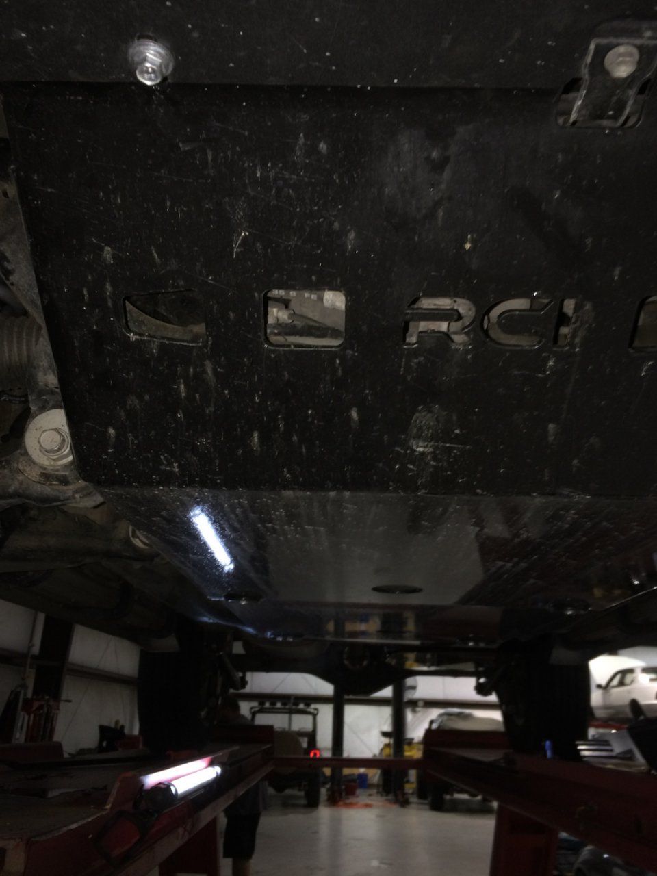

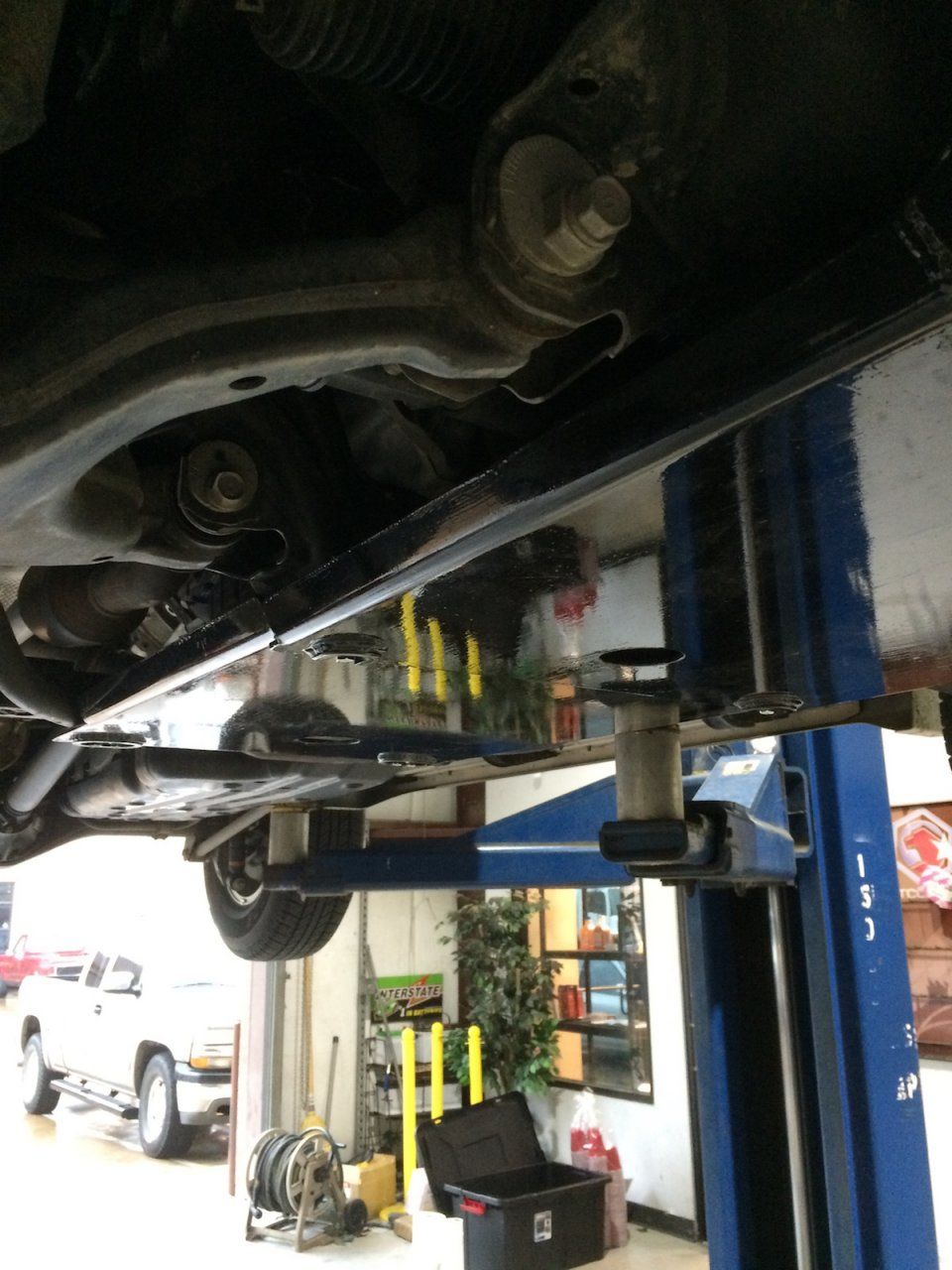

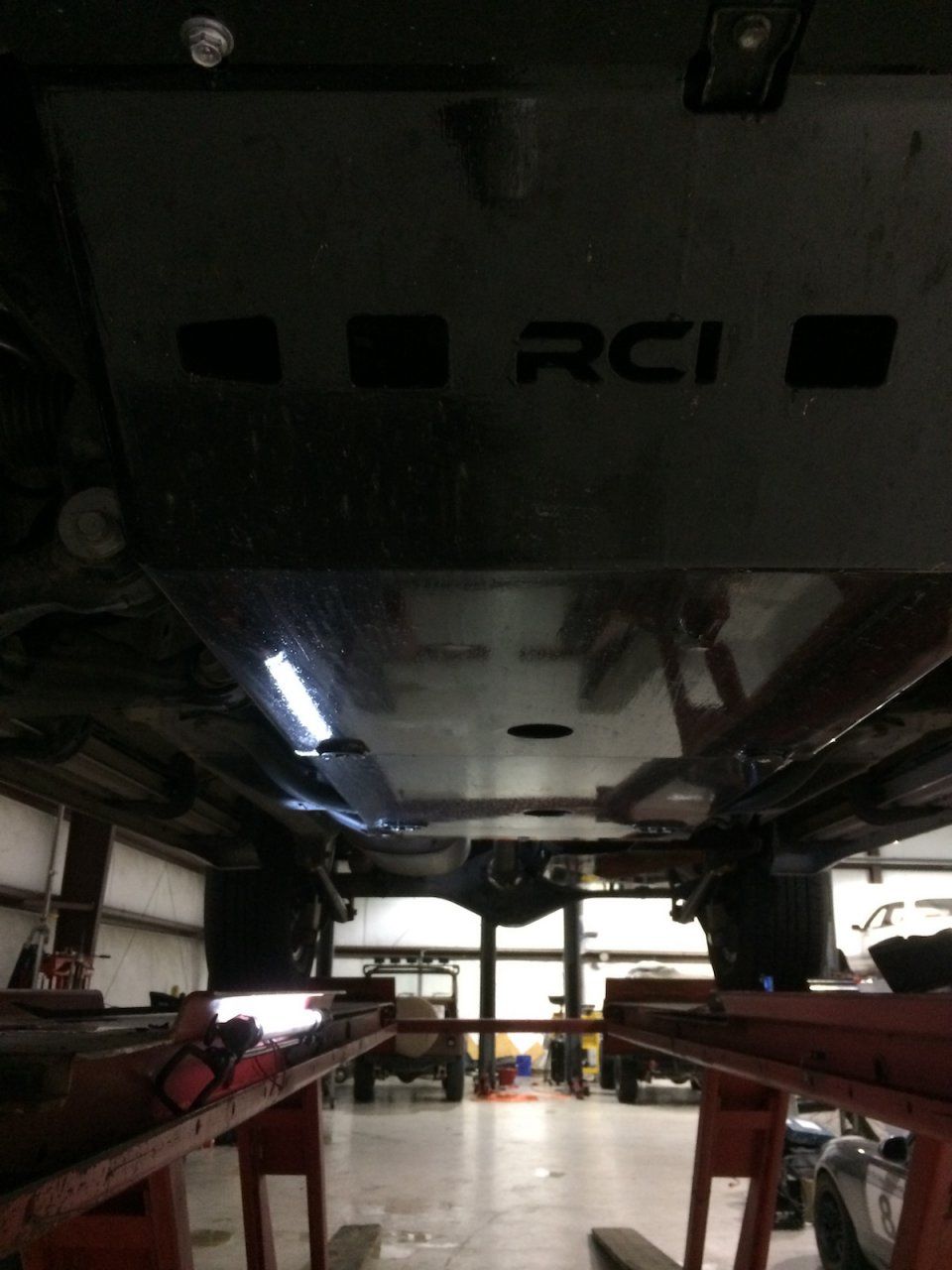

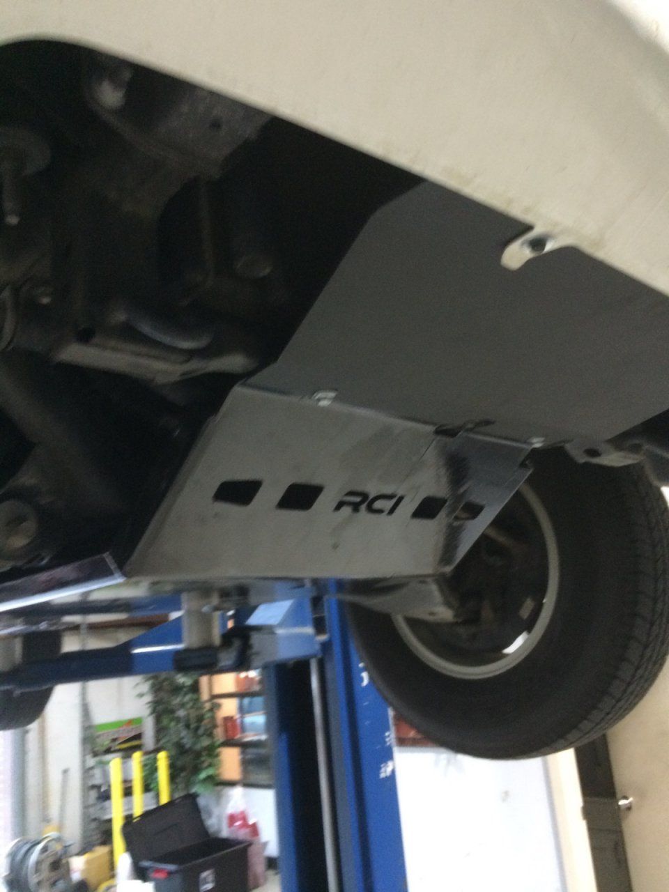

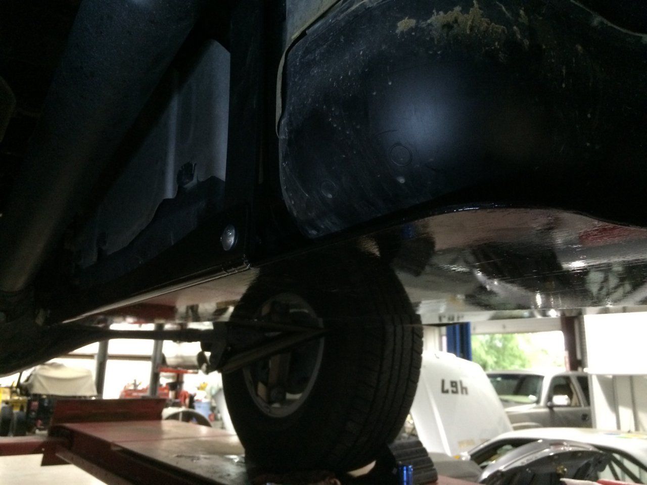

this passed weekend/week I installed RCI skid plates and Metal Tech/Radflo 3" lift.
Skids where picked up with no finish, I painted them with Por-15 paint. The install was easy and the fit was very good, I like the way they interlock with each other.
Are these RCI skid plates for 4th gen V8 4Runner? Didn't see GX470 products on their website. Thanks and nice build!
They are RCI skids and sliders for the 4Runner same gen. I have the full set and fuel tank.
Thanks
