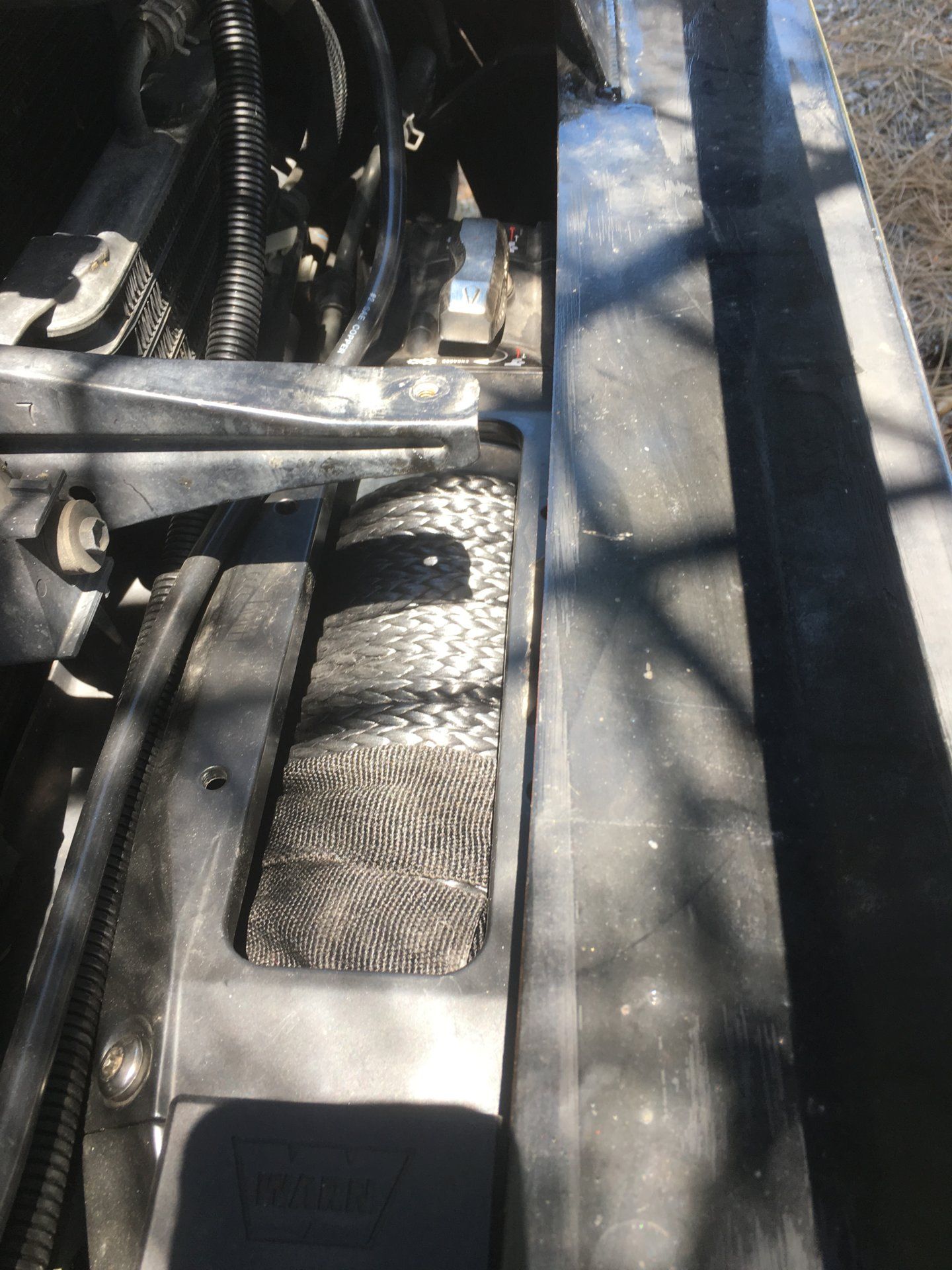

This A/C line had to be moved for the Zeon 10s winch to fit and the electric box had to be relocated, so the main body of the winch is in, but not yet working

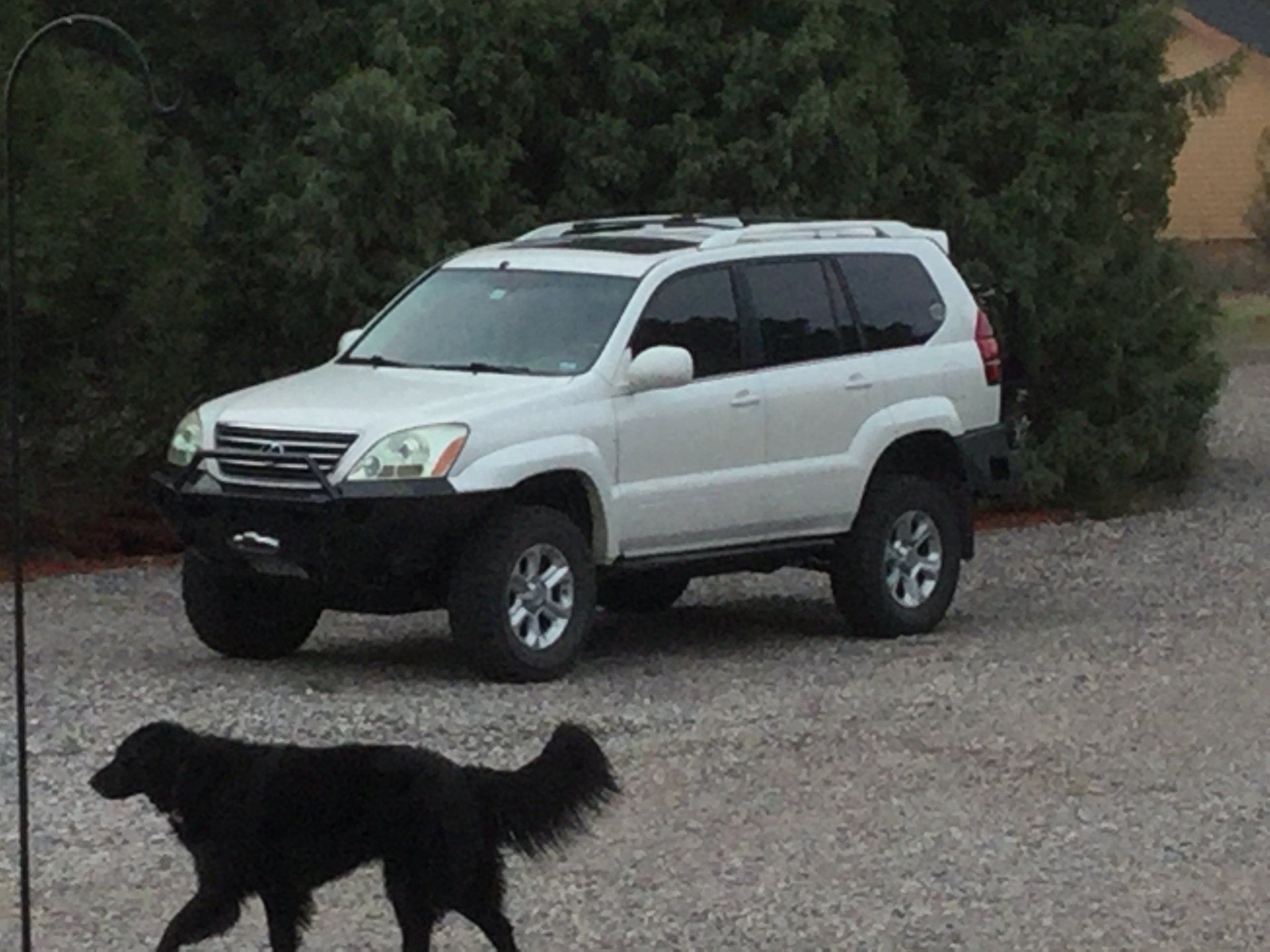

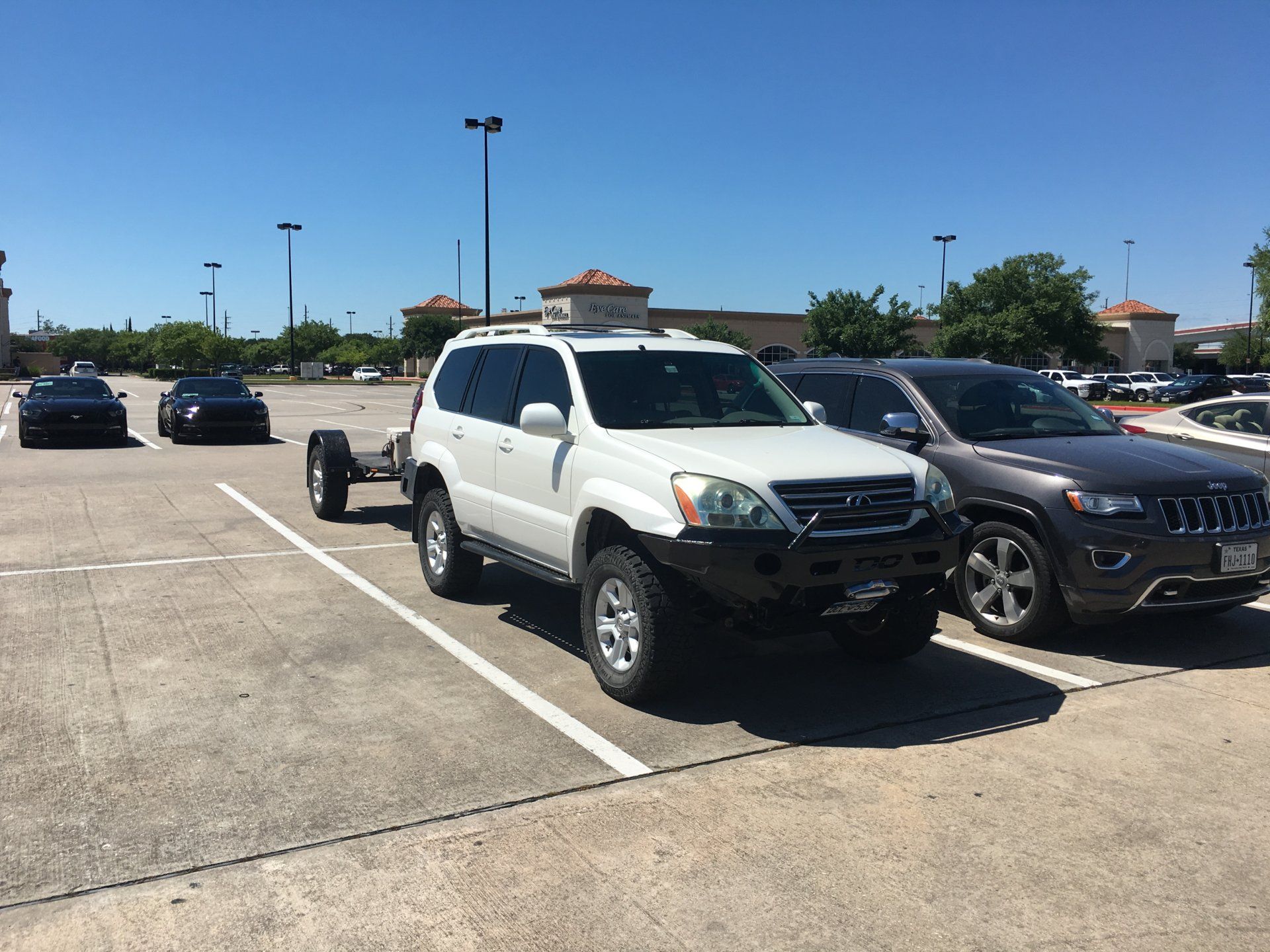

On the alignment rack
Getting ready to leave

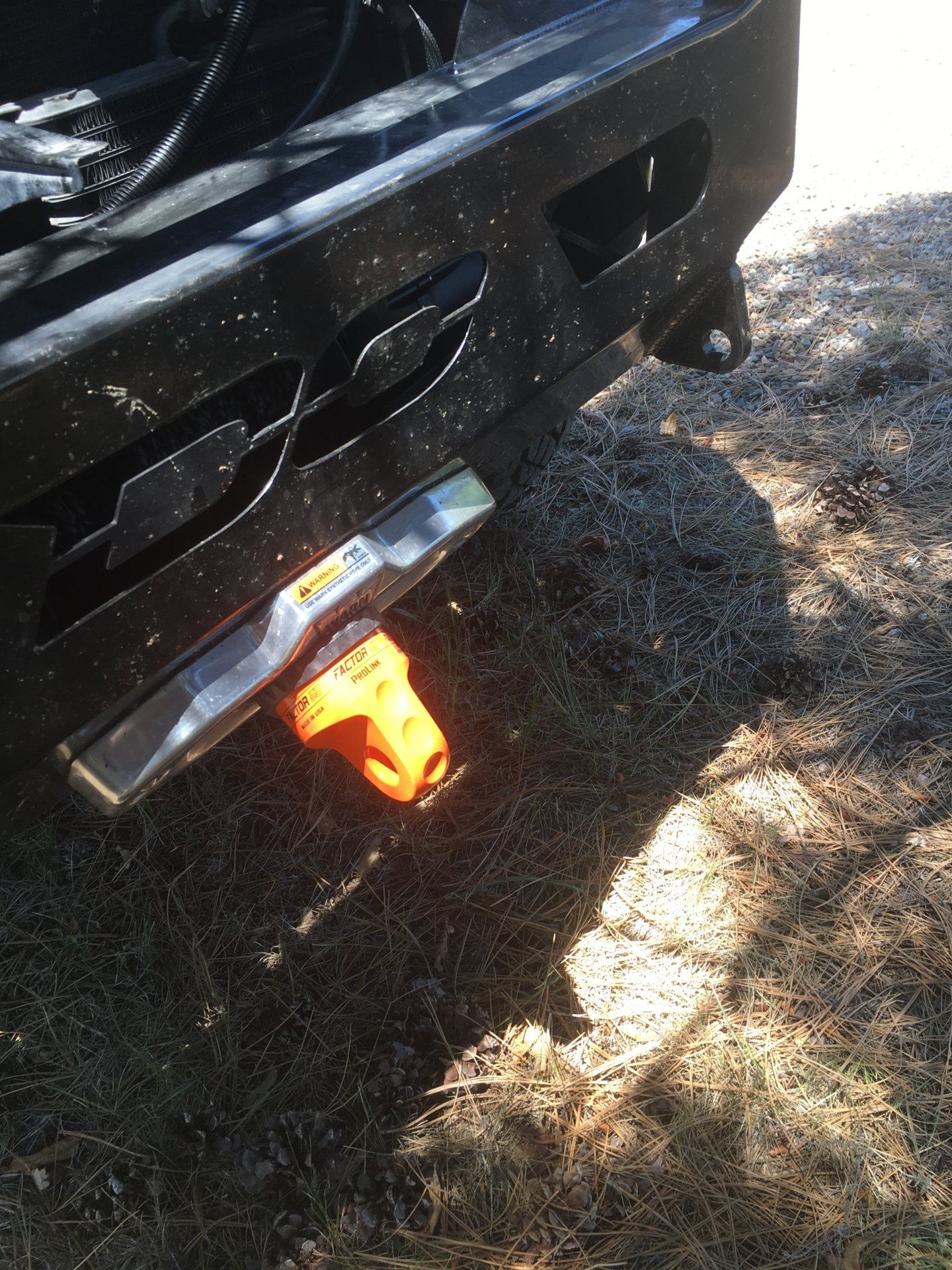

Got the new Dobinson springs on the back and adjusted the front, got an alignment done, front bumper got a cover coat of paint and the winch body is in. I have to remote mount the control box, needs a small frame made and hook up the line.

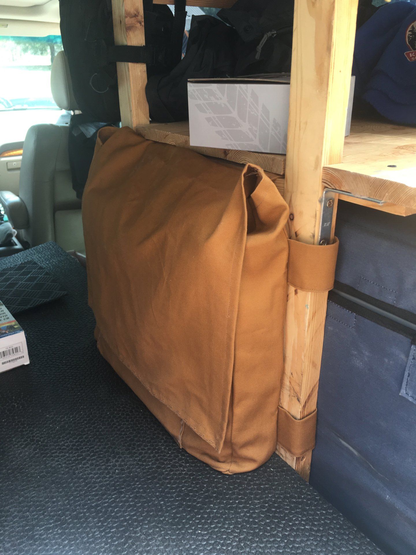

Have you posted a picture of your overall setup? Interested in your compartmentalizing, rack and donnage.
I haven't, most of it is here, but here is the build list as I can remember
I can add pictures of anything you want

Demello Off Road front bumper with home made hoop

Home build wood storage box
Home build storage area over the fridge
Home made wood trays, 1-rear door that folds against door if not in use, 2- sets on draw of storage, stores above fridge
Hope that is what you where looking for
Forum is wonky right now.
But yes and then some. i dug through the whole thread and when coupled with your concise summary you answered my question, Thanks. :cheers:

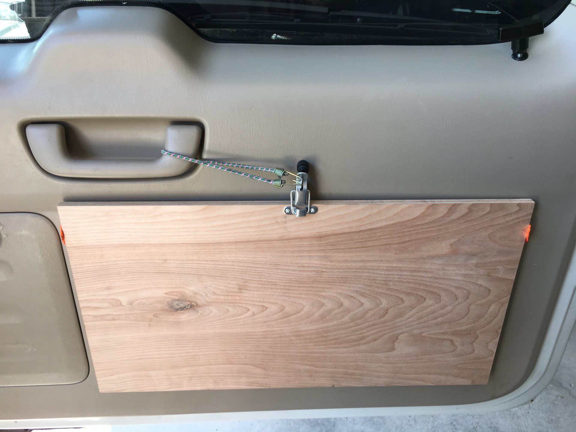

added a tailgate shelve for making food or something and a towel holder, need to get a pin to hold the latch closed
