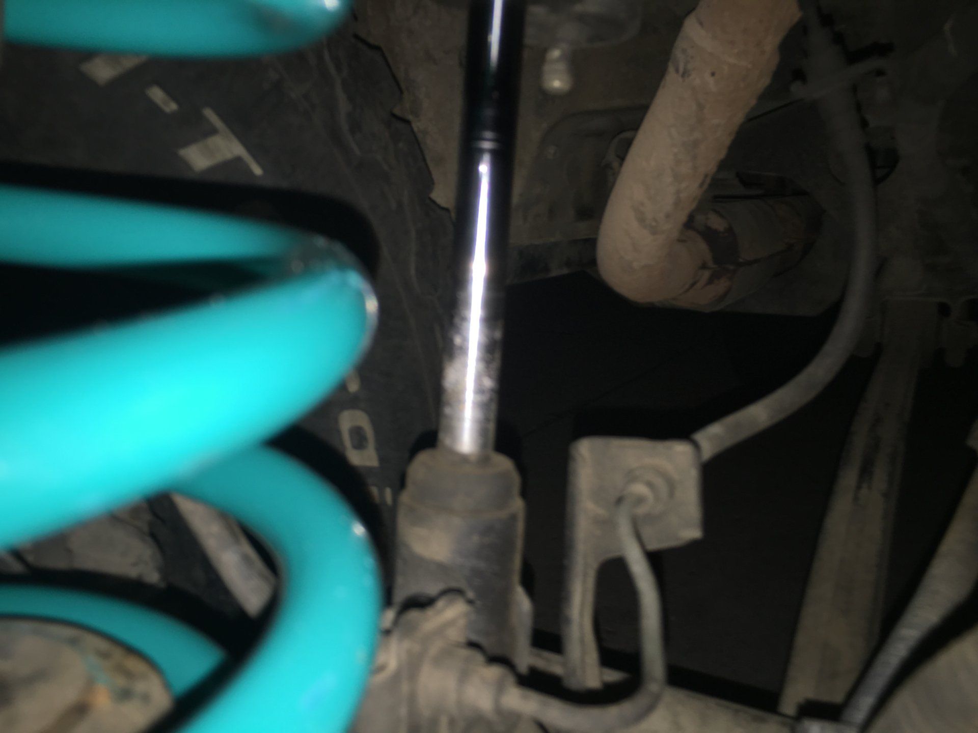

Dobinson’s front 4” Flexi installed. This coil is shorter than the rear, about 22.5” free height. Way more coil than the front can use in any case - I dropped the whole front end on both sides to the stretch point of the brakeline, leveraged out the old coil with a 4’ bar and kick method, and then used compressors again for the Flexi.
As compared to the FOR Gen II it replaces.

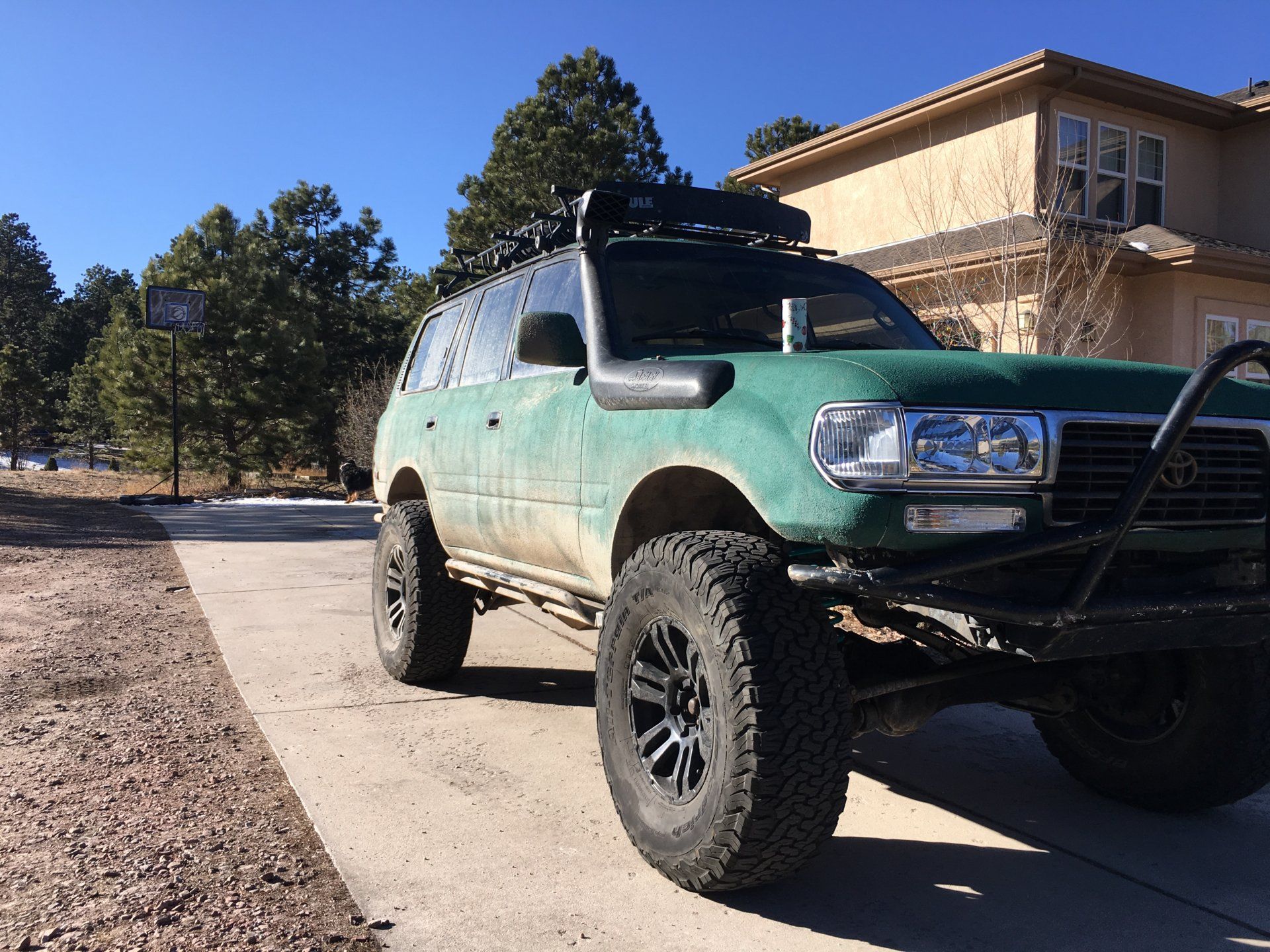

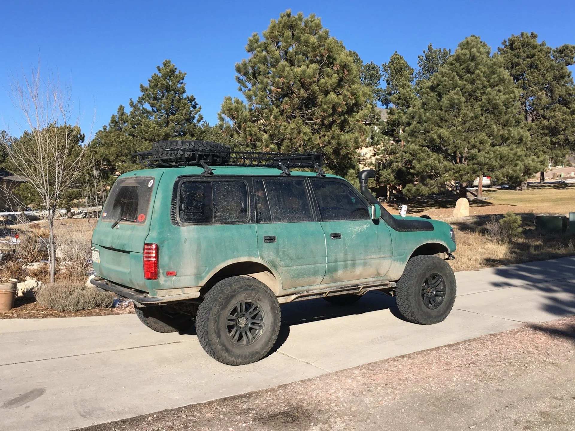

I’ve picked up about an inch of lift at all four corners. I’m right about 25.5 hub to fender (no flares), wrapped around the tire. I’ll measure more carefully tomorrow in the daylight.
Ride quality for my relatively light rig with the Fox 2.0 remote reservoir shocks is outstanding. The front feels pretty much the same outside of what I think was some coil damage from my accident - the front driver’s got torqued pretty good with frame bend and a bent radius arm and it had lost about a half inch of height.
It’s the rear that feels like it has more control - there is a lot of extra coil and it feels extremely well dialed. This seems a shift in rear coil design philosophy, more than just “longer shock”.
Definitely a clean 4-4.5” lift and seems very well thought out and executed. My 37’s are going to look a little bit small now. The coil color, OTOH, is perfect.

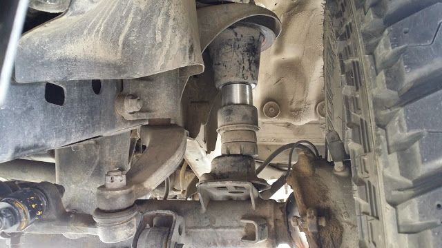

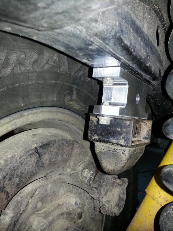

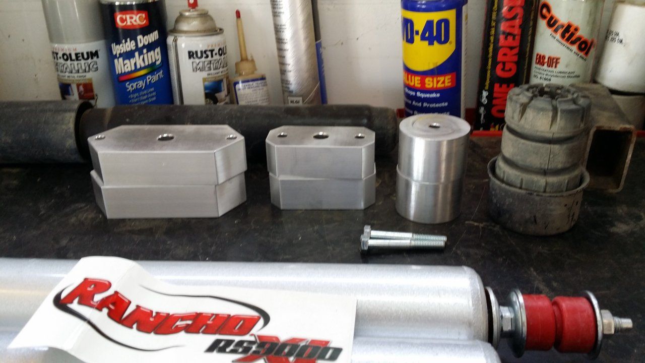

Holy bumpstop Batman!!!

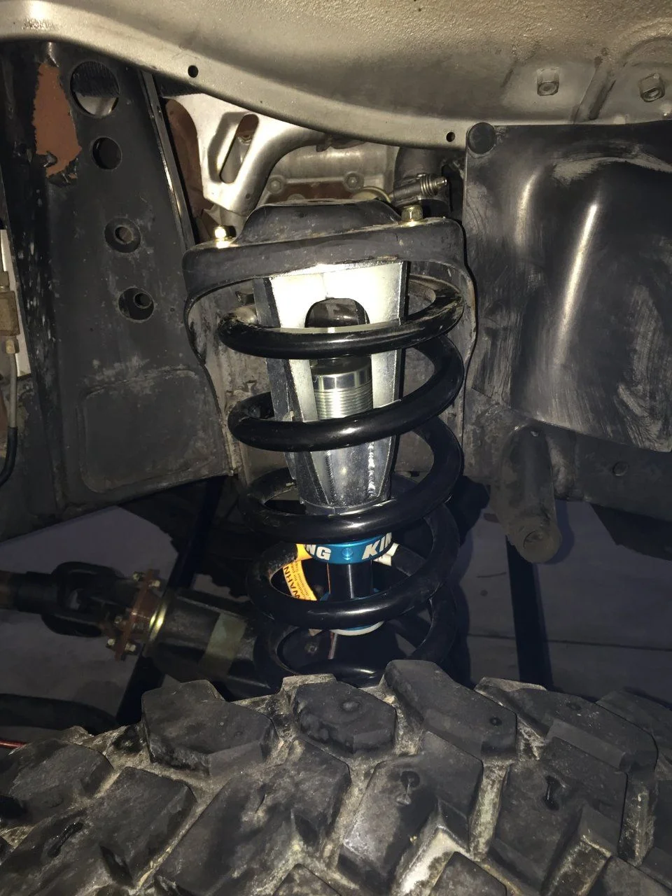

That’s a 2” extension. The front only uses 3-4” of up travel flex in side to side articulation, but a big hit at speed can easily bottom your shocks because the bumpstop can compress.
I’d always debated whether or not to use it and finally decided it made sense for high speed running. i.e. the entire front end compressing equally. I don’t debate anymore.
That 3/16” of remaining compression you see in the dirt line at the bottom of the shaft above the rubber bump bushing is what was left of shock travel hitting a curb at about ~10 mph after hitting an errant Mercedes.
We don’t expect those kind of impacts, but that’s exactly what the front end jounce system is for - if all you do is barely cover the shock body up front, a big hit will easily get past your bumpstop protection and the shock and its mounts will take the impact.
It may be slightly more of an issue for me since I run eye mount style shocks and both ends on the front need an adapter and this compresses the shock extension by about 2.5”.
Although 37’s will get up into the fenders on a uniform up travel hit where the tires aren’t angled in on articulation, so you don’t want extra up travel anyway. It simply isn’t useable unless you keep your tires smaller.

So all four corners are sitting at 5.25” hub to fender, tape measure wrapped around a 37x12.5 with a 1” wheel spacer. No weight on the front, 150 lbs or so in the cargo area.
