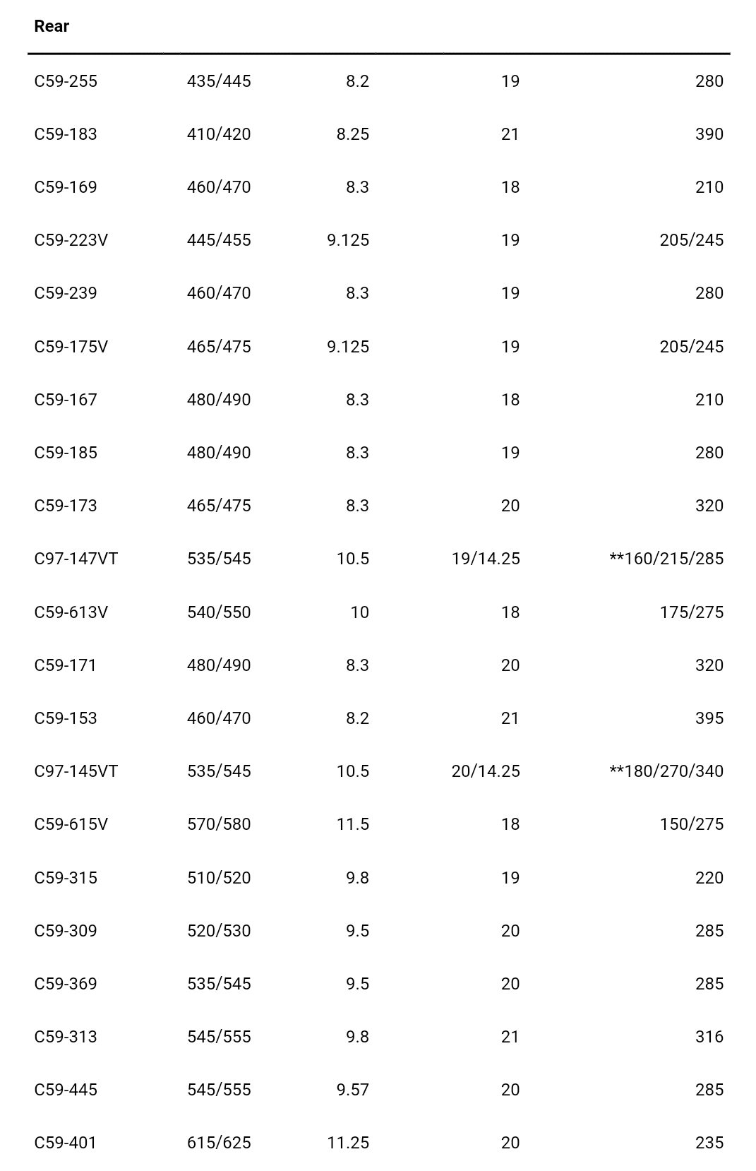

2" Tapered
2.5" front C97-146VT
2" rear C97-147VT
3" Tapered
(The 6" lift shocks suit the 3" Tapered lift.)
3.5" front C97-144VT
3" rear C97-145VT
2" Flexi
2" front C59-222V
2" rear C59-223V
3" Flexi
(The 3" or 4" lift shocks suit the 3" Flexi lift.)
Front C59-612V
Rear C59-613V
4" Flexi
(The 4" or 6" lift shocks suit the 4" Flexi lift.)
Front C59-614V
Rear C59-615V

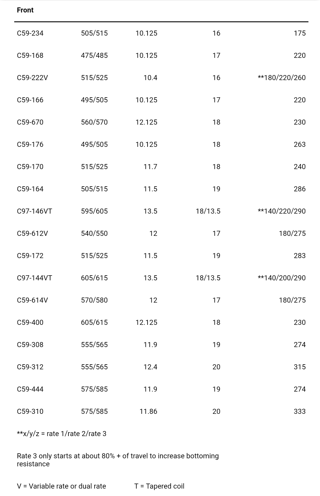

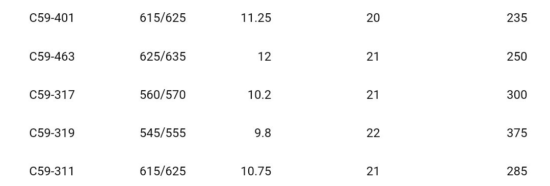

@David Otero has been working behind the scenes to get the specs on the Dobinson coils... Thanks David.
David wrote:
"Hey Mate, after much talking to Australia they provided the specs".
View attachment 1591424 View attachment 1591425 View attachment 1591426
Has anyone noticed the tapered coils are triple rate?
@David Otero for the win ! Looks like myself and everyone else won't be crying about the mystery spring rates anymore. Guess we will have to find something else to focus on.

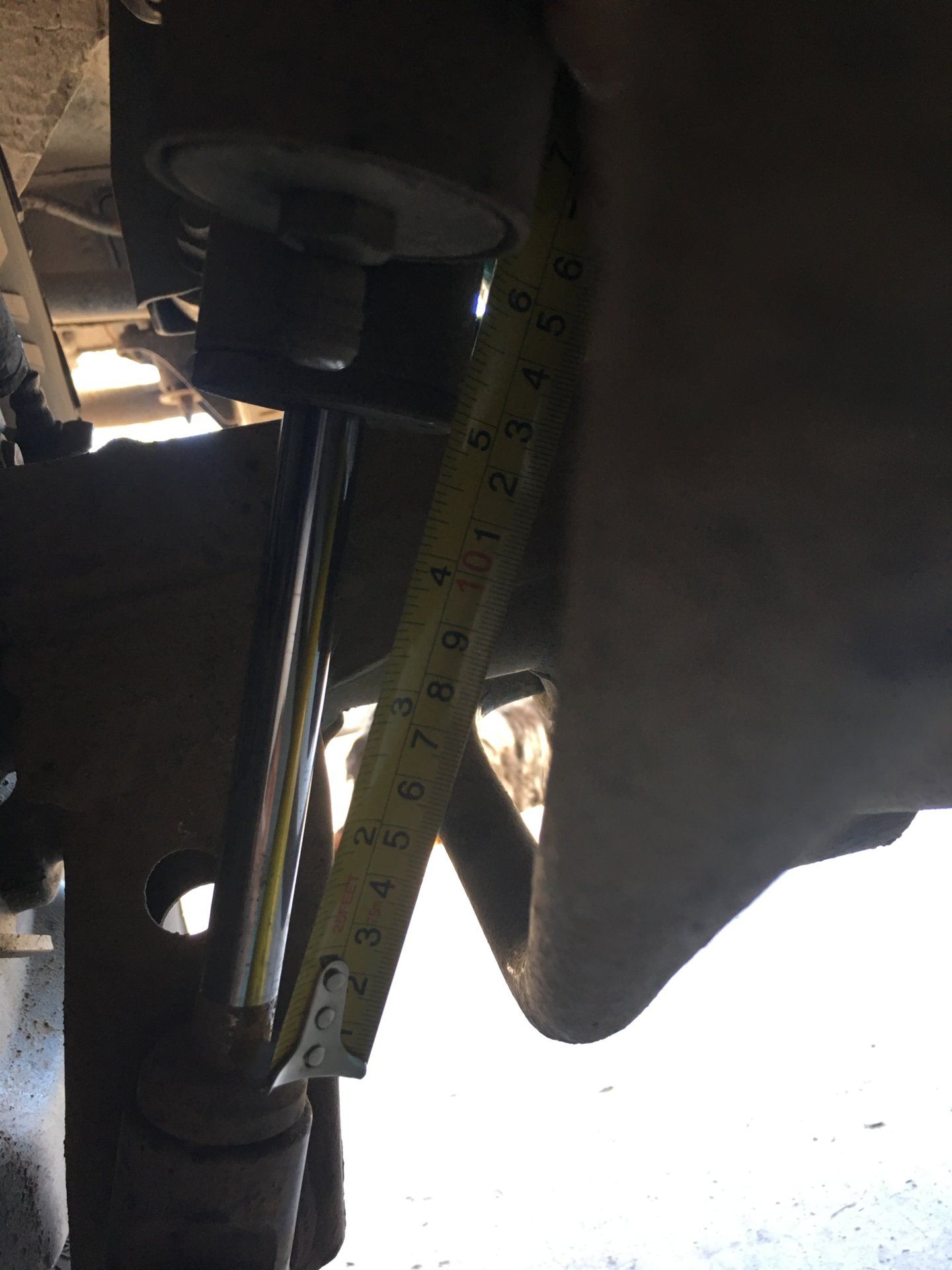

You’ll need about 1.5” bumpstop drop to barely protect a 17” compressed shock length in the rear. There’s no magic.
This is 2” drop for 17.25. You can see how much travel is left. How much you believe a rubber stop can compress on a hard hit in terms of how much extra you want...up to you. I’d say you could get away with 1.5” for the rear 6” shock.

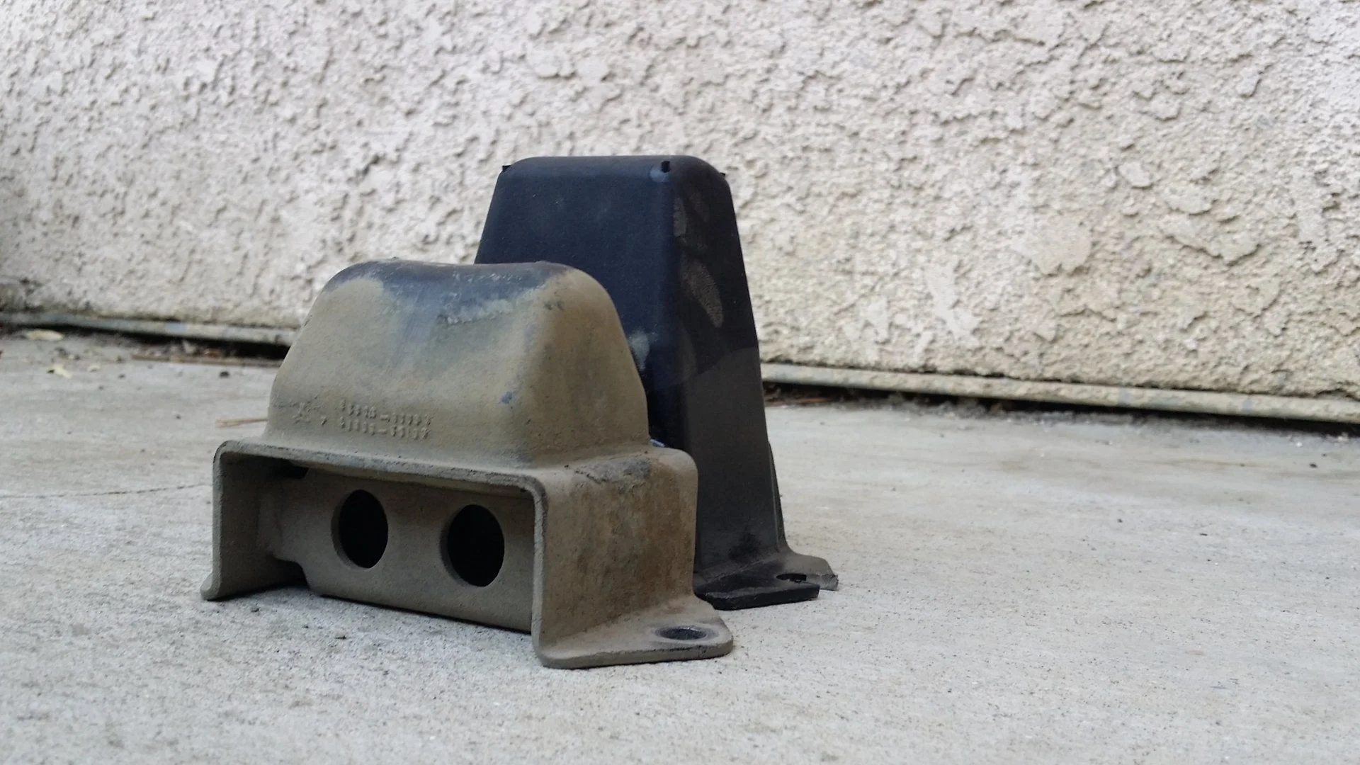

@Lumpskie ask what the difference was in the stock rear bumps vs the ones in the Slinky kit... they are just a bit over 1" taller.
Here is a couple pics of the rear bump stops stock vs. the ones Slinky has in the kit.

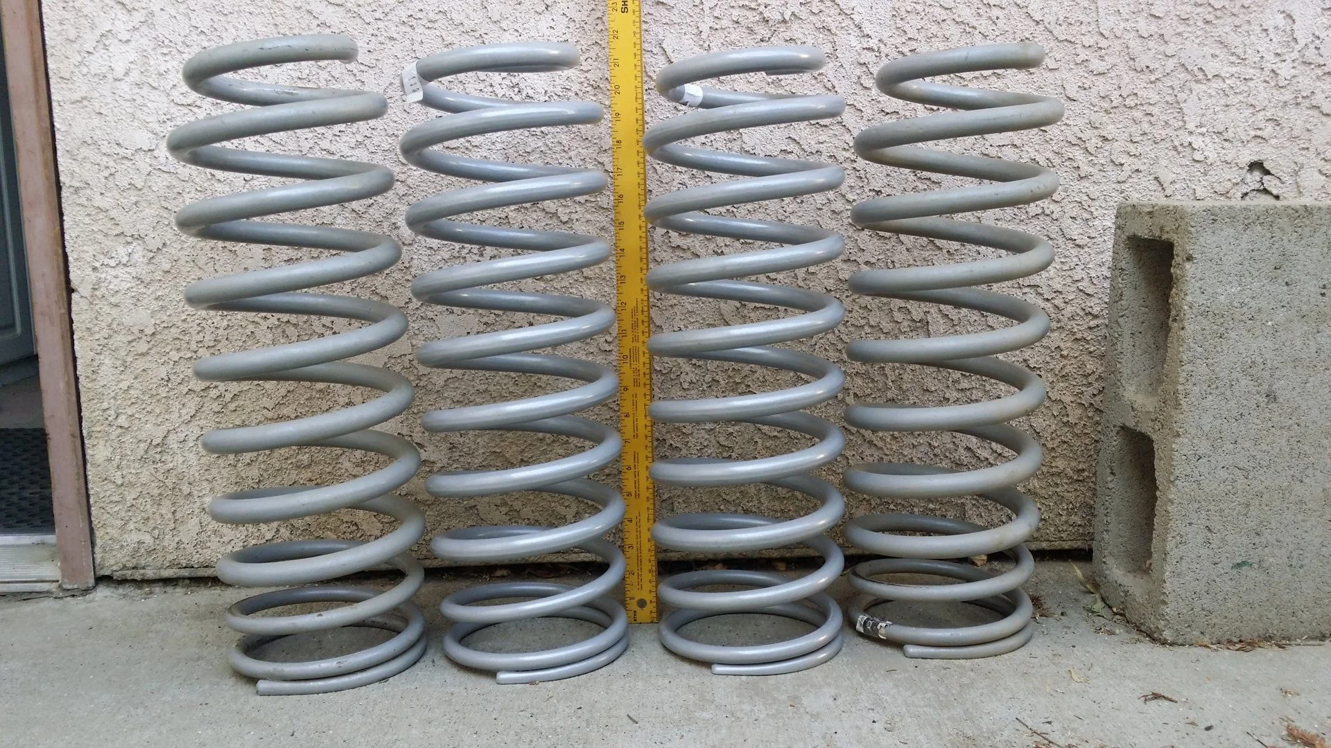

7501 75mm Intermediate 10.5 turns~18mm~160/270#
7511 75mm Heavy Duty 10.5 turns~19mm~160/320#
75mm Slinky 7948 fronts 600/615mm~13.5 turns~160/260#

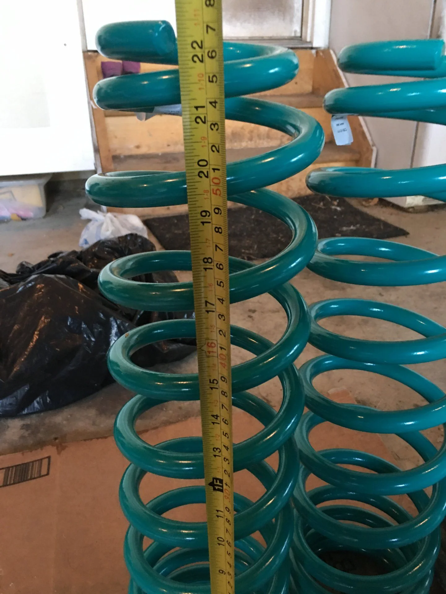

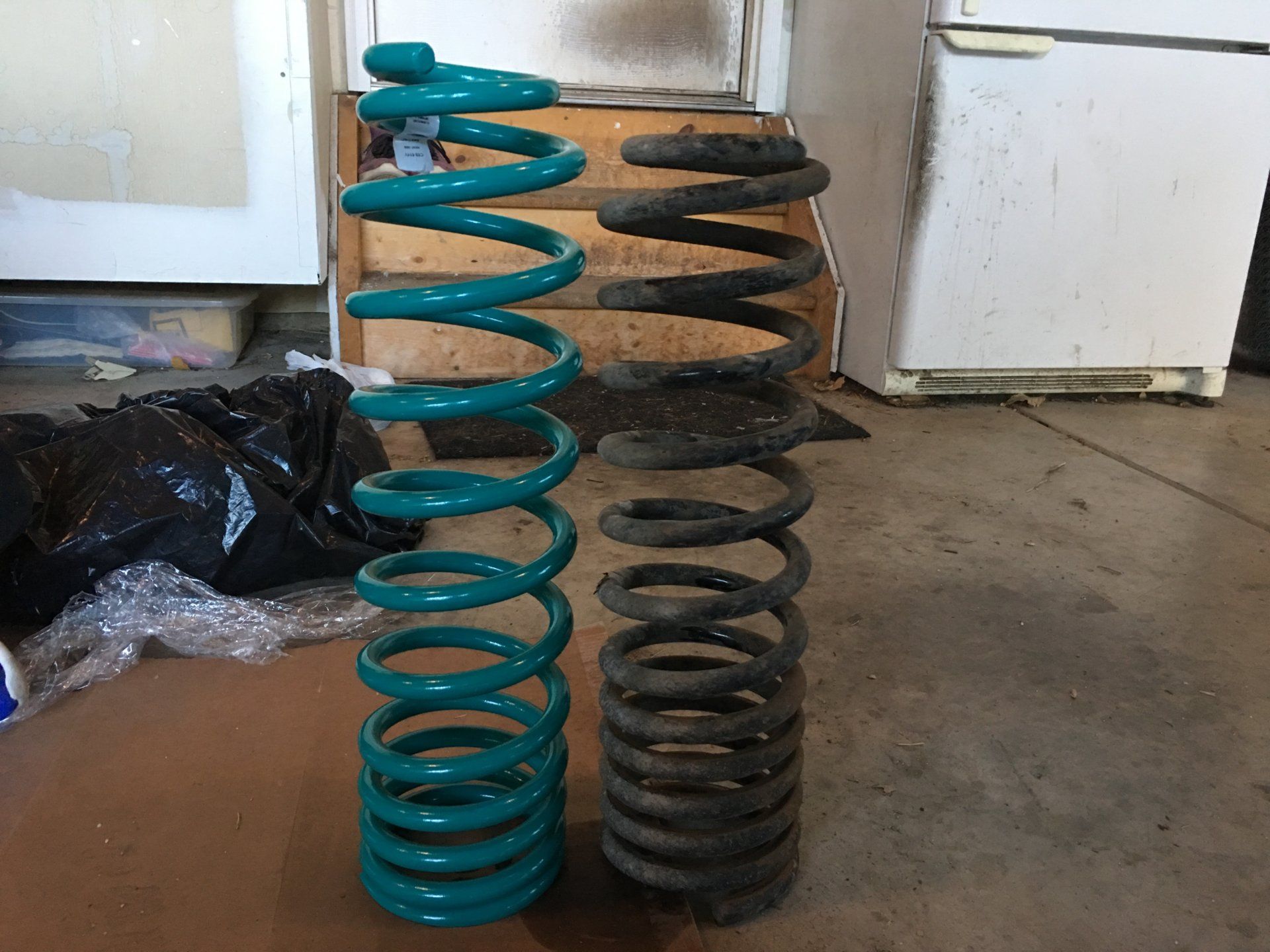

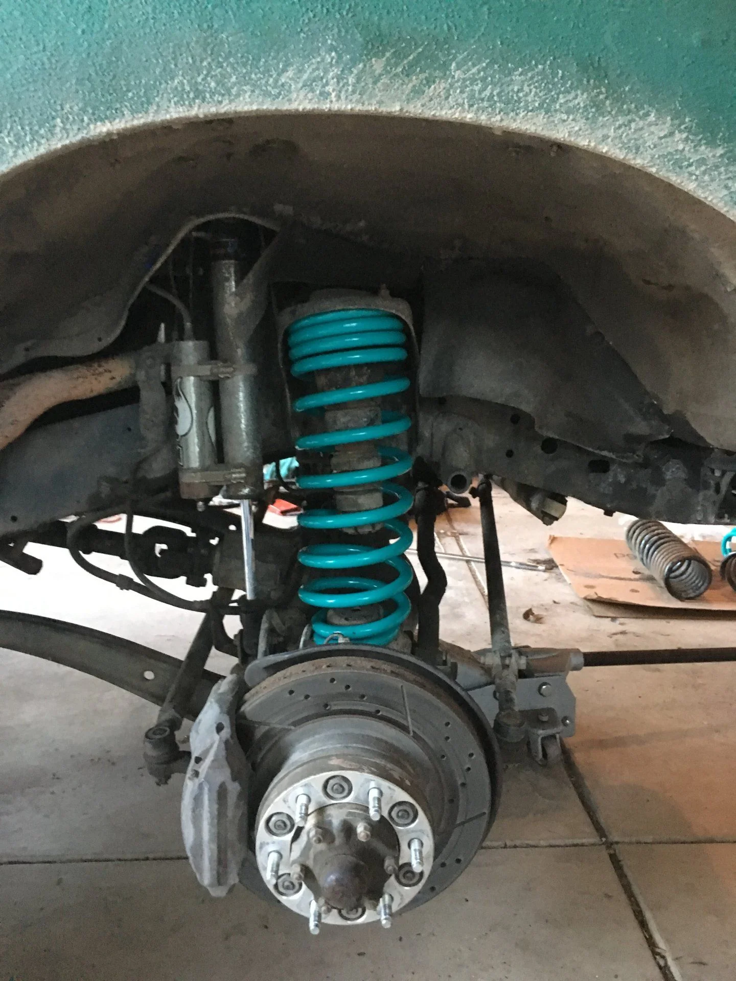

Dobinson’s front 4” Flexi installed. This coil is shorter than the rear, about 22.5” free height. Way more coil than the front can use in any case - I dropped the whole front end on both sides to the stretch point of the brakeline, leveraged out the old coil with a 4’ bar and kick method, and then used compressors again for the Flexi.
As compared to the FOR Gen II it replaces.
I’ve picked up about an inch of lift at all four corners. I’m right about 25.5 hub to fender (no flares), wrapped around the tire. I’ll measure more carefully tomorrow in the daylight.
Ride quality for my relatively light rig with the Fox 2.0 remote reservoir shocks is outstanding. The front feels pretty much the same outside of what I think was some coil damage from my accident - the front driver’s got torqued pretty good with frame bend and a bent radius arm and it had lost about a half inch of height.
It’s the rear that feels like it has more control - there is a lot of extra coil and it feels extremely well dialed. This seems a shift in rear coil design philosophy, more than just “longer shock”.
Definitely a clean 4-4.5” lift and seems very well thought out and executed. My 37’s are going to look a little bit small now. The coil color, OTOH, is perfect.
