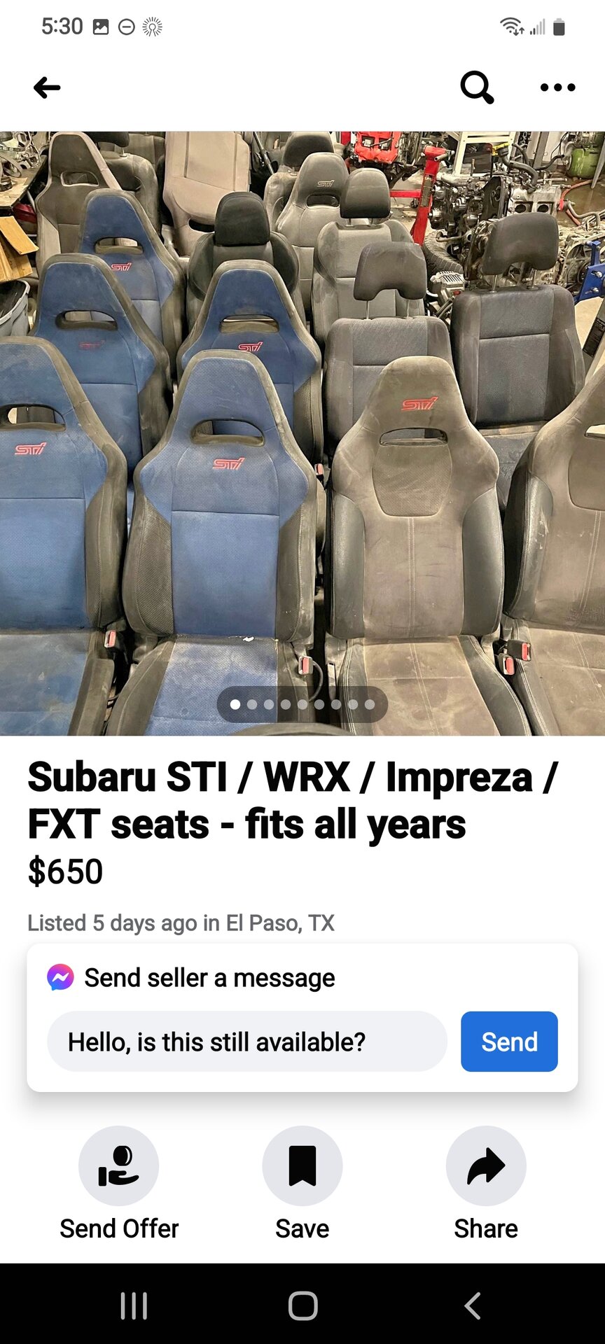

This outfit seem to have a lots of Subaru seats if that's what you're looking for, in El Paso, TX.
I recently sat in the Subaru seats you have posted via another MUD member I met up with...and for a bigger dude, those seats are horrible, fyi. The side and seat edge "hump" are very uncomfortable.

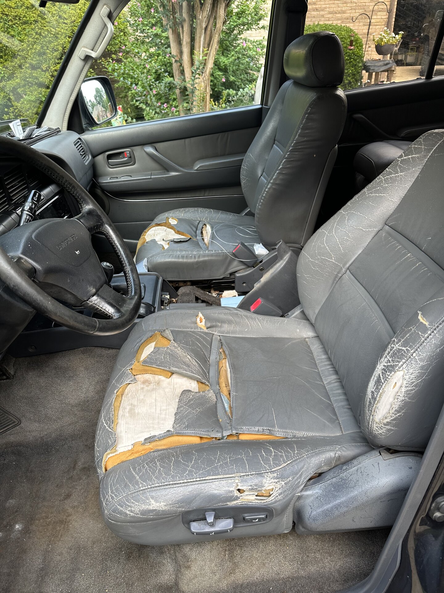

So I guess it’s time to do something (ha).
I’d like to simply yank these and install OEM manual seats. All I need is the frame (and maybe the foam). I have a good upholsterer that can do the rest. Local junkyard searches no good, all power (and rough).

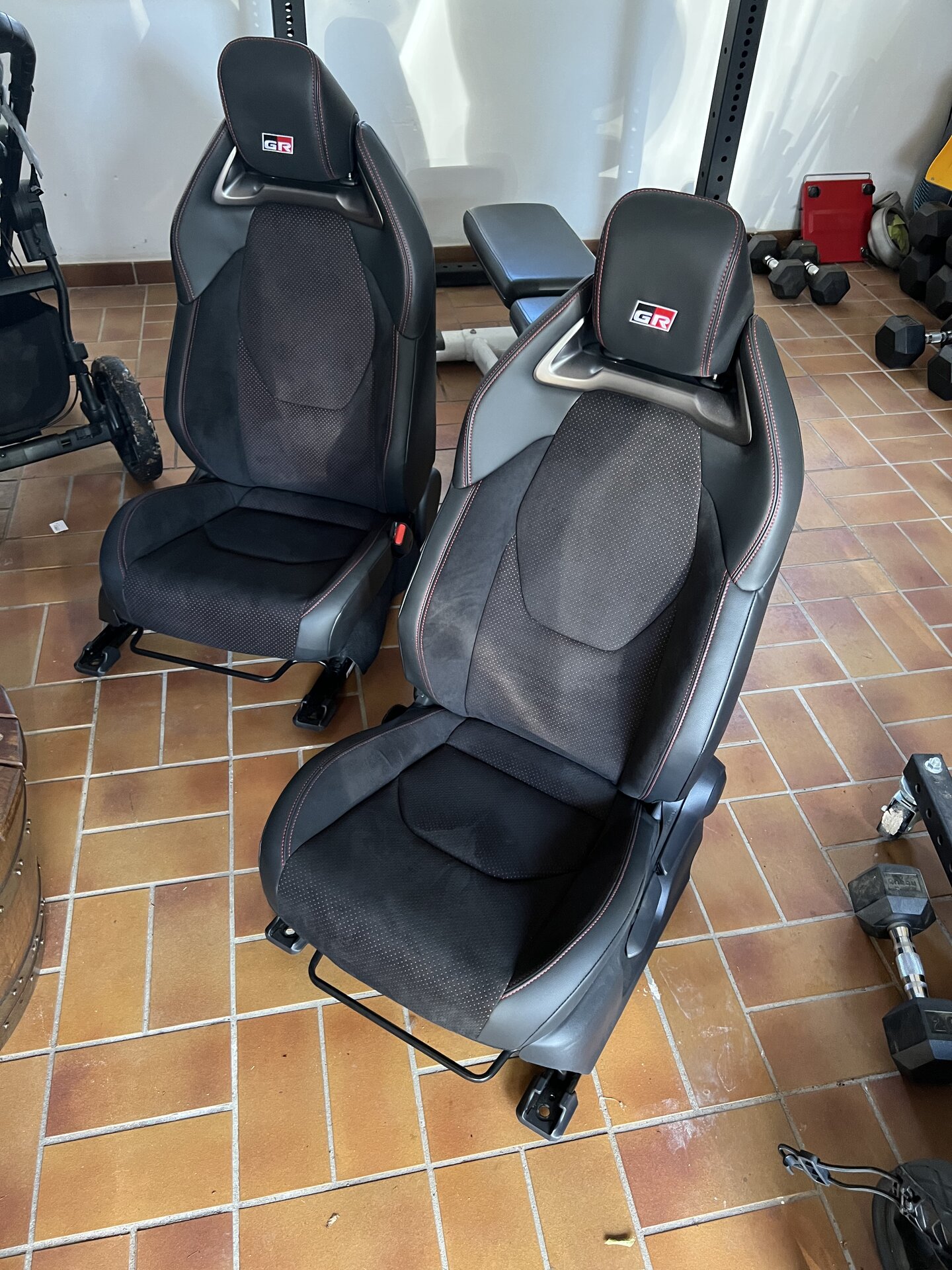

Coming soon, 2021 GR Yaris seats. picked them up local yesterday and ordered my planted brackets today. they sit a little high, so i’m making some custom brackets to lower it a couple inches. the seat rails are also a little wide for my liking, so the brackets basically move the rails inwards and tuck them up into the seat a little bit. gonna be a few weeks on the making because mail takes a little to get here. they have factory heaters also, just need to get the wiring diagram to make it all work. they are pretty comfy, and have enough bolstering to keep you planted, but not enough that it’s annoying to get in and out of.
Those are nice looking seats!
Since we don't get the GR Yaris here in the US I'm going to have to keep my eyes open for some GR Carolla seats. Those are good looking seats.

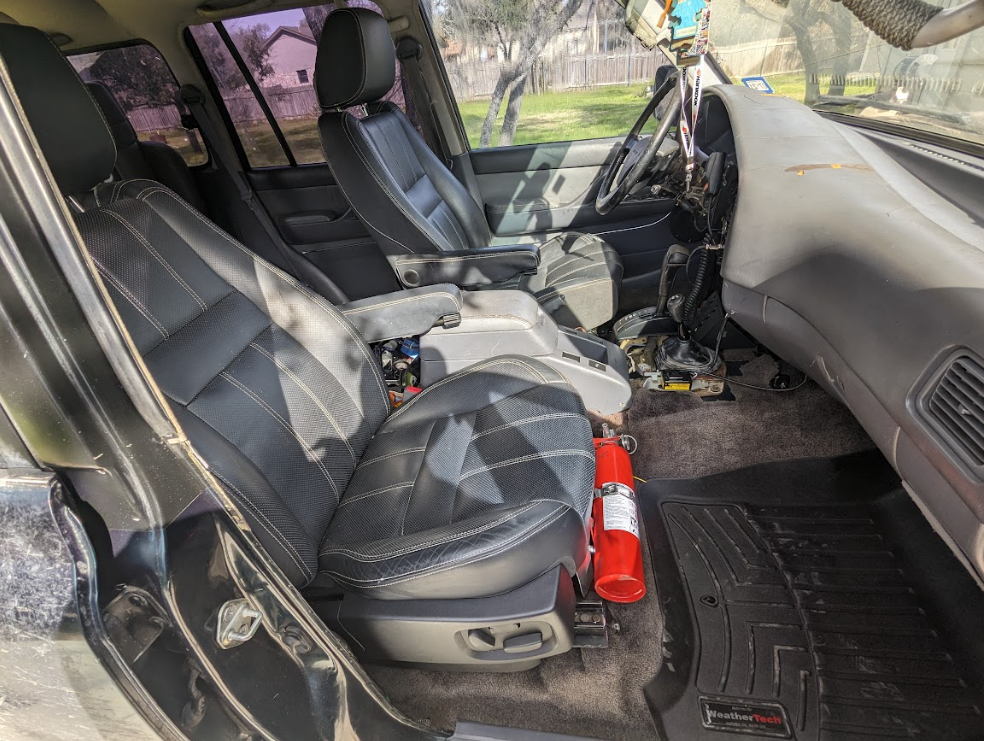

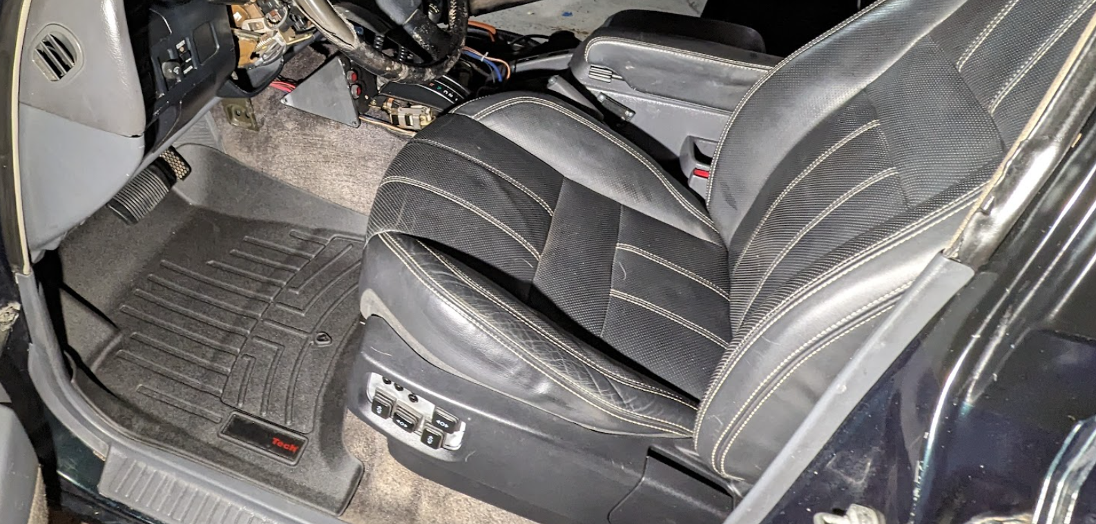

2012 Range Rover Sport HSE (L320) seats.
Tons of adjustability, and heated. Both seats have lumbar and driver seat has bolster as well.
I am 6 ft tall for reference, pant length 32.
EDIT:
This is a link to a Google Drive folder which contains a PDF outline which contains the wiring diagrams I drew up to adapt the RR seats to the 80, as well as any other important info. You'll also find a complete spread of process photos, as well as a PDF to the 2012 Range Rover Sport factory wiring manual.
I'm absolutely in love with these seats. I do have to have them at the minimum height setting. They'd be great for short people, haha. My head clears the ceiling on both sides about 2-3 inches.
Also, the passenger arm rest does clear the center console (by a small amount).

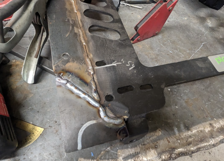

I know a few people have tried these to no avail. I had to modify my Planted seat brackets with extra material in the front and towards the center of the vehicle, and also cut into the trans tunnel to make these fit right. I'm OCD about properly centered seats.
My driver seat is a memory seat. It has a module that communicates on the CAN Bus which it expects a bunch of other communication to other modules to work. I tried to make it work within reason, but it likely requires the instrument cluster and body control module. More than I was willing to install. I rewired it to generic DPDT switches, and the lumbar/bolster to momentary buttons. Eventually I'll replace the aluminum panel I made with a 3D printed bezel, and also try to 3D print switch covers that look more OEM.
The passenger seat was super easy to wire, as it was just a matter of applying power and ground.
Here's how I had to modify my seat brackets (they were previously modified when I installed Mazda2 seats)

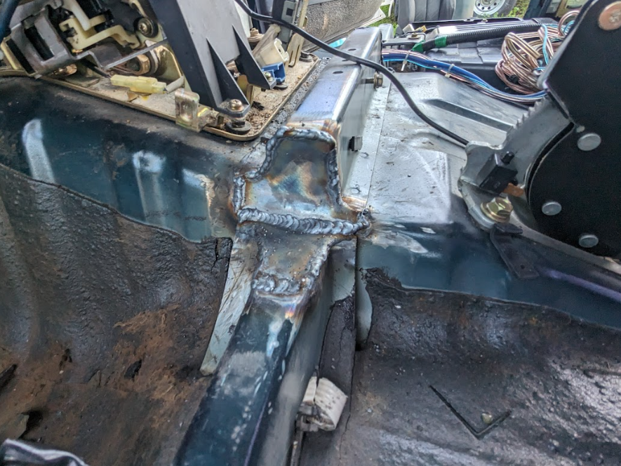

And the trans tunnel:
The factory Rover rails have studs up front which I pressed out and used button head bolts in place of. On the outer front tab of the bracket, the hole barely clears the mounting tab of the bracket.
I documented this process really well, and also created easy-to-follow wiring schematics. I'm working on creating a full in-depth write-up on installation that will also include a PDF to the full Range Rover wiring manual (if anyone wants it) and all the steps I took. I spent a good few days sifting through wiring diagrams, so no one will have to go through that headache like I did, haha.
I'll link the write-up on this post once I have it completed.
View attachment 3533123View attachment 3533124
