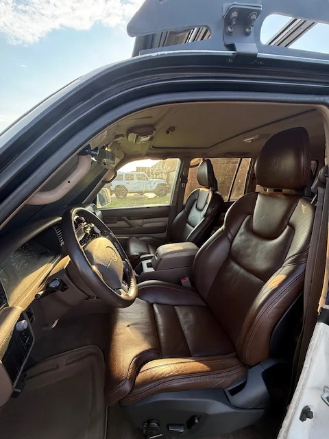

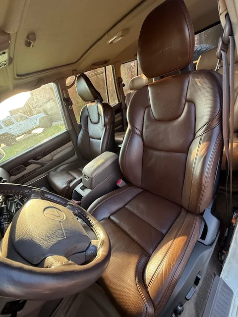

Thought I would throw mine in here. Thanks to all for the inspiration. These are 2018 Volvo S90 Inscription trim seats. Heated, ventilated, leg extension, lumbar, etc, etc. Not sure I would recommend them due to amount of crap to make them work, but they are gorgeous and comfy. I loved them and made them work. They require a Volvo CAN bus signal to wake them up, then the onboard ECU's do the rest. Still working out the heat and ventilation functions, as well as the bolsters, etc. Used the planted brackets and added steel plates to extend them since the base of the Volvo seat is wider and longer.
