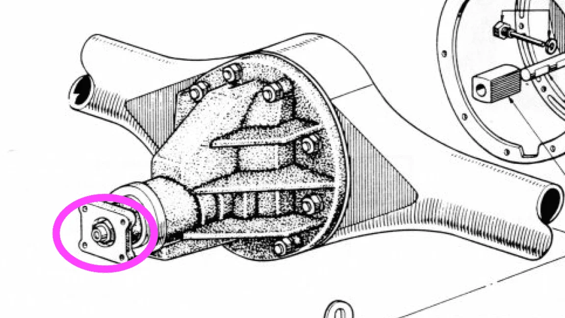

As mentioned, I know very little about rear diffs. I took the rear cover off. Where is the pinion nut located? I see the center pin and it seems to have some play, not sure if that is normal. I dont see any teeth ,missing on the gears, no ground metal in the bottom.
Pinion yoke is what the drive shaft bolts to, and the pinion nut is what holds the yoke onto the differential input shaft (or whatever that’s caled). If you have a loose pinion nut the yoke will wobble up/down/around rather than just spin on axis.
Thanks, I will check that. I dont have any play there though.
