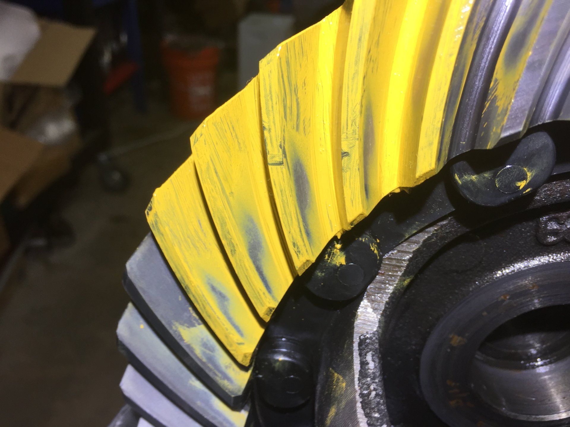

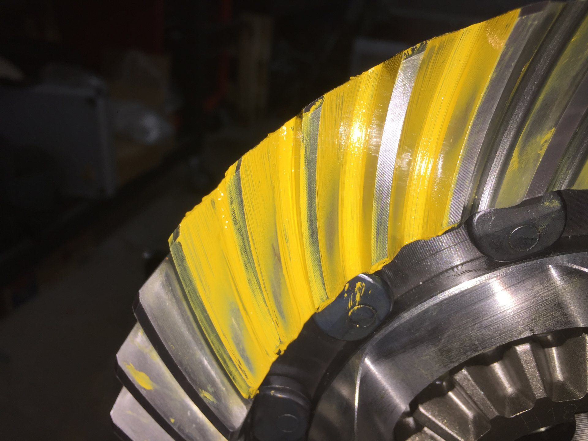

Looks like the pinion is just a bit to far into the differential. But it's a game of thousandths at this point.
Just a tip - when you want to check your pattern, rotate the pinion and drag the ring gear with your palm or something to put some load on it . Doing that will help define the pattern a lot better so it doesn't drag the paste across the teeth so far - it will give a much clearer imprint of the actual tooth contact pattern.
From the looks of the pattern, I'd say reduce the shim slightly. Some seem to respond faster than others - every gear set is always ground slightly different , it's just the way they are.

Understood. I thought I was dragging it enough but I'll try harder next time.

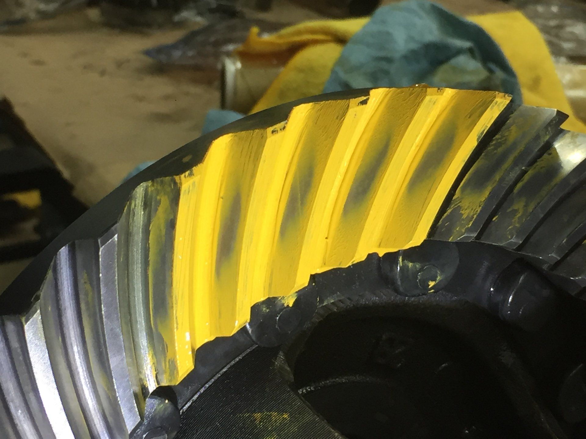

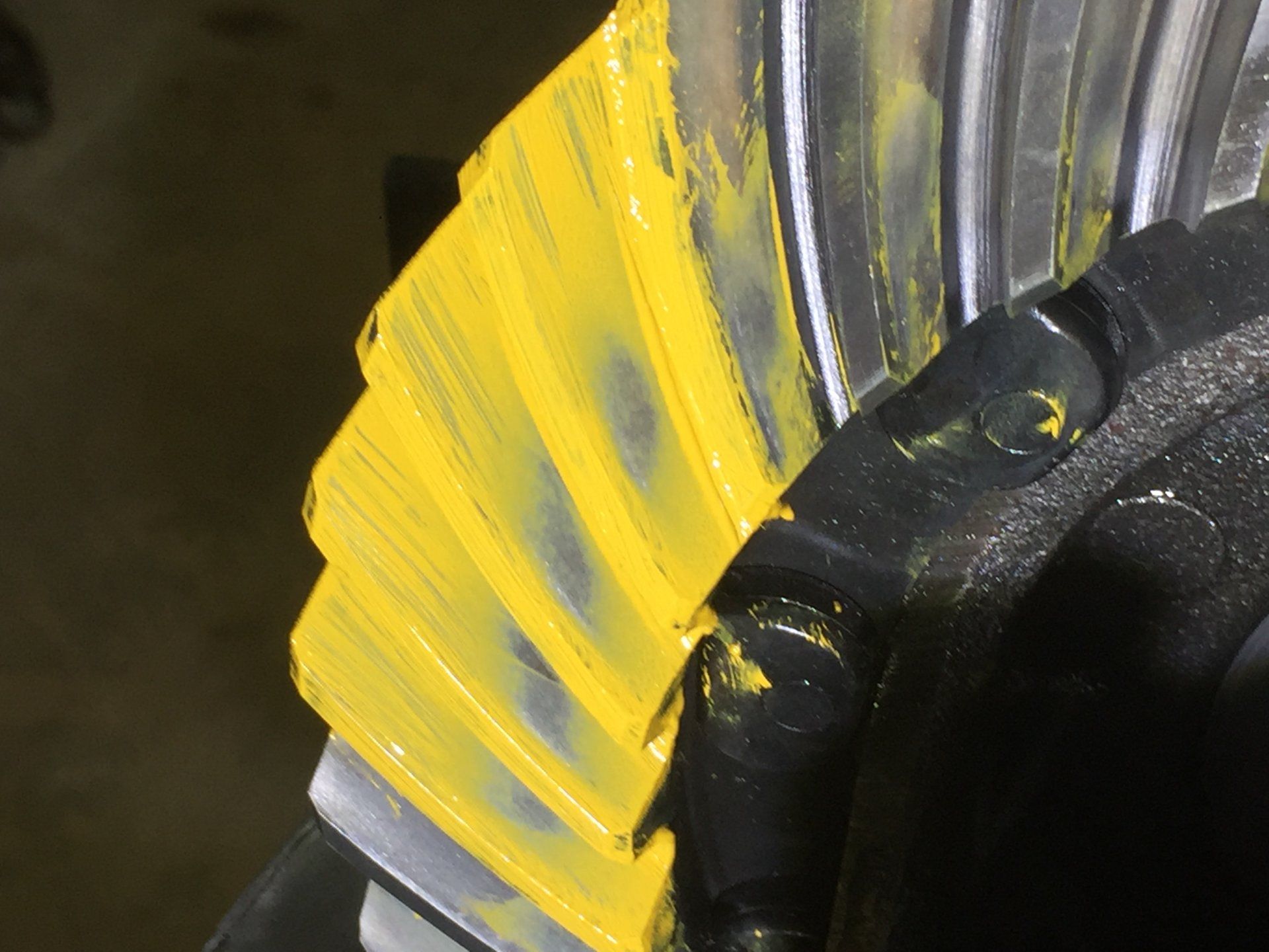

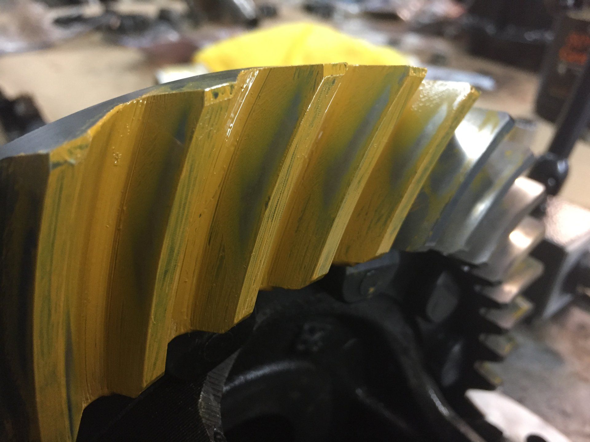

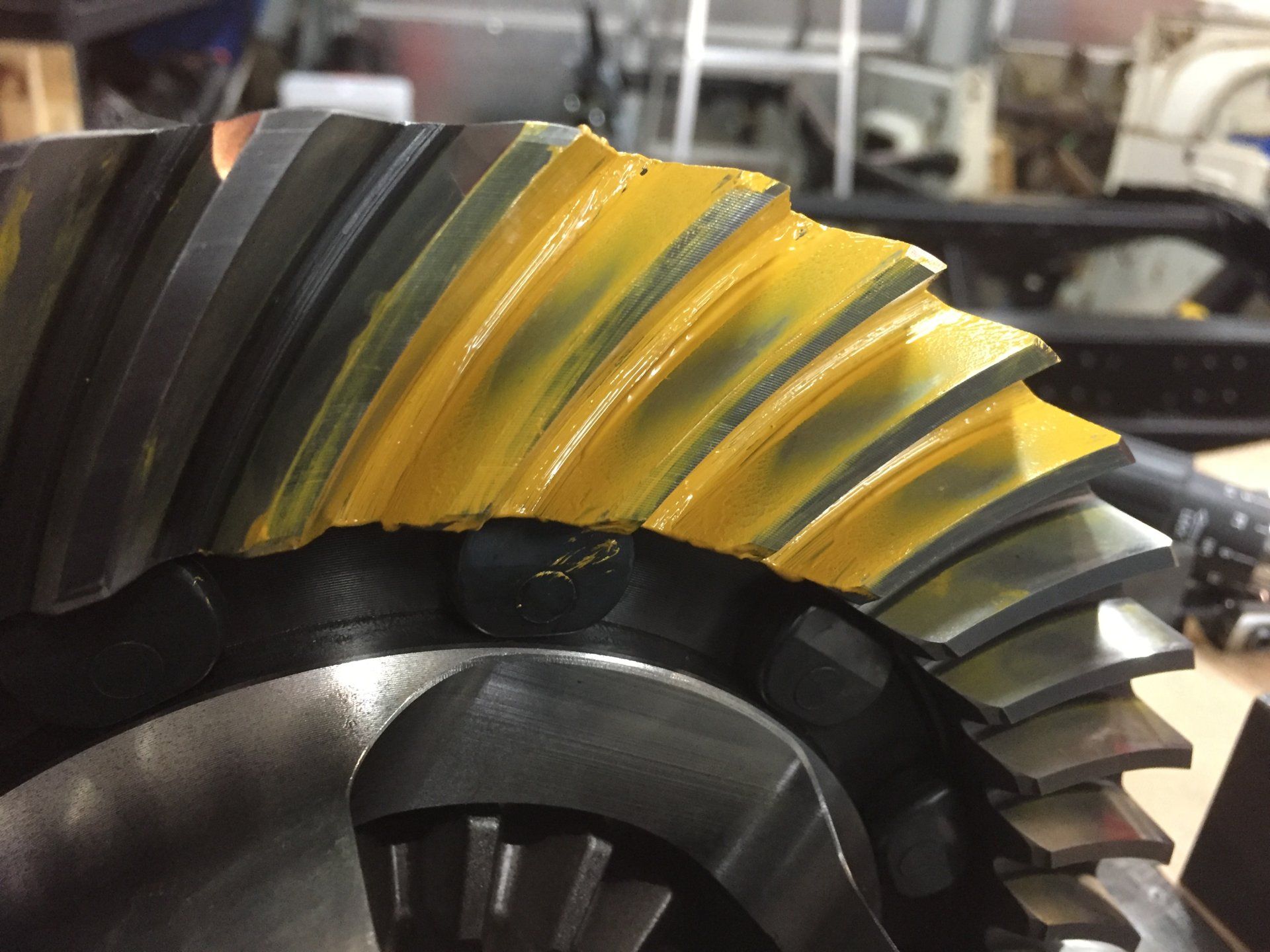

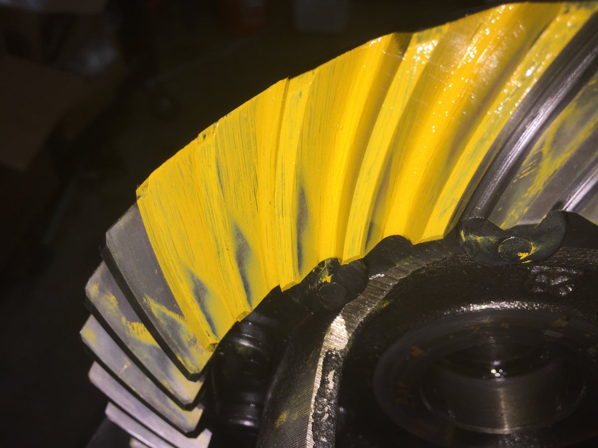

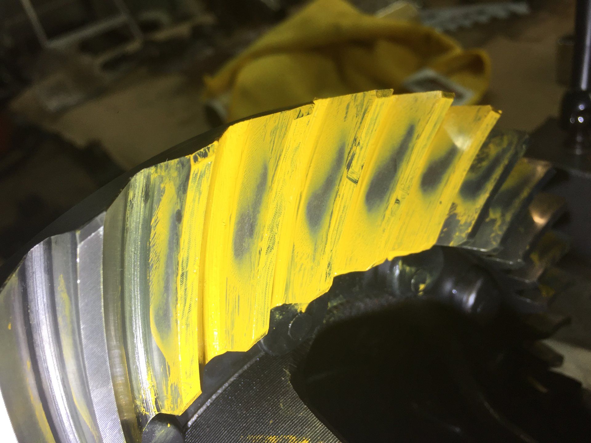

Update: I went from .35mm down to .10 in .005mm increments on my depth shim. I took pics each time. I seem to have a better pattern at the starting amount of .35mm. I then went up to .40 just to see what happened. Check out the earlier posts for .35mm pics.
The pics below are all at .008” backlash with carrier bearings adjusted properly.
Notice that with more shimming the inner part of the coast is actually closer to the middle of the tooth.
Here’s .10mm:
Here it’s moved up to .40mm of depth shim: Based on my limited experience I think this is an acceptable pattern for a used ring and pinion.
Cool, last pattern looks very close, good enough to run for sure.

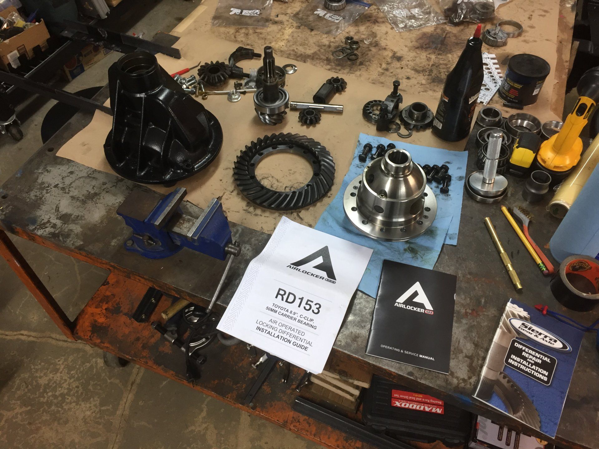

I'm now finished with the ARB setup, save the final installation into the axle.
It's setup much like a normal differential with the exception of a few additional steps required to plumb for the seal housing.

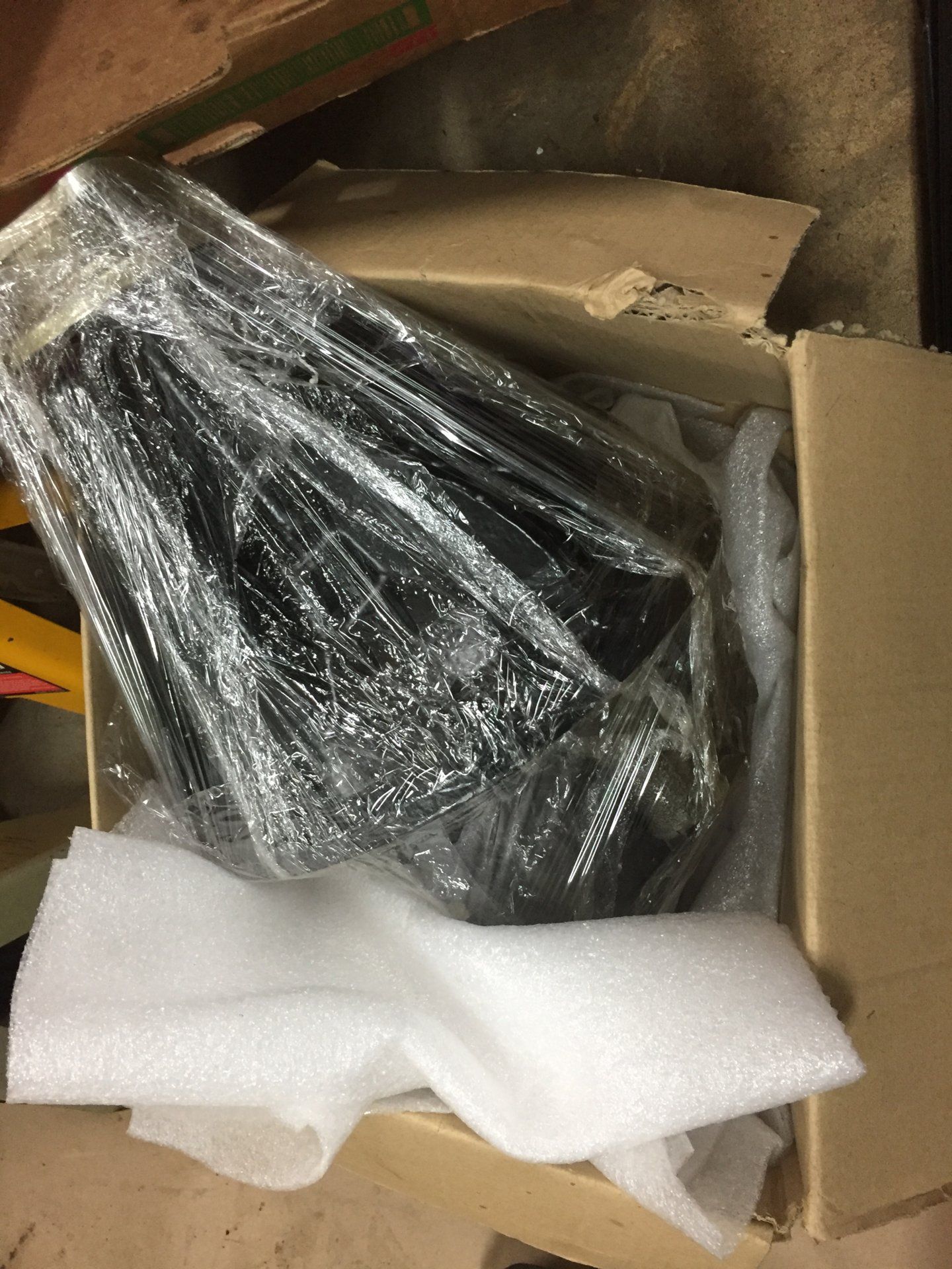

I then unwrapped the seal housing to check it out prior to install. It comes in a Cosmoline impregnated paper. Looked a bit crusty? I spoke with Kurt @cruiseroutfit and he says the discoloring from the cosmoline was a bit more than usual but regardless they always clean them out, and are sure to blow compressed air through the tube. I did the same.

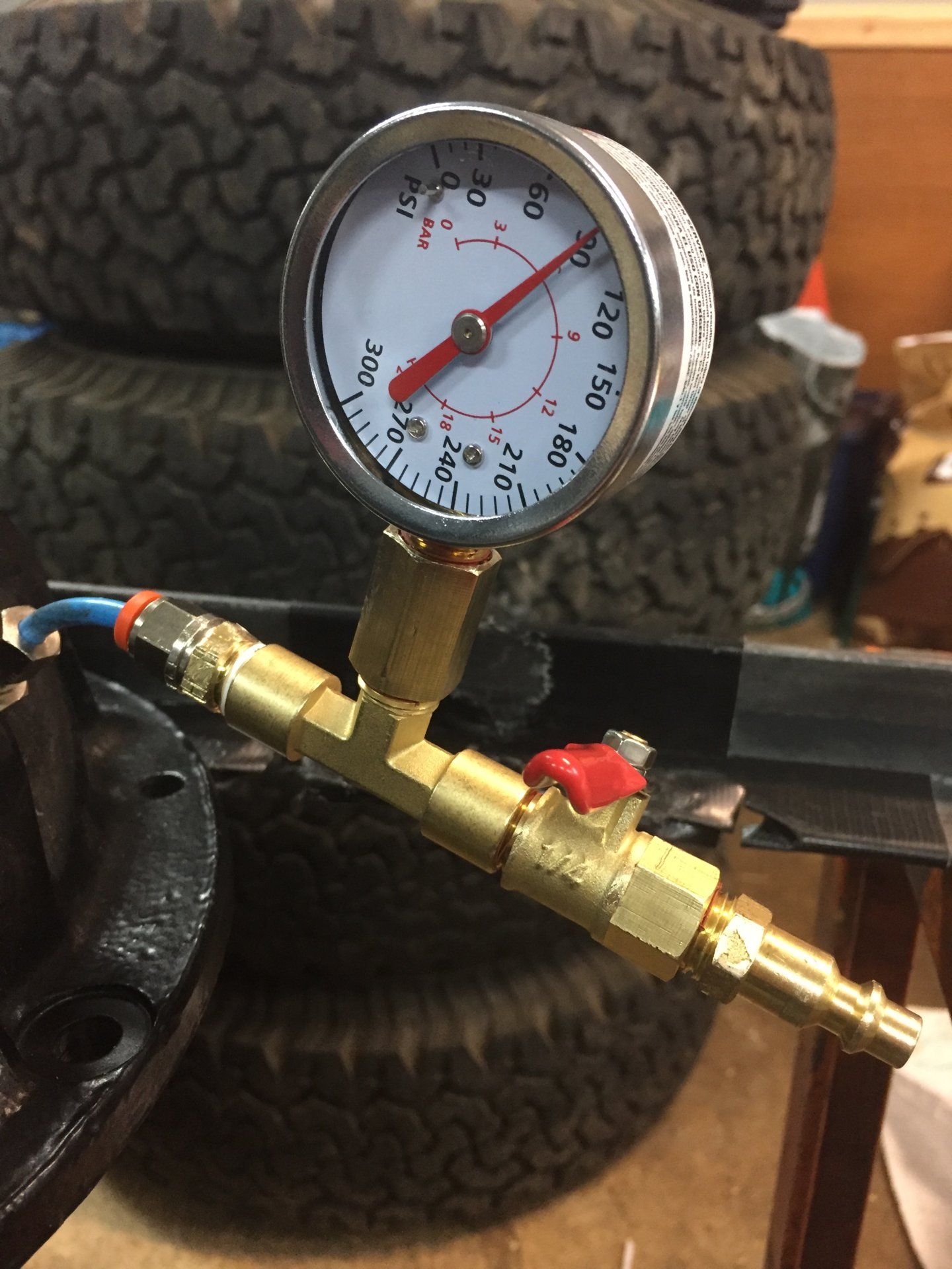

I then finished by installing the seal housing and routing the tube through the hole in the bulkhead. I then installed the bulkhead parts as per the instructions, and pressure tested the locker.

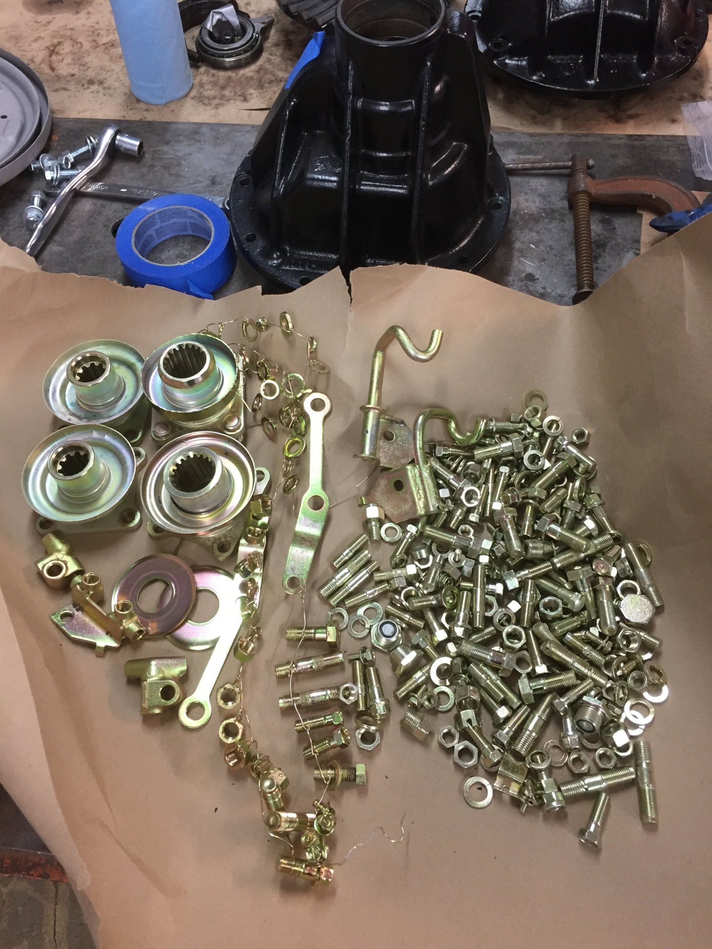

What plating did you have done? Is that zinc?
Everyone calls it "cad plating" but nowadays it's a zinc base layer with a sacrificial gold chromate top coat.
Commercial Electroplating - Production Zinc, Nickel, and Tin Plating Services - Fresno, California treated me well. It seems they run this type of stuff through during lags in their main business. Took about 2/3 weeks to ship it off and get it back. Very happy with them. If you call, talk to Steve. While they do clean and dip the items before plating my suggestion is to also clean and brush larger particles and globs of stuff off before sending. The cleaner they are the cleaner they come back.
