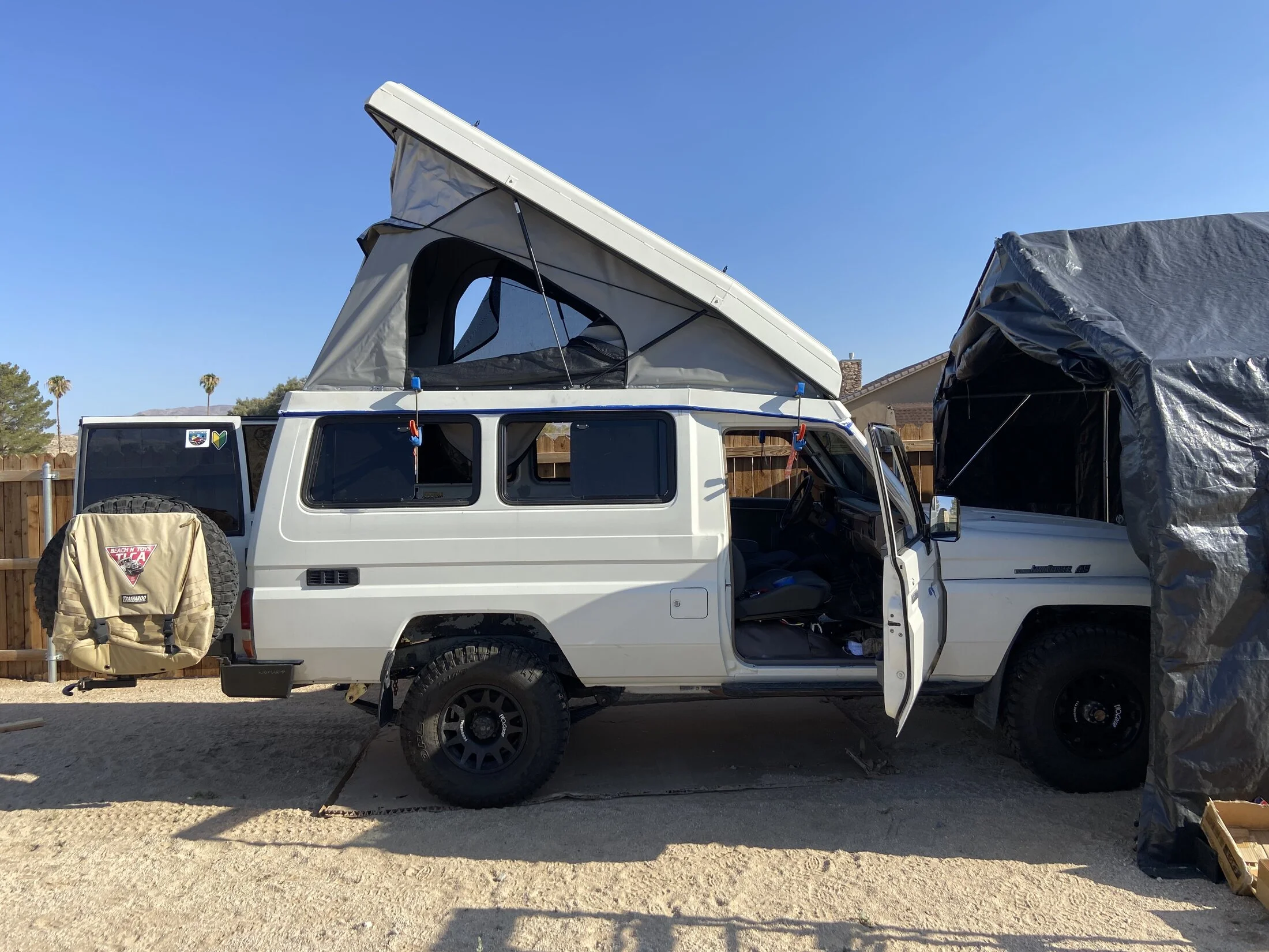

Sadly I didn’t document, but I was texting Paul sharing learnings and am confident his write up will be better anyway! Some big learnings, need to cut the rear roof pillar mounts to get it to sit properly, also getting the nuts on the pillar brackets is tough. The two options we could think of was to thread the holes (did this for the a pillar bracket) or cut an access hole to secure the nut from above (did this on the rear pillars).

There is a pretty detailed installation guide put together by Mission 4x4 in Australia; it's posted earlier in this thread. There are also a couple of installation documents for the Alu-Cab Hercules top available on the web, as well as installation videos on Youtube. A combination of all all of those resources made my installation relatively painless. Sure, there were some difficulties, but nothing insurmountable with a methodical approach.
But yes, the conversions are designed to be installed in house, or through a shop with experience.

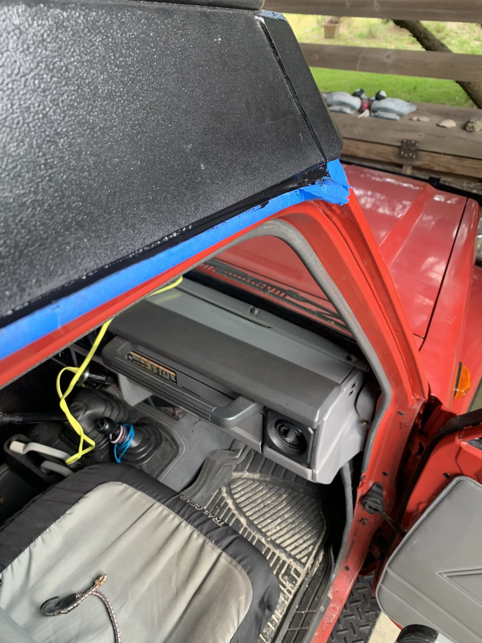

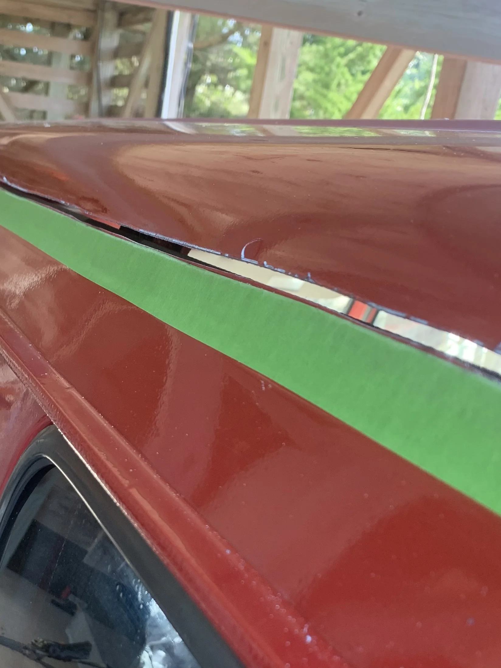

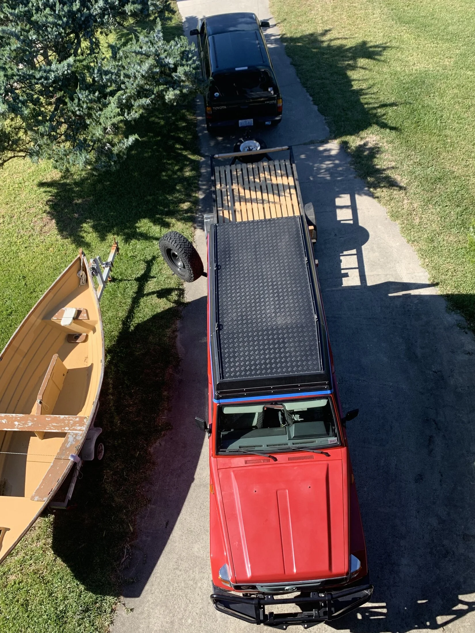

A. Cut hole in troopy roof
B. Put poptop in place
C. Sikaflex literally everything
D. Enjoy.
You summed it up very succinctly, 4 easy steps and job done.

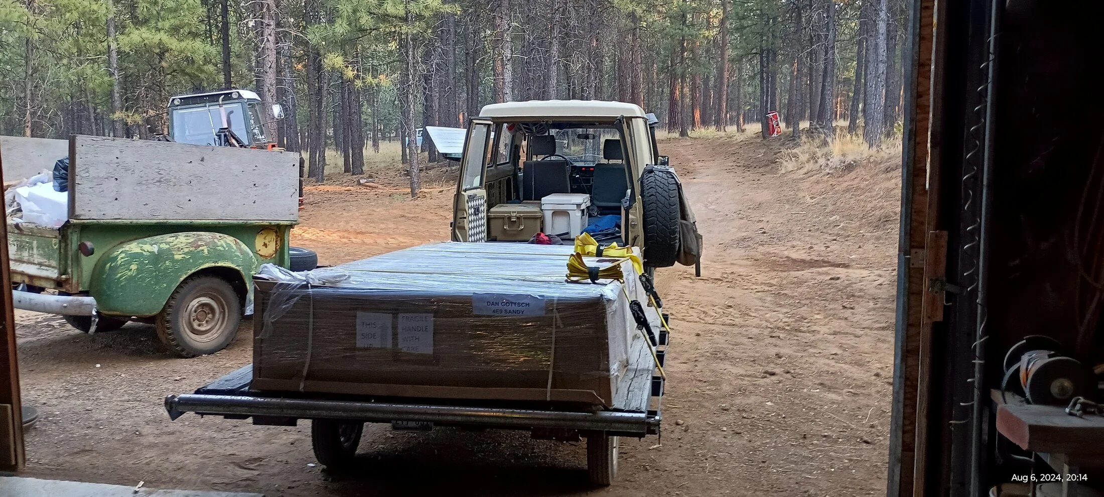

Update, 5 August:
Team, we continue to run into issues with the freight forwarder not being willing to pick up the 3x tops headed east. We continue to work with the shipper and they will attempt a final pickup NLT tomorrow.
They are saying the boxes need to be on larger pallets, something the other freight forwarders did not require. If the shipper does not pick up these other 3 tops tomorrow, we will work alternative options.
I know everyone is anxious to get their tops and I apologize for the delays getting these headed east.
