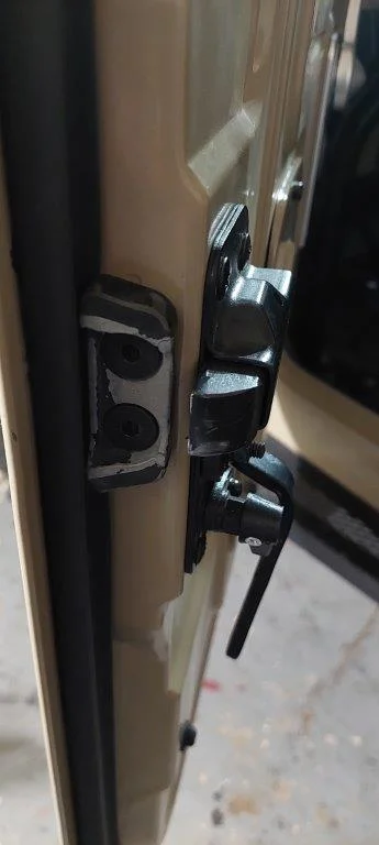

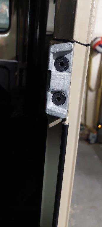

Year of the cruiser? That catch on the B pillar is adjustable. Picture of the catch and striker on the door would help. The style that ended 1/75 is prone to wear on both sections. That limits the amount of adjustment if well worn.

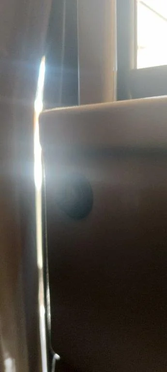

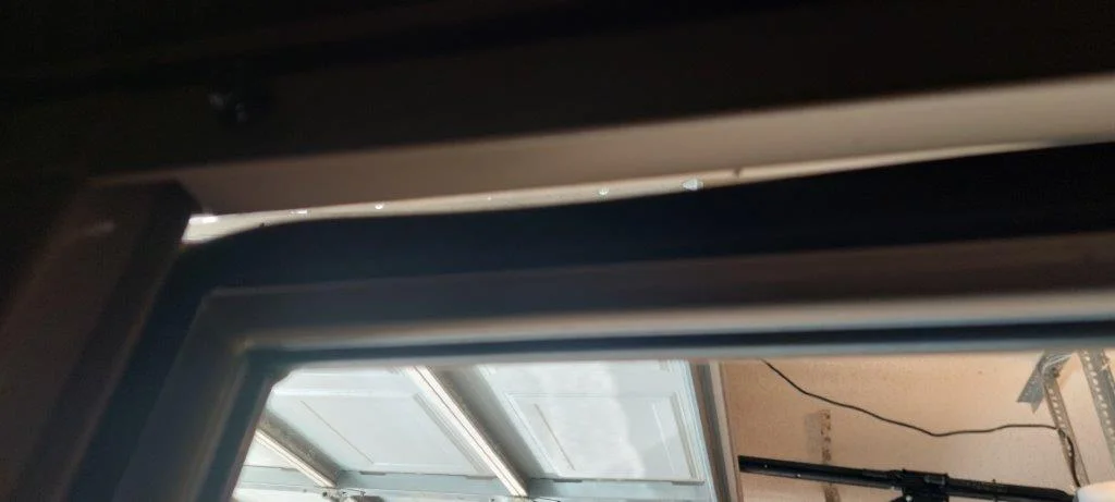

Here are some pics of where the gaps are. Thought that it was a good install on the weatherstripping.
The gaps are at the back end of the door near the door handle and at the top.
I feel like maybe the door is too tight against the frame (inside hinge bolts) and the pressure of the over-compressed seal is stopping the rear seal from closing?
I JB welded a small flat brass piece in my striker grooves, works great to help close the door fully.
