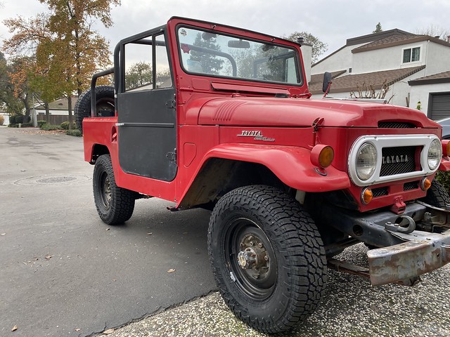

Build Clifford is home again- a 1965 FJ40 FST

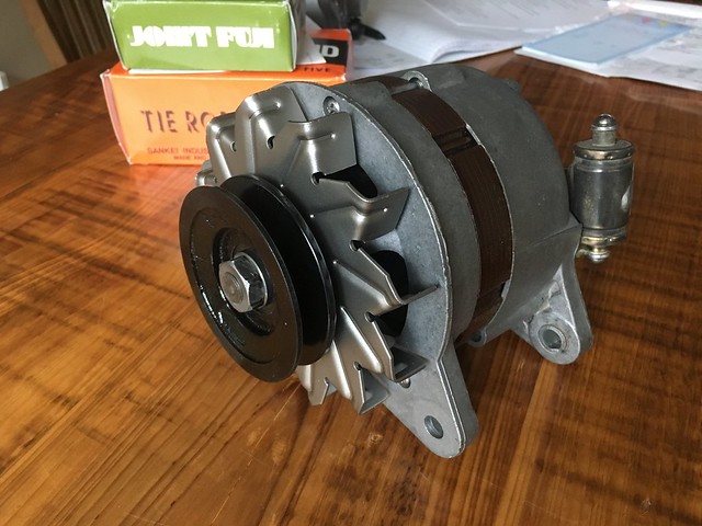

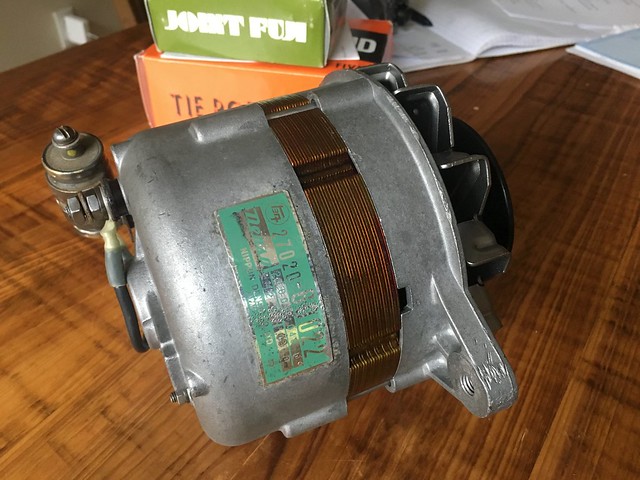

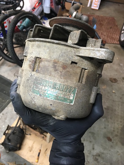

Got some teaser pics from @FJ60Cam of the restored alternator. Excited to team this bad boy up with the new harness and voltage regulator.
Before:

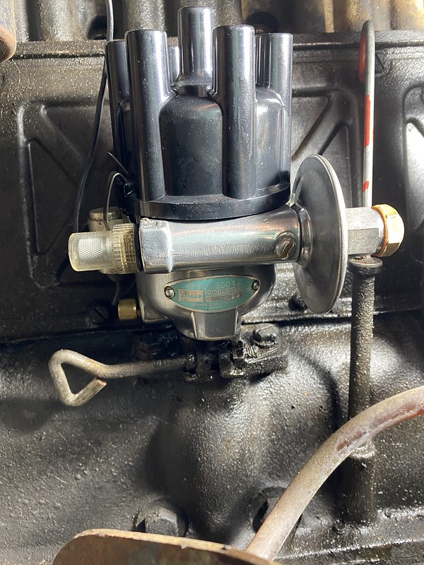

Had a bit of time to get some essential work done on Clifford during my visit to California. I was finally able to install the restored dizzy from advanced distributors:

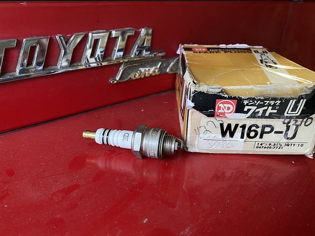

Did a little tune up with NOS Denso plugs:

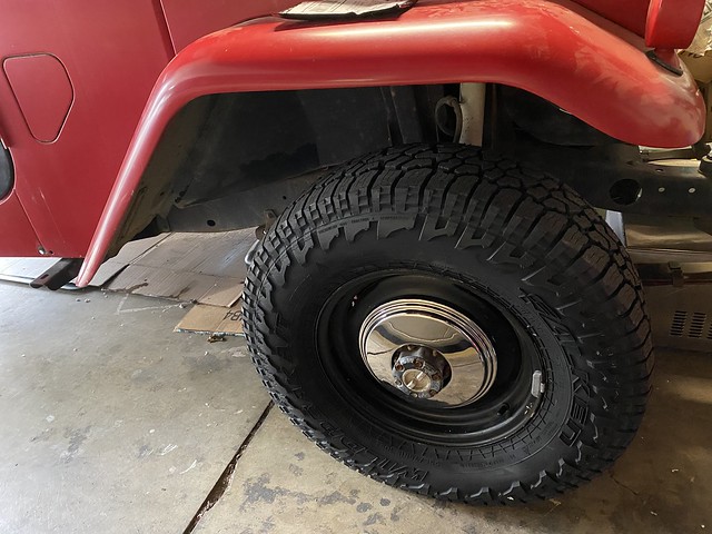

Finally got some new shoes (Falken AT3) in 235/75R15 size and installed the stainless period correct hub caps. :) I liked these tires, they rode well and the size is perfect for a stock suspension 40.

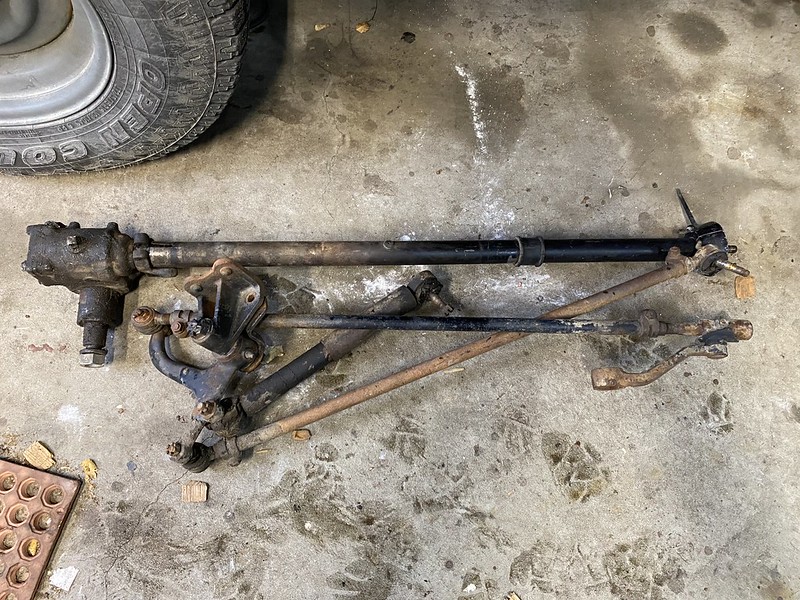

I did get a complete steering assembly from a 1964 FJ40 for free locally. I love how helpful and nice cruiser people are. Plans are to refurbish this assembly and use it to do a swap with the setup on Clifford to limit downtime. Then if someone wants my steering assembly for free they can refurbish that one. Need to keep paying it forward. :) Hoping to make a drive down to CA early next year to get some work done on it.
