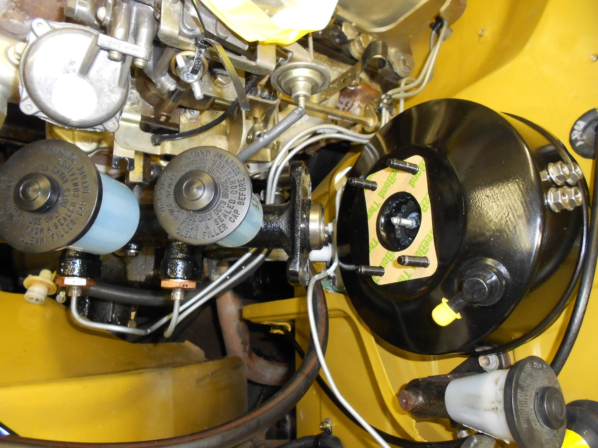

I installed @Racer65 's 4wheel Drum Brakes on A NON USA 1/79 FJ43 , I was replacing a bad booster leaking fluid from a bad master leaking fluid , His Booster is a Quality part , With factory Fit & Finish , I also purchased and installed His foil decal
Not for bling factor so much ............well not really :rolleyes:
, i stamped the original OEM part# in the new foil decal on it now it reflects a correct by the book replacement
also oreded the paper / fiber OEM toyota gasket that goes between the master & the new city Racer booster
