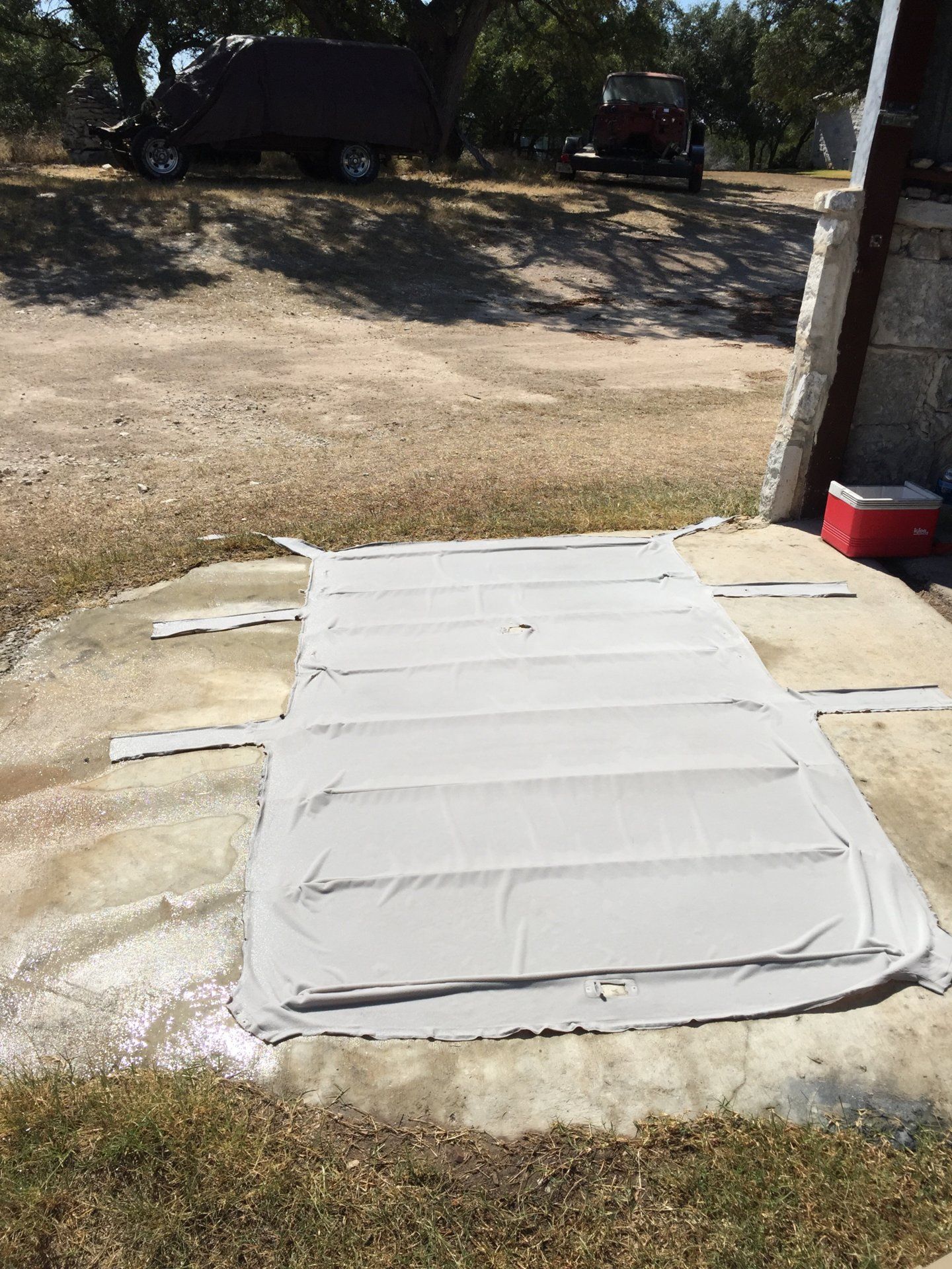

Headliner coming down!
I might see about getting the headliner dry cleaned. The bows come out easy after pulling the plastic end caps.
Anyone dealt with this?
View attachment 1813987 so I soaked it with oxy clean. Scrubbed it with a nylon brush then power washed it. I’d say it’s now a 9 out of 10. I’m assuming yours is cloth.
That looks great. Yes, it is cloth. Kind of like a velour kind of finish. I didn't know if scrubbing would hurt it, but I guess not. It is dirty but looks very saveable.
Pat, I thought the same thing but if you look at the back side (if i recall) you'll see it's actually a vinyl type material so it does not stretch or get out of shape. I would not recommend nailing it with the power washer but I do hit it from about 12-18" away. Also, I did mine on a slope so the water and soap would run downhill. hope this helps.
Very much. Thanks!
