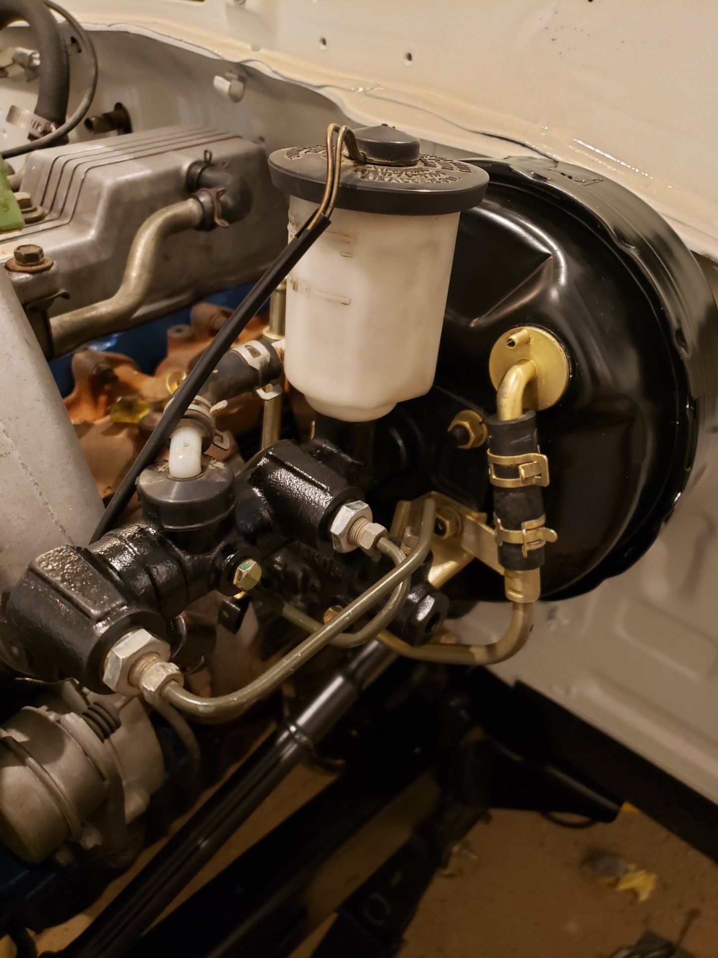

Next was booster and MC.
Same deal, try to spruce it up a bit
Ohhh that's purty...So that's what a steering box looks like without an eighth inch of PS fluid grime on it.

What’s your take on the wiring for the brake fluid sensor? Does the white connector just hang in the air? Or is there a better way to do it? I’ve been thinking of using a zip tie to fasten mine to one of the hard lines.
I'm not sure, some way of tying it up make sense. Maybe a removable zip tie. I have a mountain of those from powder coating boxes.

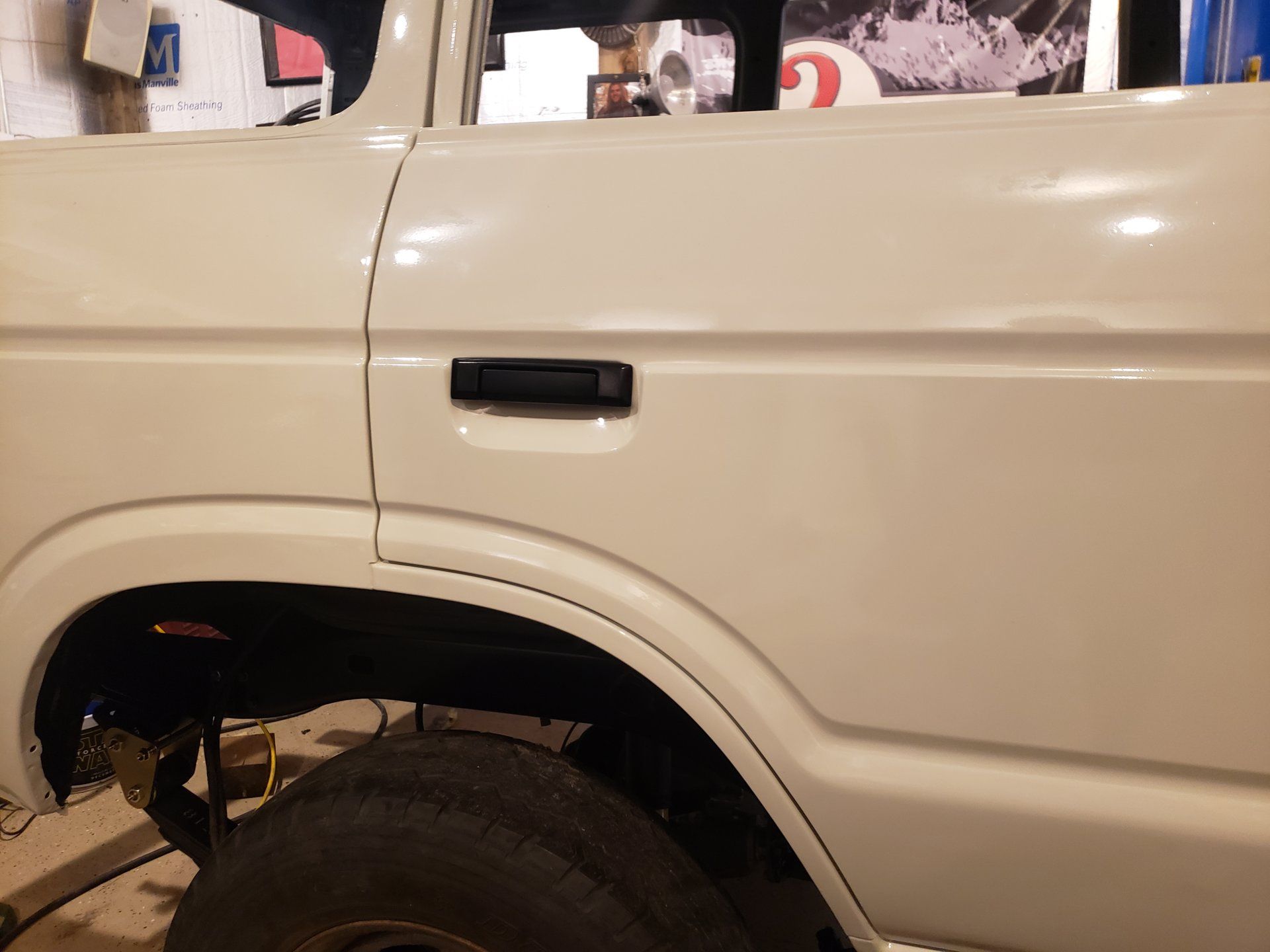

I got a little more done today. I powder coated the hood hinges, the drains, and the fuel filler neck. I forgot to coat the drains before I changed out the black so they got silver. Looks kinda cool with the black coated screws on the white. Won't matter since it gets covered up but oh well. I used 3M heavy drip check sealer under them.

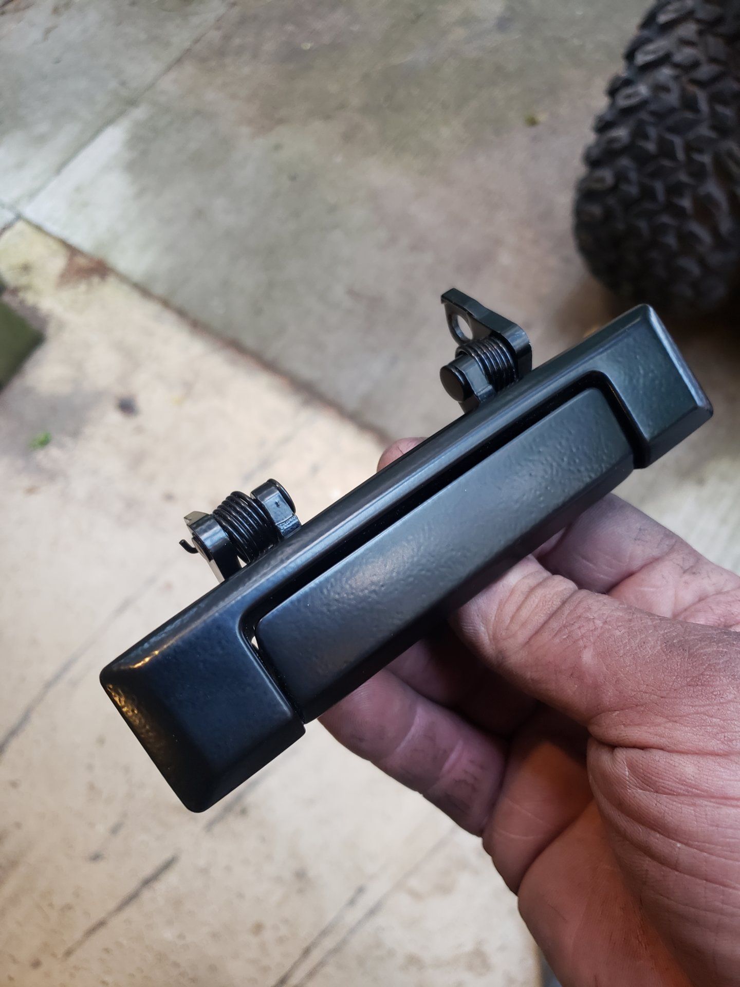

I also coated a (broken) door handle to see how I liked the black. At first I didn't, but after looking at the picture with the stripes I think it will be cool.
