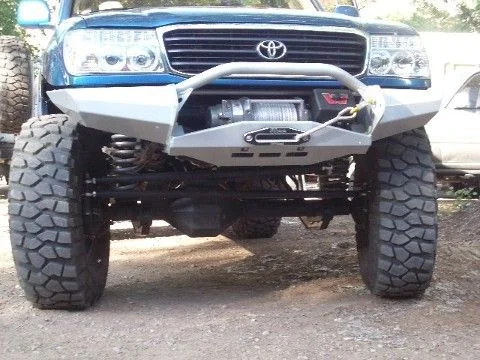

Christo, could a 78 front axle be used? or is importing one just too $$$. That would allow one to keep 5 lug. What you have built is intended to run 39's and is super bomber. I'm sure the 78 axle is not that strong, but would it be ok for say 37s? Are there R&P or other issues that prevent it's use?
We did think about that. Catch is that I did not really want to run imported parts (like hubs etc) for serviceability. I would have loved to run 10mm studs on the hubs instead of 8mm.
To be honest converting the rear to 6 lubs was pretty cheap and painless, other than the expensive bearings we had to press off and destroy in the process.
Honestly once one see the fabricated housings and the benefits, retrofitting an existing axle does not make sense. Double axle seals, one on the diff side and one on the hub side, 3/8" wall axle tubes, better clearance, way easier to work with because the tube is a consistent shape, clean metal, no grinding and cutting, less change for heat distortion when welding to the housing.

Same setup as the 80, except for steering, 80 arms with panhard rod. In the picture you can not see it since it is behind the drag link at the same angle.
The hi-steer allowed us to have pretty good angles on the steering rods. After CM we will add hydro assist. We used a 80 steering box with a new pump from PSC.

No, the bolt pattern is the same. Small modification to the bolts needed. The bolt holes on the pump fits 8mm bolts, but the stock pump attaches with 10mm to the bracket. You can get the correct serpentine pulley from them as well. Right now we are running the stock belt, but we will see if we need to go down a size since the PSC pulley is slightly smaller. I believe it is the TC series pump.

What year 100's can you just "cut off the IFS crap" without starting to mess up more than say ABS? Do any of the other newer systems like atrac, etc get affected in a way you can't just "shut off"?
Christo, that may be the best looking full size I've ever seen :beer: . Definitely will be a market as the older 100's get down in cost if a goal like 37's and streetable remains achievable.
My wife needs a new car and I've been thinking she needs to test drive an older 100 :D
ATRAC is ABS. ATRAC, DAC are just using the ABS in a different way. Instead of activating on brake lock, it activates on gas pedal wheelslip.
If you loose ABS, you loose ATRAC.
I'm sure there is a way to retain ABS, just needs to be figured out.
:D
Its not super easy like a IFS mini truck. The IFS stuff is connected to the motor mounts on the 100, so you have to remount the motor. ABS is pretty simple at the wheel end, you just need a counter...
