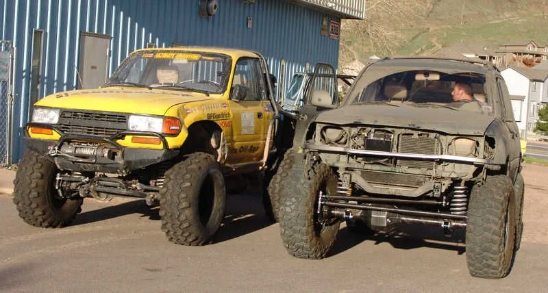

Sometimes you have to let the bling go for what was used on the shelf :D No crawler, but I am planning to do the 3:1 gears to see how they work.
Another pic to show the size.

I've never seen a 100 w/o it's headlights et al. Is the hood wrinkled from the previous accident? or is that just how they look?

Little crinkle from previous contact with a ditch.
Right now I do have one set left, but I used the little ABS Hole Slug due to a mess-up with this truck. Never weld the slugs into the knuckles without checking all the bolt holes if they are ok. :D
With our next batch I will have a couple of extra slugs machined.
Prices are $595 for the arms, and $175 for the RHD Bottom steering arm.

Same setup as the 80, except for steering, 80 arms with panhard rod. In the picture you can not see it since it is behind the drag link at the same angle.
The hi-steer allowed us to have pretty good angles on the steering rods. After CM we will add hydro assist. We used a 80 steering box with a new pump from PSC.
