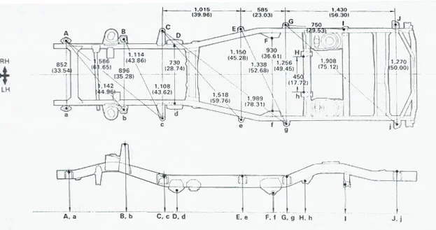

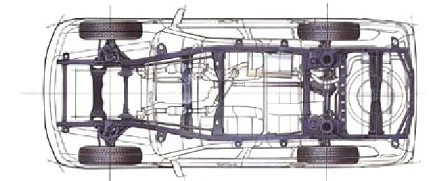

dropping a 100 series body on a 80 series frame sounds like the cheapest way- which is what they did right?
welding on new body mounts sounds a lot simpler than messing w/ suspension parts
1) 80 series frame
2) 100 series frame
3) superimposed
Difficult to see but it looks like most of the body mounts already line up or near line up. The 80 and 100 also have the exact same wheelbase.
