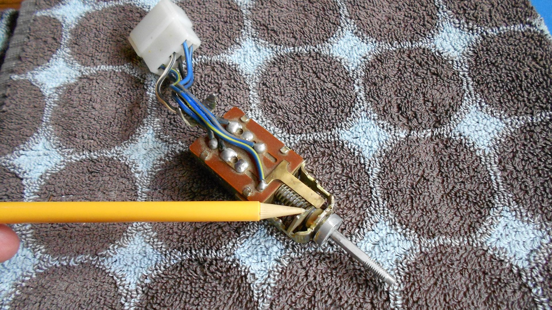

I had to do that to get my wipers to work a few months ago!Your Welcome !
Side Note Related To Choke Cable removal & Install, Im assuming Your wiper switch is pulled to gain access to the 17mm hex nut retainer , make sure U Polish the flat ground contact strip and the rotate ground contact on the front of the switch too , use a mild emery cloth
