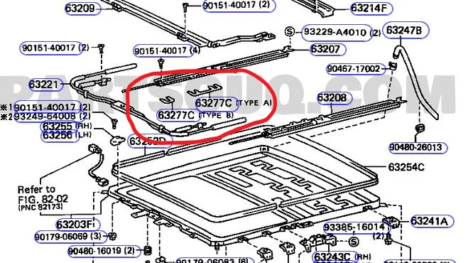

Try pushing up on your sunroof glass from inside the vehicle, if there's significant movement upward one thing you can try is to add shims under the glass mounting studs (Toyota sells those shims or use your own) to push the glass up. That may help form a tighter fit between the seal and the roof.
Two type of shims:
Two type of shims:
