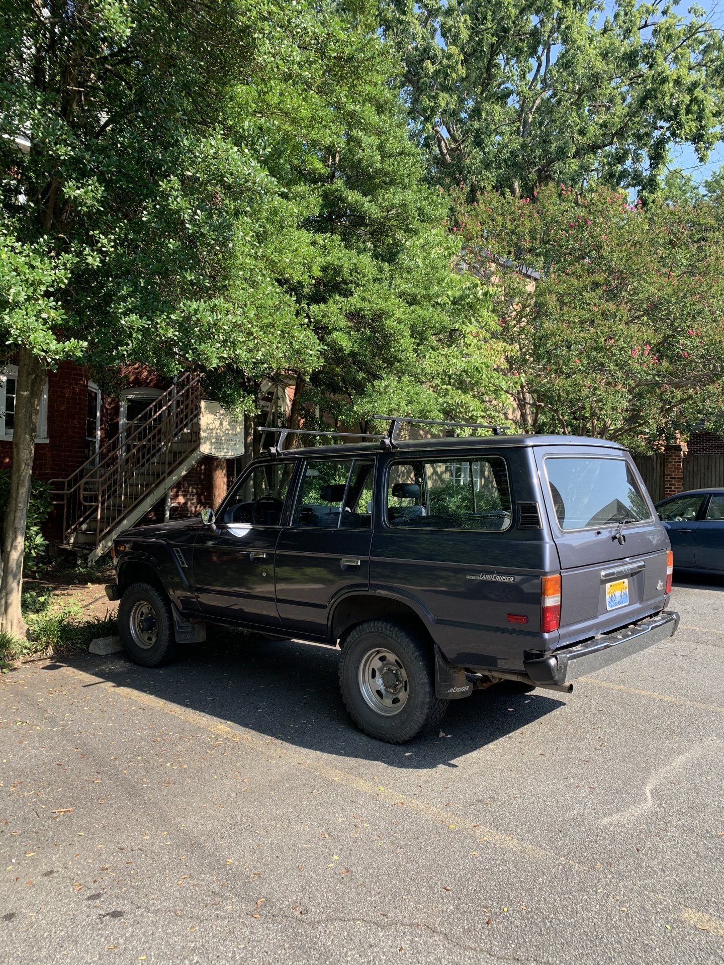

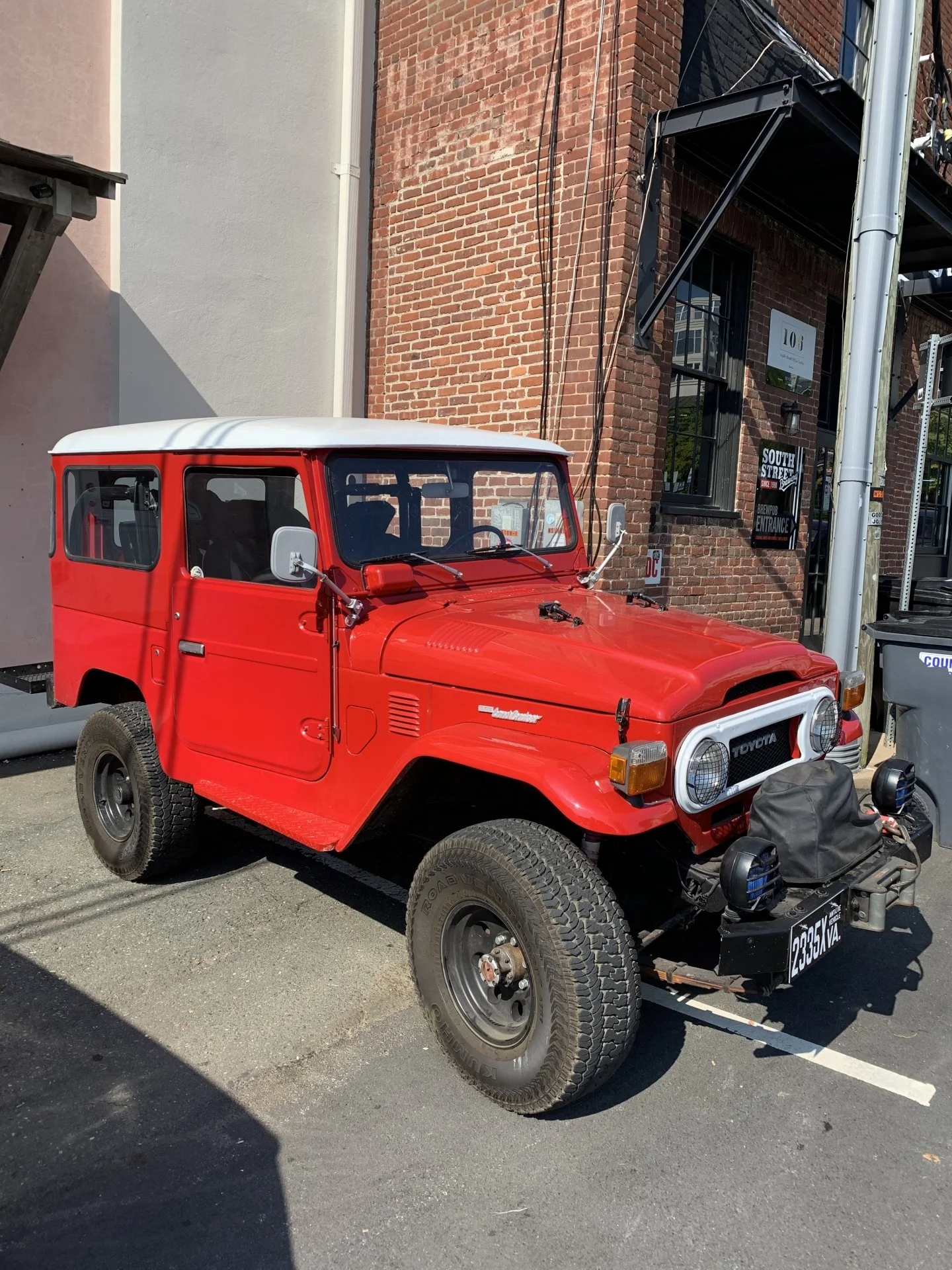

Cruisers allover downtown this morning. Saw an 80 pass me too, but didn’t get a pic.
The 60 belongs to my nextdoor neighbor👍
Didn’t look it over for long but from what I can tell seemed to be in pretty nice shape.
