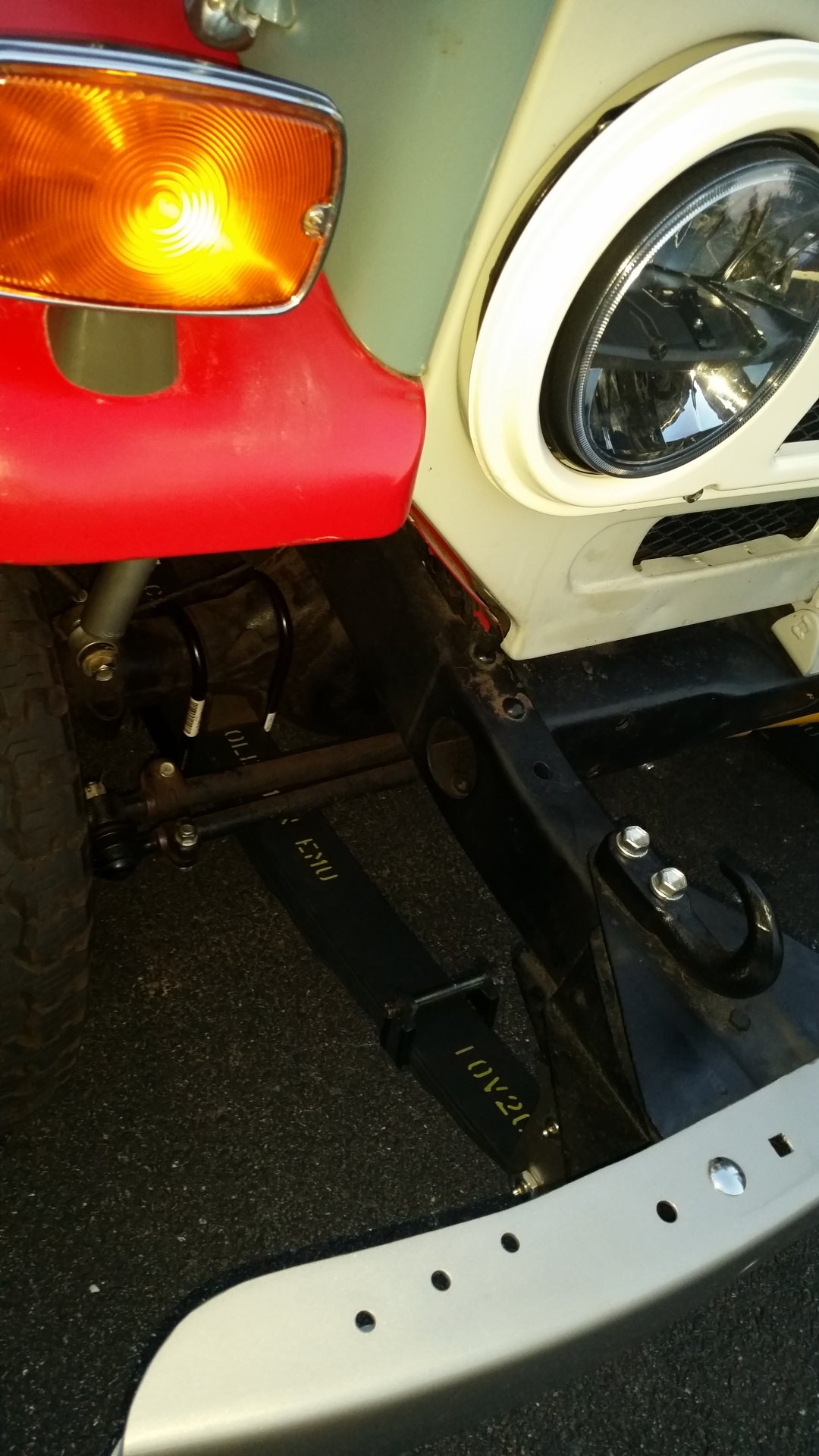

This did get done (new OME suspension kit) Last October, after my surgery. We did it in two days. Wrung the 10mm machine screw that holds the cam shaped spring pin plate on the outside. It probably took a couple of hours drilling it out. One side didn't want to line up and the center pin didn't want to fall down into the U-bolt plate. We finally used a ratchet strap to pull it in line and it fell right in. @Igotmearedone, how's it holding up?

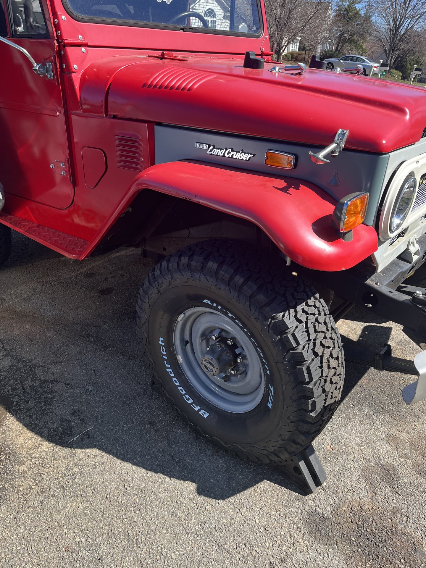

It’s awesome! I’m very happy with it. Thanks again for the help! And I just got 33” all-terrains. Hopefully can go for a trail run this spring/summer

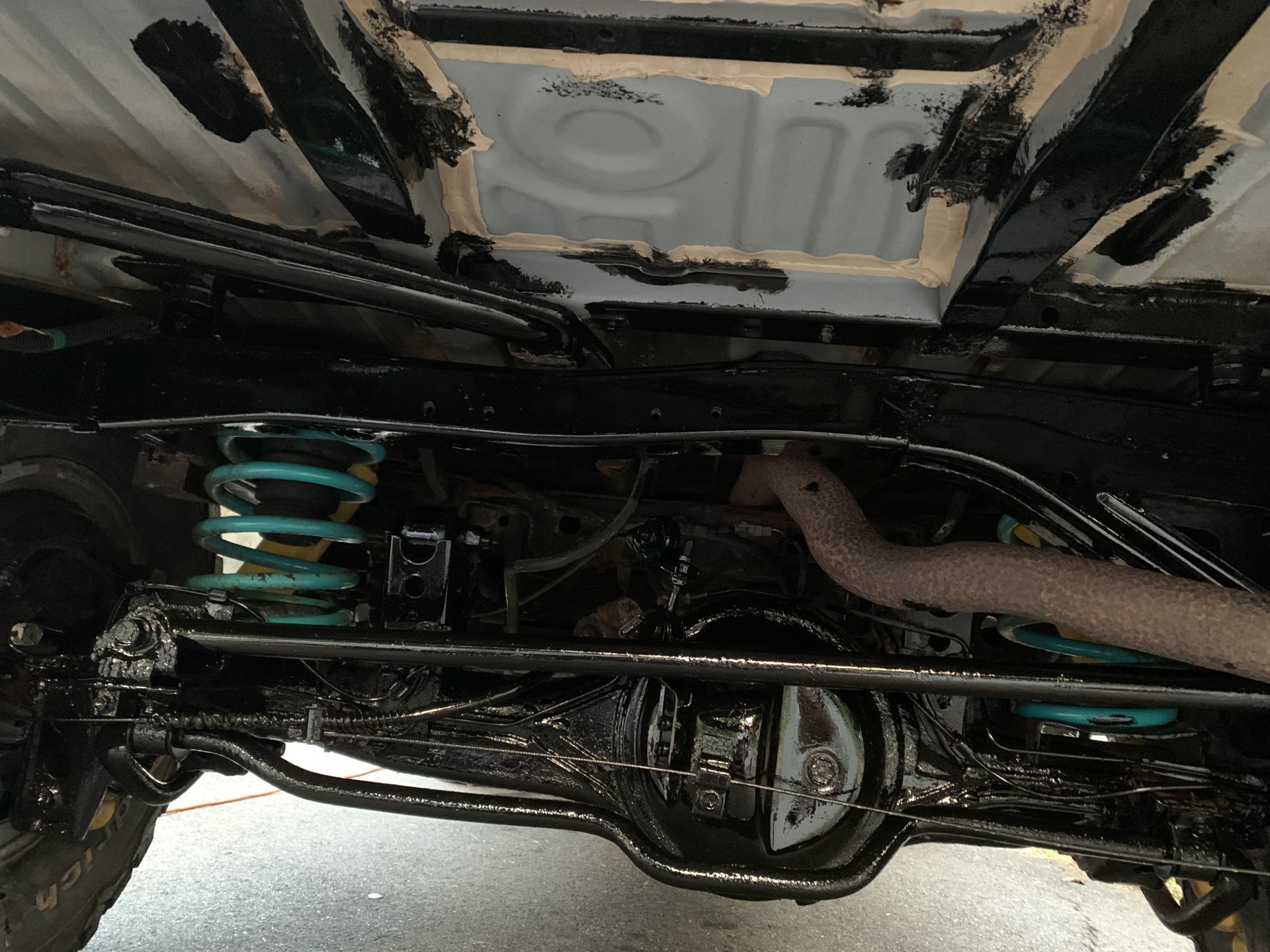

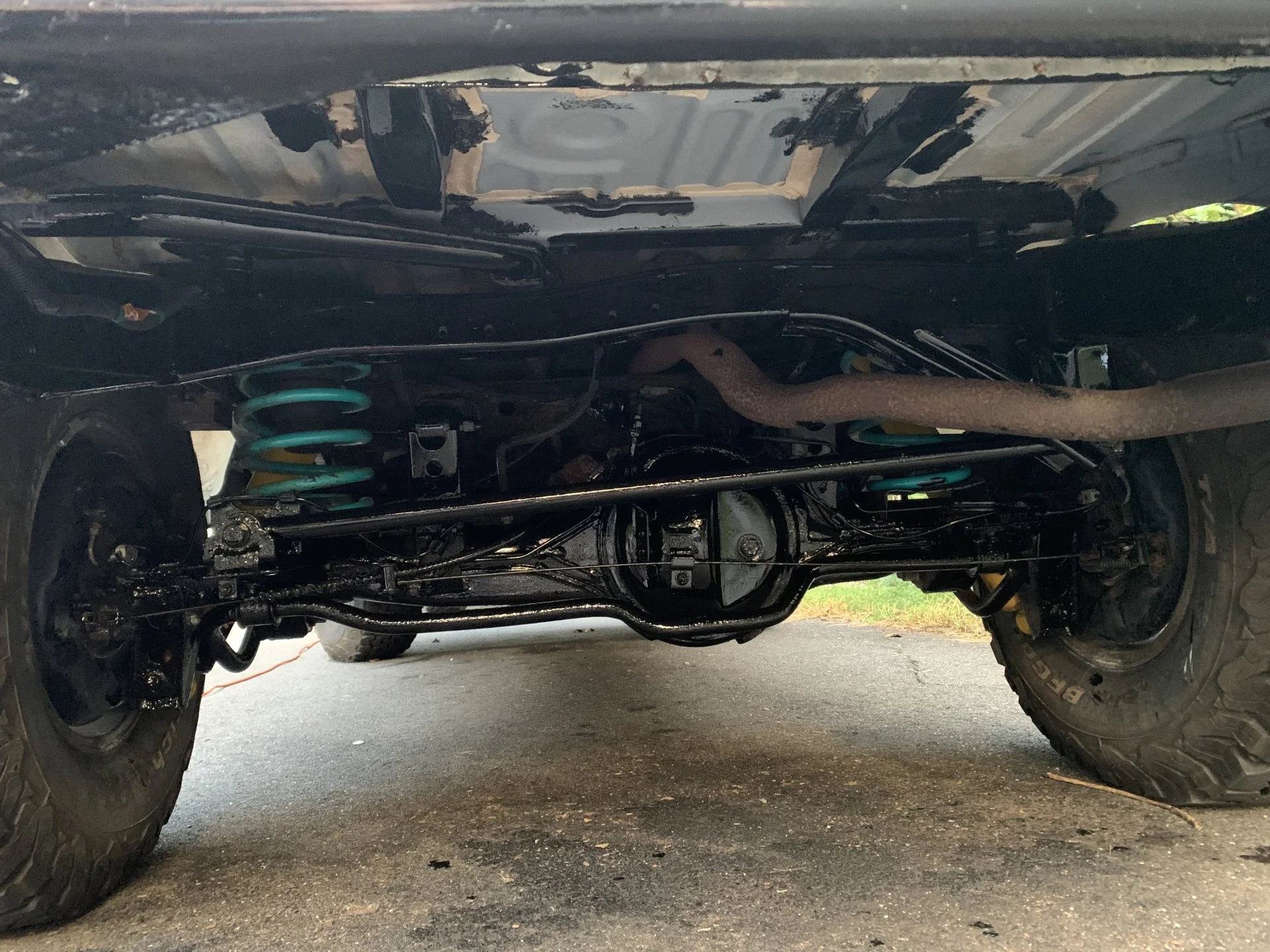

I decided to try the por15, the prep work is a bitch but it’s starting to look good. I was shocked how good the sheet metal looks after I degreased and power washed it. The only really bad rust on the body is the drivers side, rear quarter panel. The two body shops in Charlottesville I went to didn’t want anything to do with rust repair, so I just hammered a piece of sheet metal and pop-riveted in as a temp/permanent fix so I can rehang the mudflat. If anybody knows a good sheet metal person/shop, I’d be interested.
