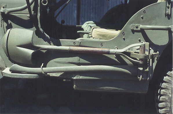

Willys jeeps had provision to carry tools on the side like this -

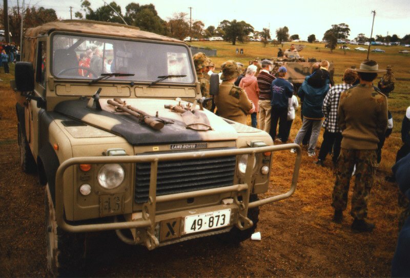

Land Rovers carried tools on the hood or fenders like this:

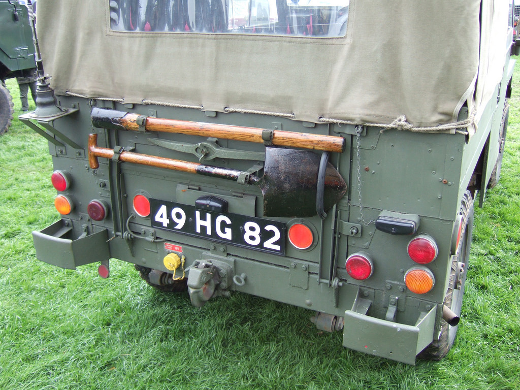

or on the tailgate like this:
