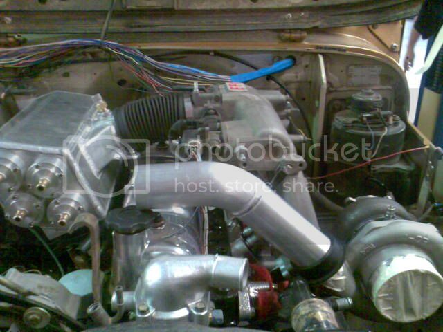

This has been a fun exchange! I didn't realize that someone here had gone to the extreme with the 2F. I always thought it would do a turbo becuase of the relatively low CR. But all this still begs the question; if you're going all out for power, why take a slow engine and make it fast at some rediculous cost, when you can take a motor that's already fast and make it faster for a fraction of the cost? Cool factor is one thing, but jeez!
