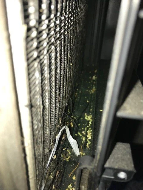

Just finished this mod today. I used the method @2001LC described and removed some of the support bracket bolts/nuts, made removing and installing the new cover pretty easy. There wasn't too much debris in there but the condenser fins were pretty dirty. I cleaned the fins with some a/c cleaner foam from Home Depot and wiped out the dirt from the filter area. Also dropped the fan and cleaned with Simple Green. As mentioned earlier in this topic, I replaced the packing cooler foam at the bottom of the condenser box. The old foam didn't look too bad but it was only $10 and seemed like good insurance to avoid leaking.

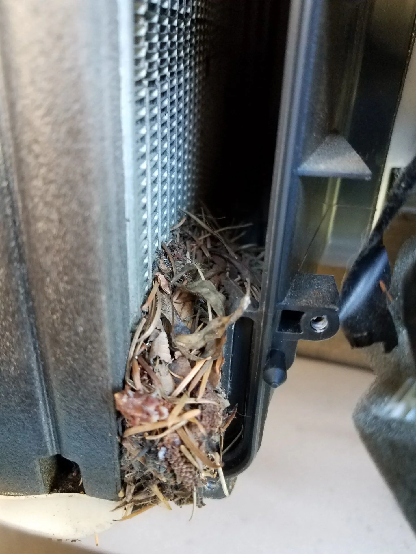

I am highly annoyed by this. How is it possible that some LC's have a slot and some don't? There seems to be no logic at all to this. I came across this problem while trying to figure out why my cabin is always so dusty compared to any other car I have ever had. Total vacuum/wipe-down and two days later everything is dusty and sandy again. Found the air filter DIY and came across this: no slot for air filters. You can actually see where the slot should be, like Denso just sent out a batch where they forgot to cut out the slot....

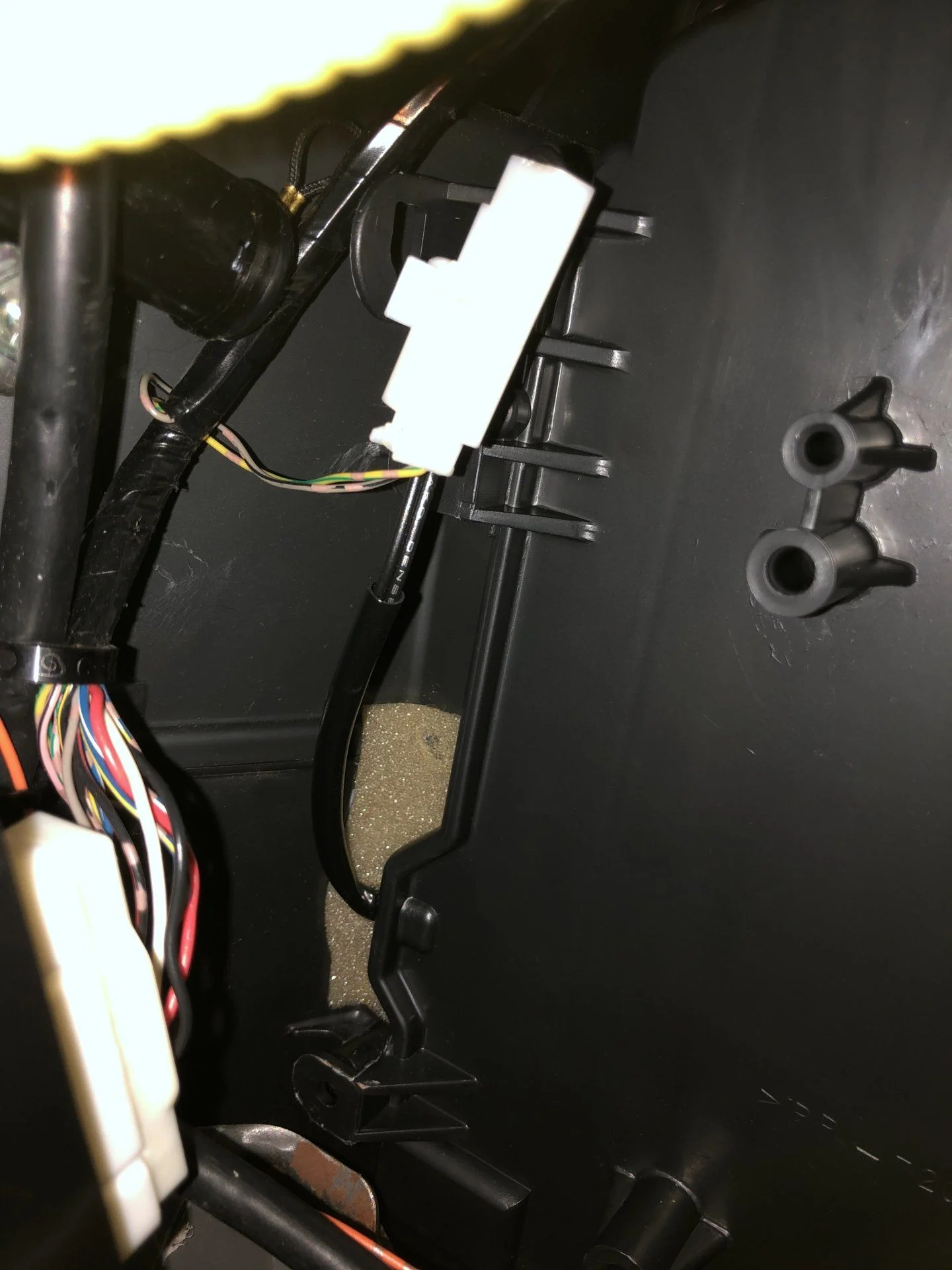

I did this mod a little while ago...heads up...there is a wire that fits right along the side of the air filter housing in a precut notch. Make sure this wire if back in the "notch" before you bolt everything up. Other wise you will get some dripping and your LC will smell like feet. Once I placed the wire back in the notch the leaking stopped and the smell cleared out. It's small potatoes, but a pain in the butt if you mess it up.

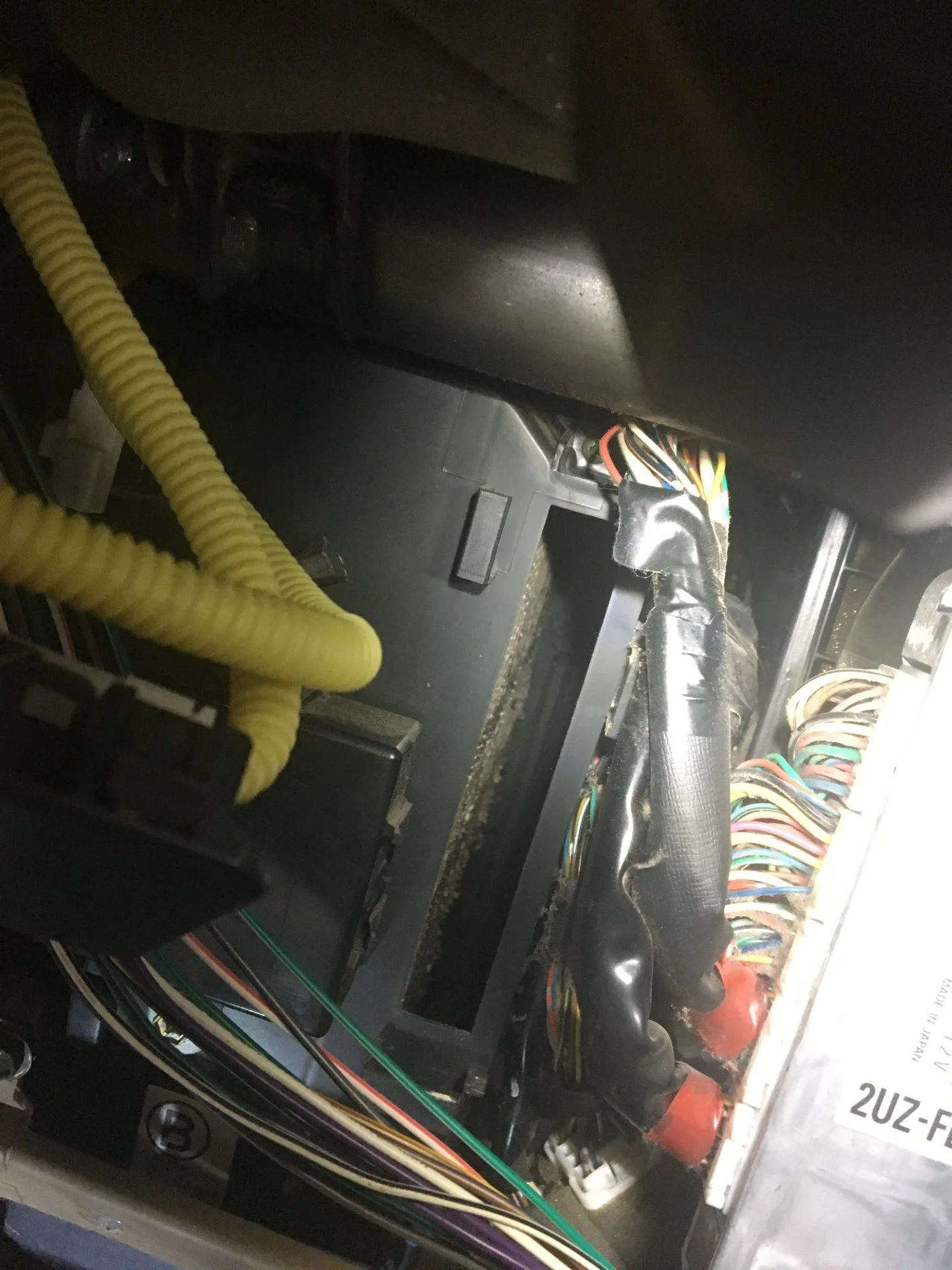

I took my glovebox out today and found that I do have the space for the air filters. As one can imagine, after 18 years it looks pretty dirty on the fins in there. What would be the best way to clean them? I can’t get a vacuum attachment in there. Any type of spray that I could fire up in there? I have some toothbrushes I could extend to clean them as well.
What product would you recommend to clean the 18 year old gunk off?
I found 00289-ACRKT from another thread in this forum. I already purchased it but haven't used it yet.
I got a vacuum in there and cleaned it out...be careful not to bend the fins...like I did.
Also make sure you get the one wire routed back in correctly puns the edge of the door, if you don’t it will leak.

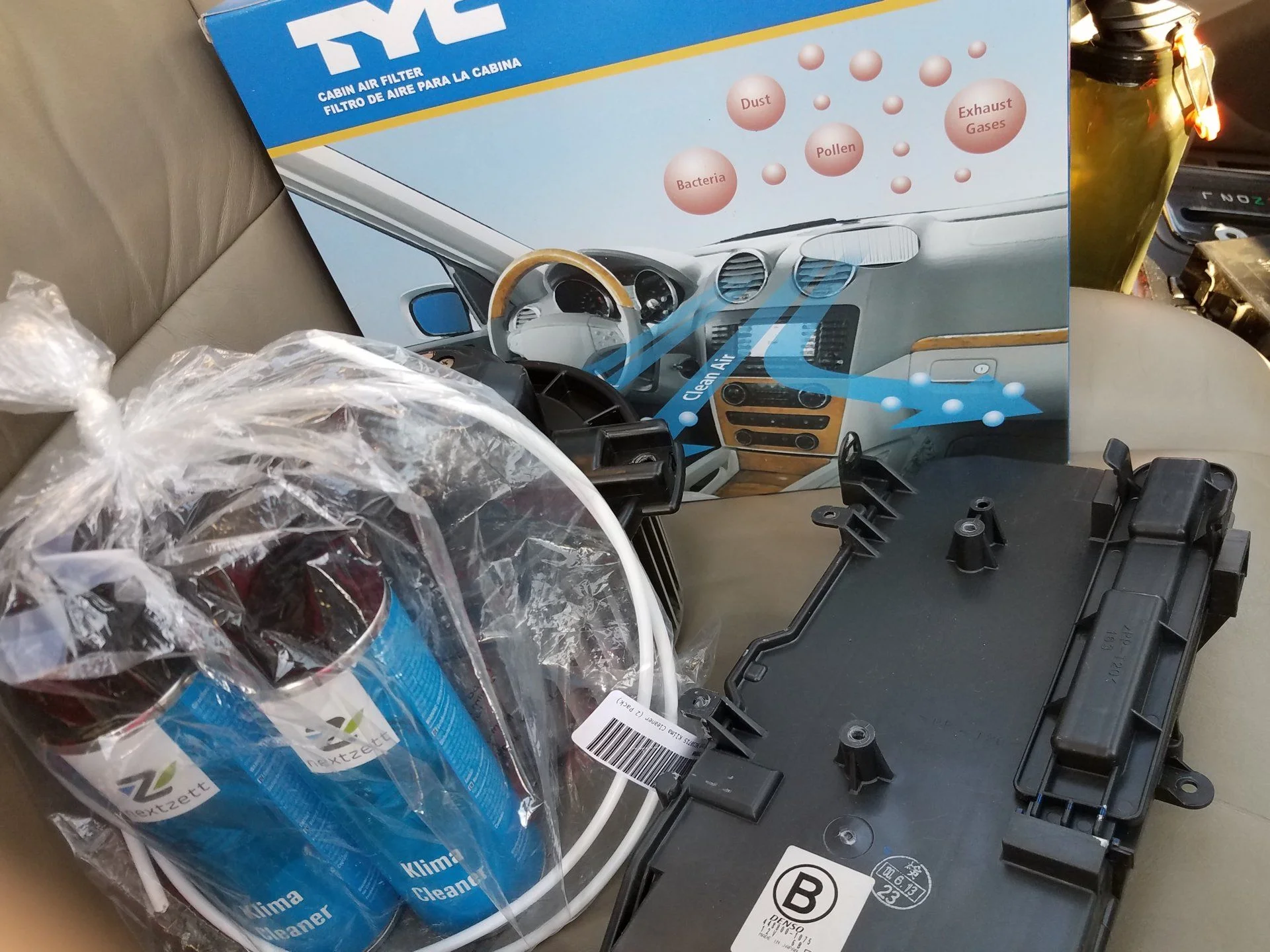

Thanks to this thread I was able to convert my non cabin filter HDJ100 to filter the air:)
Big cover & cover door & 2x nippart activated carbon filters. The air is so much cleaner and better!
I had to dremel the nippart filters (the tab on the back side of them) to make them fit, guess that’s what you get for $6 each :))
