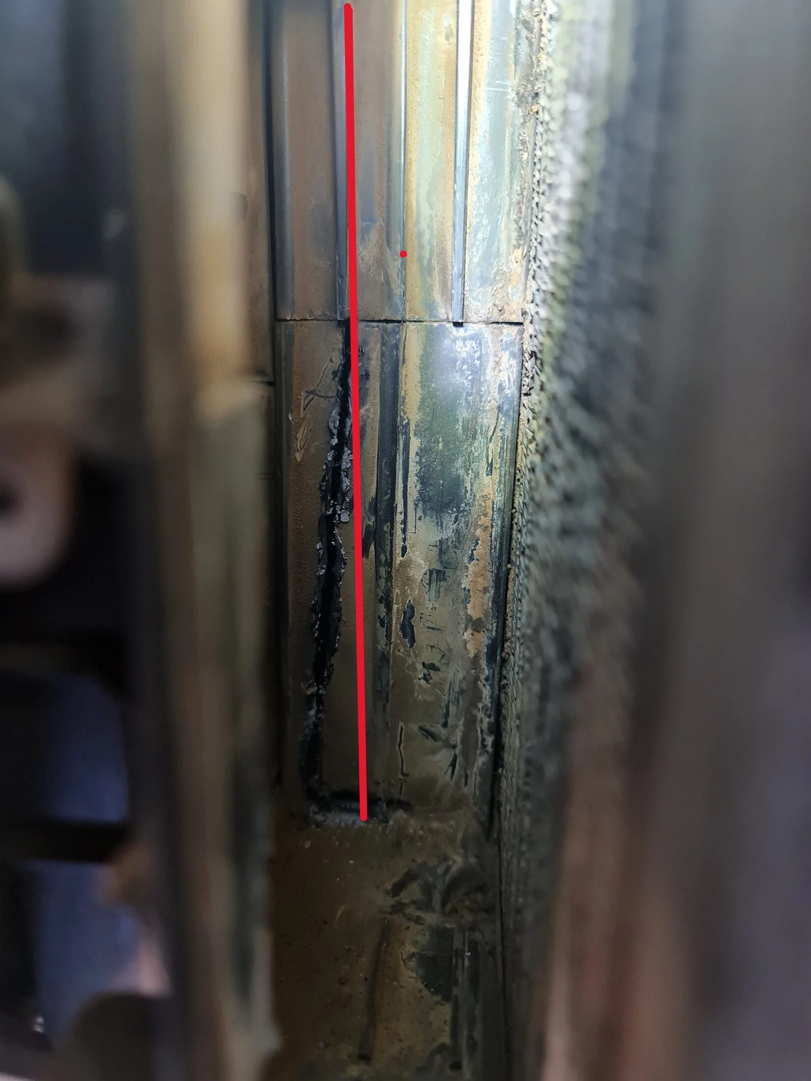

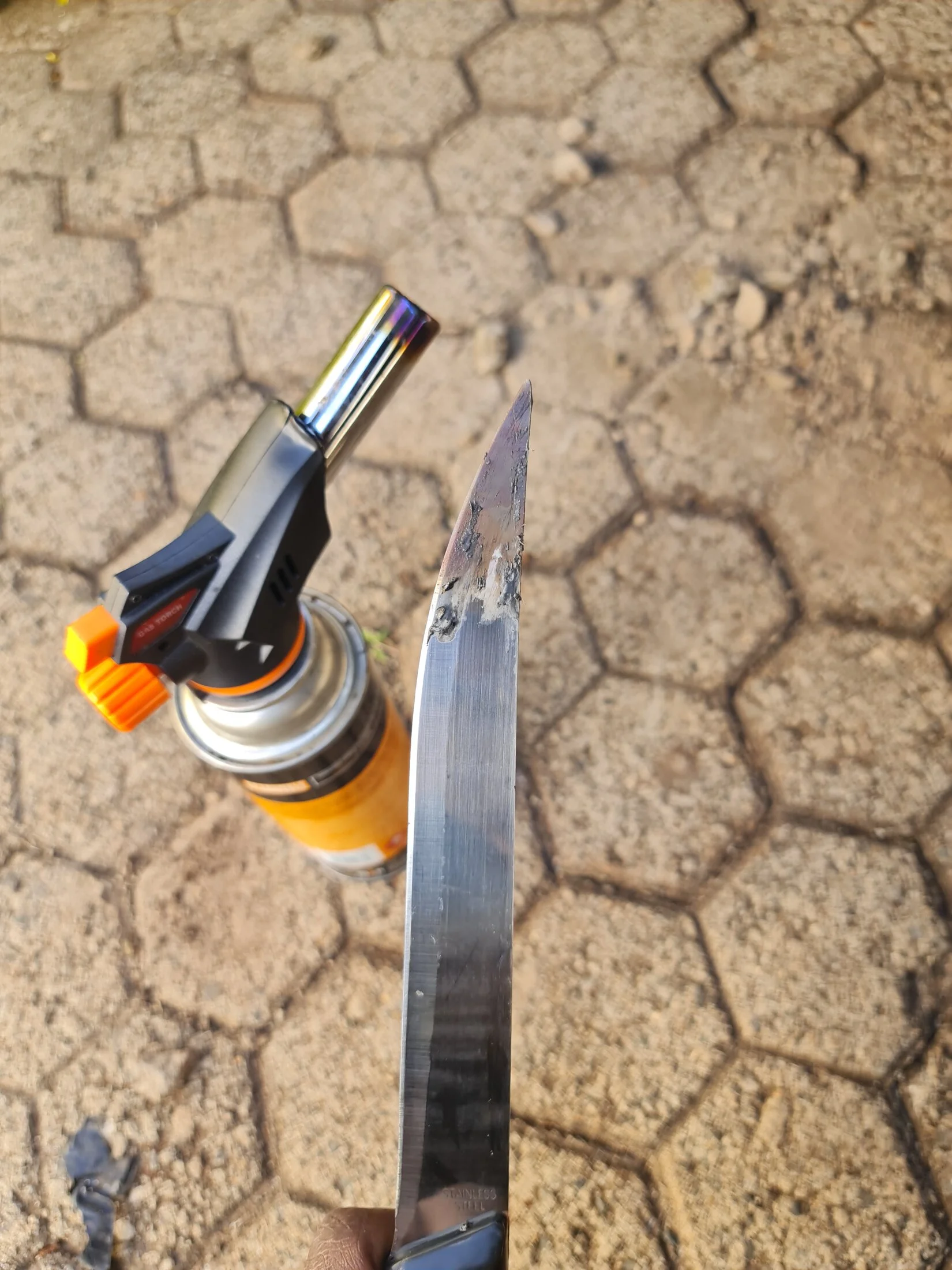

I have just done this on my second J105. Good info on this thread. I used a hot knife as in the picture below. If I knew, I would have cut along the red line from the bottom because the slot narrows towards the front. I cut along the red line on the upper part. I used a hacksaw for fine cutting on the upper groove to accommodate the top filter. The entire job took about 45 minutes; most of it with the hacksaw.
Hot knife and blow torch.

Yeop, so when you cut the centre divider, just make sure it is measured up and you cut it so NO air can escape through any holes through/before it hits the filters.
Best way to know if you've done a good cut, is put the filters in, and if they are a snug and little hard to push in -- you've got a pretty tight fit.
