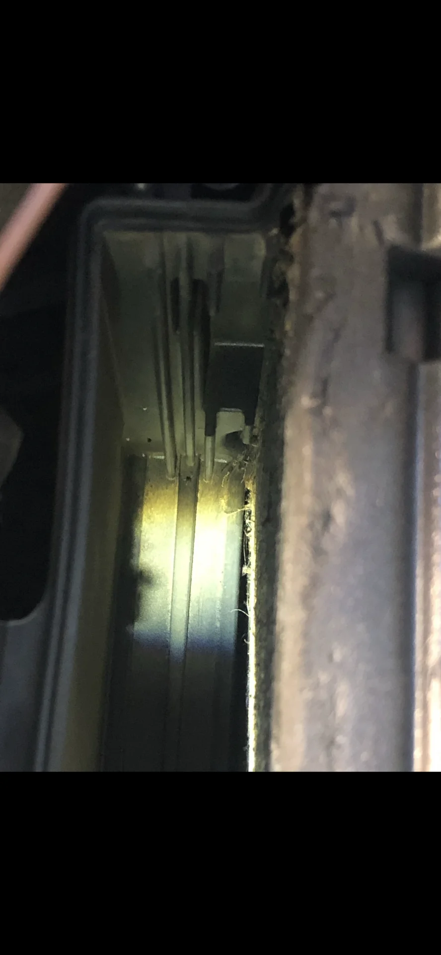

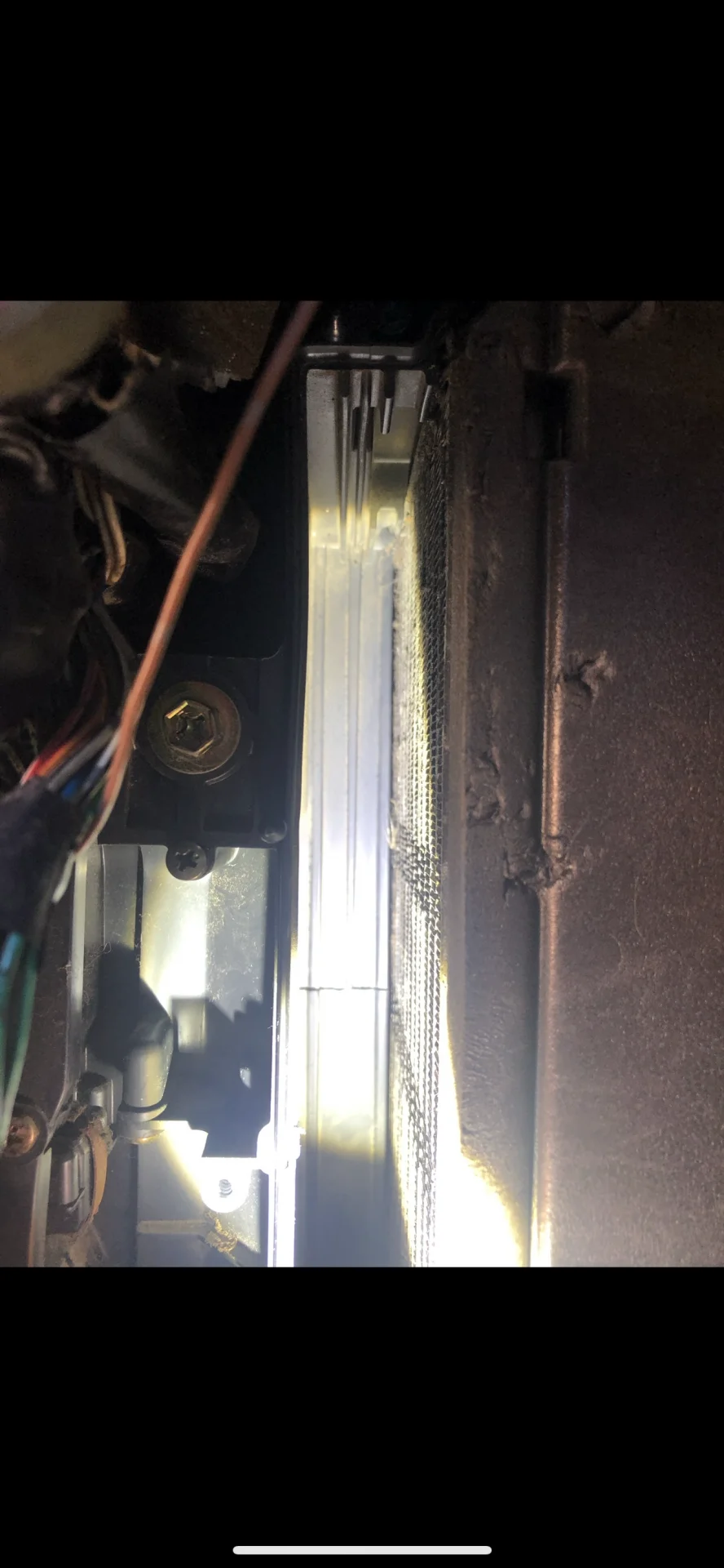

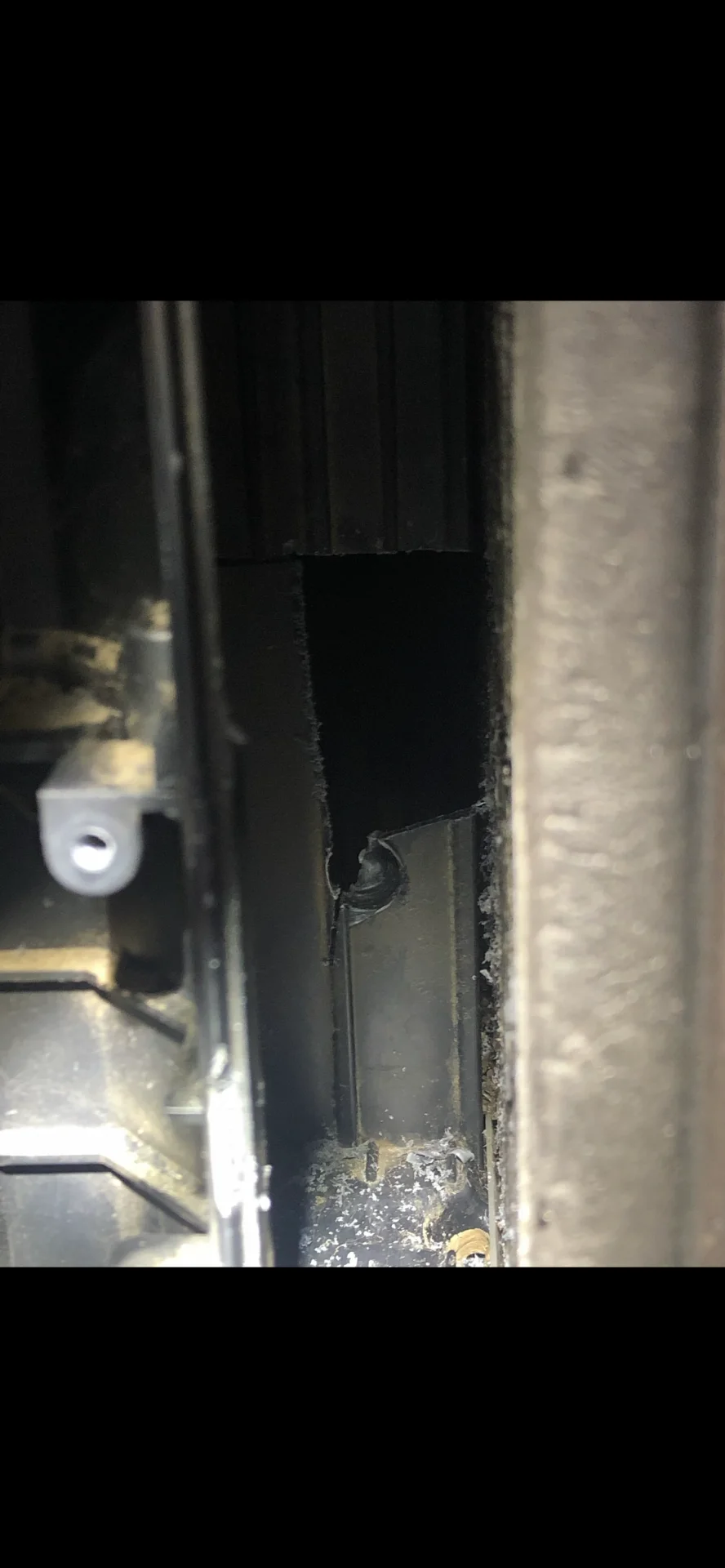

Hey mate,
The filters are a snug fit yep. The divider that you're cutting out is as wide as the filter itself. The divider is only there to separate recycled air vs "outside air", when you cut that out it's then relying on a nice seal of the filter to get that separation still.
Here are some pictures to help you out with getting a feel for what needs to be done.
Apologies as they're the only ones I took. You'll be able to see the channels at the top that you need to be careful of (you need to make sure you leave them there for the filter to be able to slot in correctly), I took my time with a knife on them once I'd done a horizontal cut just below them.
I also hosed out the entire box with a garden hose and medium pressure nozzle to get all of the crap out of there as well as clean the drain at the rear where the hose goes down through the firewall.
It was also a good time to replace all of the seals on the door as the factory one (at the bottom) had perished and couldn't be purchased any more. I just bought some strips of rubber from Clark Rubber and very painstakingly cut long lengths to feed into that seal as well as add one around the entire outer diameter of the door (in the seating channel) so that I would get a proper seal. I've not had any dripping on the passenger footwell since.

Hey mate,

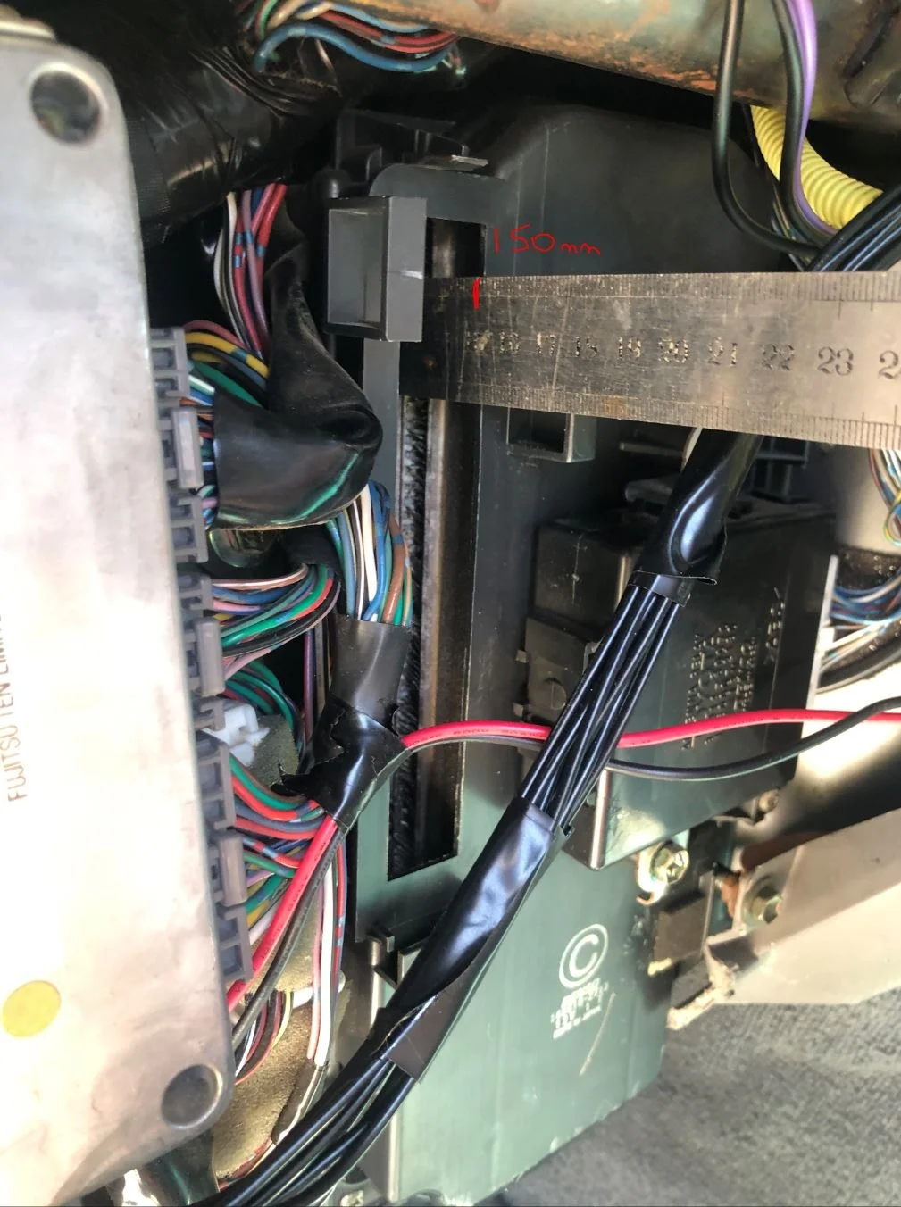

How wide does the inside width cut need to be <-> does it meet the end perfectly. What I mean:
I mean horizontal width obviously, wouldn't want air escaping around to and from the inside vs outside air compartments.
Must be easier if you get the cabin filters first so you can kinda measure the width of those.
I'm thinking this black cross section sits in between those 2 compartments you mention, so blocks the air from entering from one side to the other.
I also notice, for instance the Lexus cabin filters, the back half of the filter is larger than the front. When I took the evaporator out when replacing it, I noticed in our 100s the back compartment is smaller, thus on our cabin fitlers this section is smaller, front larger. Something to note when buying the filters in Australia.

Hey,
I found it to be pretty much spot on if I cut out the entire width that was available (you'll see what I mean when you get to the job to do it). It was a snug fit. You'll be able to put your filter in there and wiggle it side to side before you do the cuts to get a feel for it anyway. You'll never get 100% seal because of the way the filter is built but you will get it pretty bloody good as per what they should be.
You know what, I had never even considered that plastic vertical divider to be the bit that rests against the 2 compartments but that would make sense.

Hey,

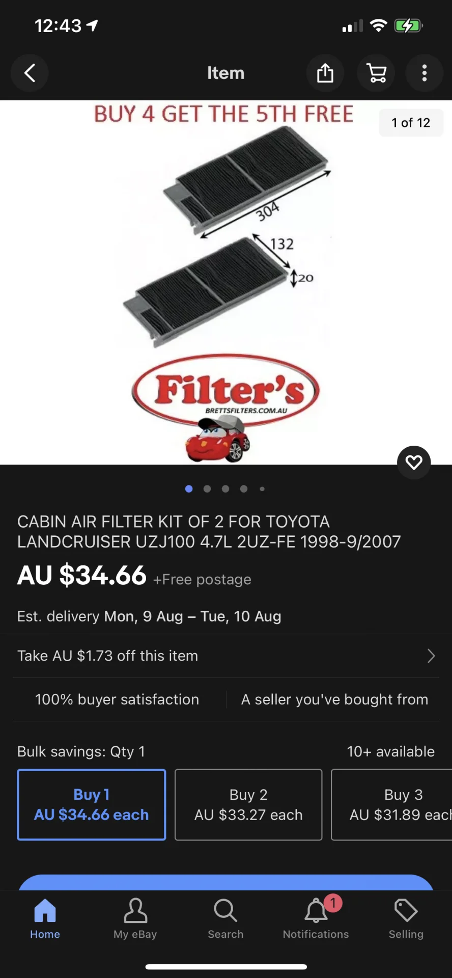

I cheaped out and bought these ultra cheap ones but they have worked fine.
CABIN AIR FILTER KIT OF 2 FOR TOYOTA LANDCRUISER UZJ100 4.7L 2UZ-FE 1998-9/2007 | eBay - https://www.ebay.com.au/itm/CABIN-AIR-FILTER-KIT-OF-2-FOR-TOYOTA-LANDCRUISER-UZJ100-4-7L-2UZ-FE-1998-9-2007-/133061015192?mkcid=16&mkevt=1&_trksid=p2349624.m46890.l6249&mkrid=705-154756-20017-0

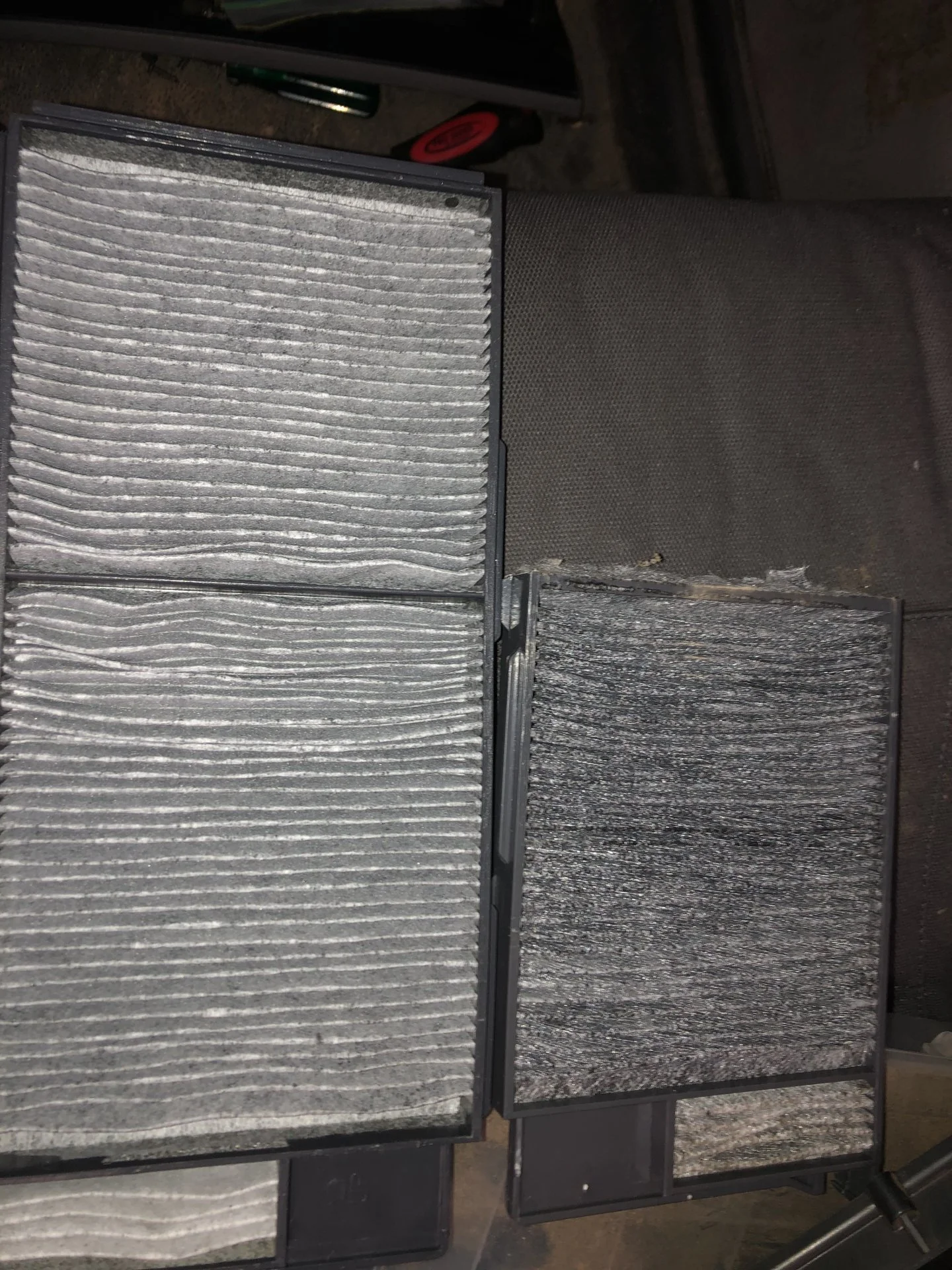

Hi Purchased a pair of these but they sent the ones with the long front section and short back section, not short front long back like in the photos . Unfortunately I did the cut before I realised as you can see from the photo.. so it is to long to fit in the filter box :(

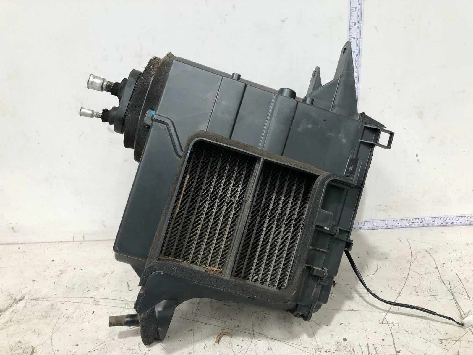

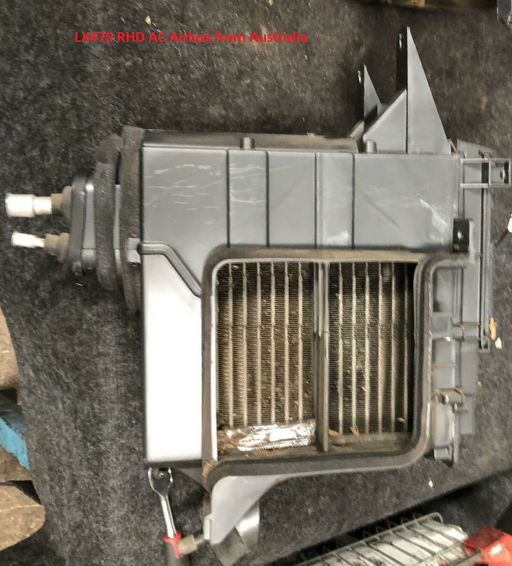

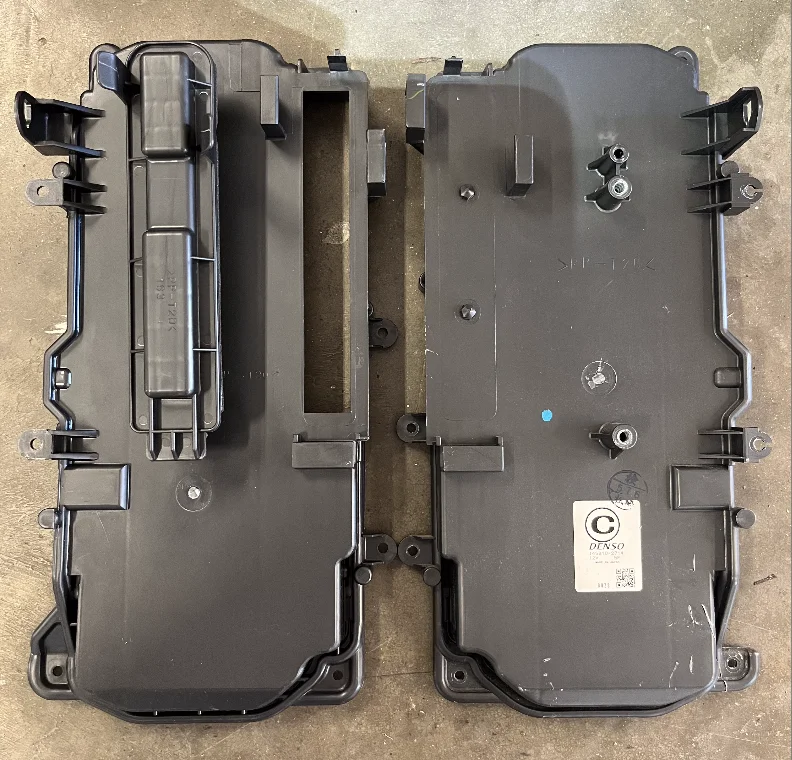

Some interesting photos comparing the airboxes were the filters fit of various models... There are two airboxes from Australian delivered ' cruisers and one from a US delivered lx470. It clearly shows the difference between the US delivered lx470 that came with the filters vs the Australian delivered vehicles ...
Question ... did any Australian delivered 100 series 'cruisers come with a factory cabin air filter or had a factory air filter available ?
Firstly from a RHD LX470 in Australia (Photo from Toyrolla wreckers add).. You can clearly see it has the access port to insert a filter...
Did this have a factory filter as the filter slot does not go all the way through ? If it did I wonder what the part number was ?
Does this mean that when cutting out the divider in the Australian delivered models it makes no difference if you completely remove the divider to make it like the US lx470 ?
Or does the US LX470 have different routing of outside air and cabin air re-circulation from the Australian LX470 ?

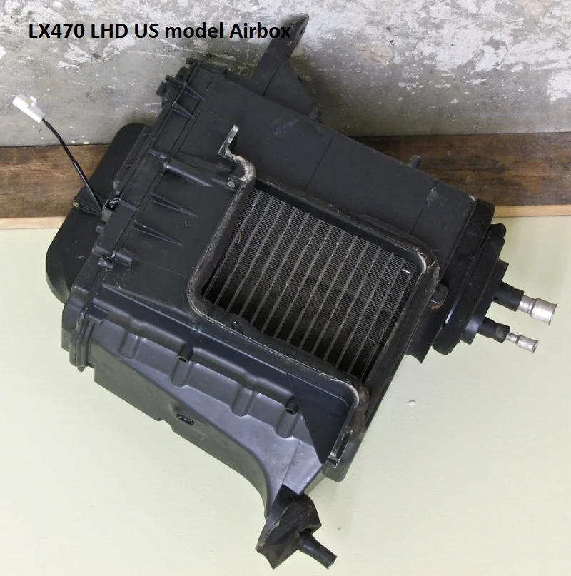

Lexus 470 LHD from US that had filters..You can see how the filters go all the way down... no divider (Photo from cruisermart add) ..
This is from a GXL 105 RHD... again it has the airbox divider similar to the RHD LX470. Not this does not have the access to insert the filter

Yep, that centre bit can be cut out with the evap in or out. But you need to be accurate or air will follow the point of least resistance and go around the air filter rather than flow through it into the vents. So happy to get the full filter in though. Air quality in 20 year old cruisers sux, especially if youve still got the old mouldy evap unit still in it ha ha haaa
Those Australia Evap box's you're looking at too with the centre section -- never ever had cabin filter manufactured/designed ever buy anyone in Toyota or the aftermarket business(s).

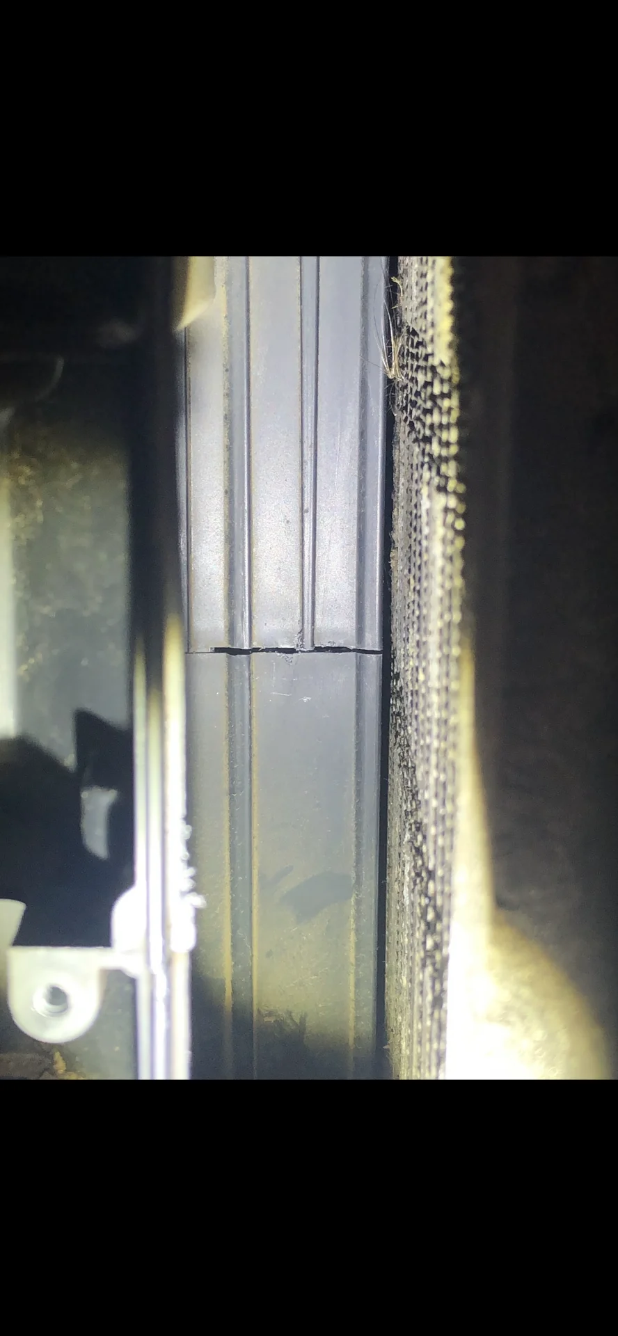

Yeah so I wish I had read this thread before ordering parts. I bought the parts that appeared to be correct on the fische at Amayama. They arrived after like 6 months of waiting and they are wrong. Part 88891-60040 is for a LHD vehicle. The cover is opposite hand to what is on mine (RHD Australia). No drama, as I just need to cut the hole in the one I have to fit the filters through and add the door since the cover I have has the tabs for the door to fit, just no hole. Wrong, as described above there is a divider that needs to come out.
From what I can see, the near side is for return cabin air, and the far side is the outside air path. Double bummer because the divder prevents cleaning of the outside air side!! I did contemplate cutting the divider out but not really sure how to go about that and no guarantee the filters will fit in once I do.
The good news, is the glove box is two bolts and out, then the bar is two bolts and out. From there there is obstruction to removing the cover unlike the other posts and videos showing it needing to be wriggled out from under the cross bar. So still considering if I try cutting that centre divider out or not. I suppose can't hurt since others appear to have done so and fitted the filters.
