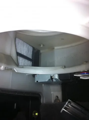

Great pic, Robred. Judging by that, I would guess that with a new cover with a slot, I could jam the filters in. It does not look like they are internally supported by anything. They seem to just sit flush against the square part of the motor housing. Interesting.
The parts diagram I don't get either. You can see the filter does seem to sit against the housing.
