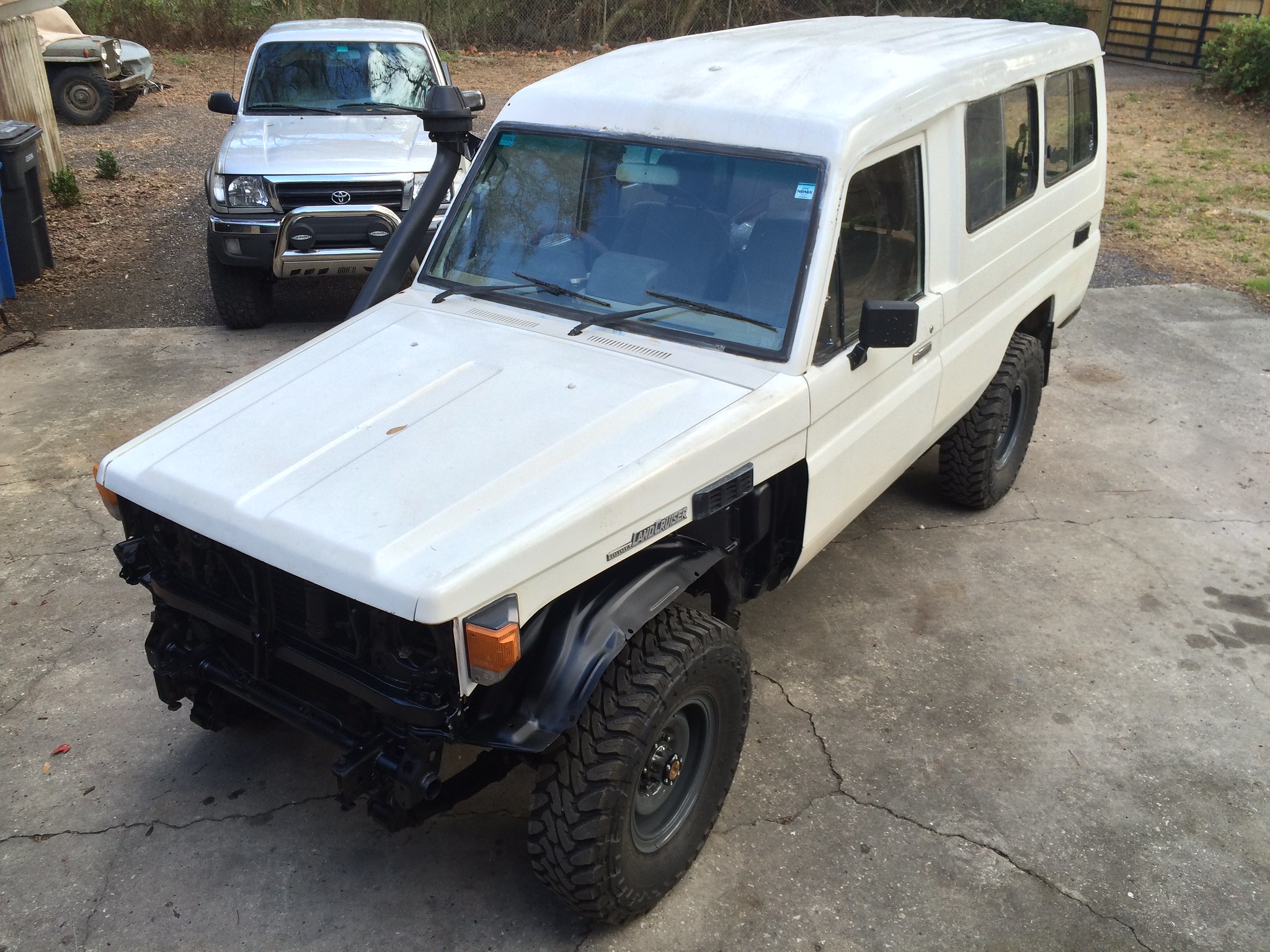

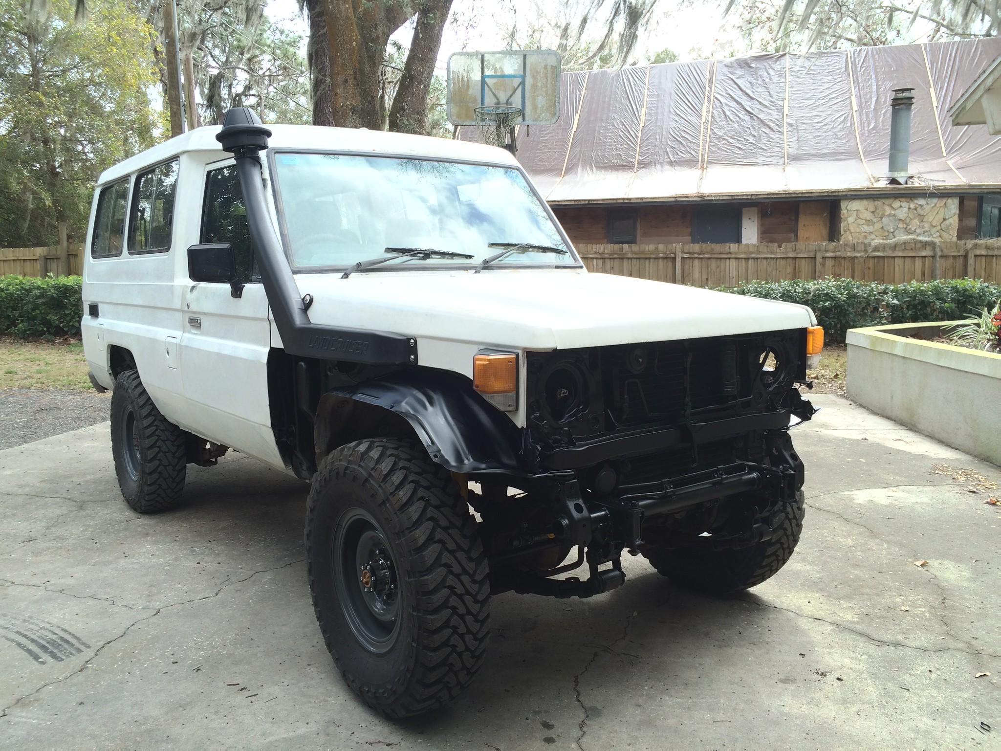

Started my snorkel install. Need to bring my plasma cutter home and cut the air hole and install some nut inserts to hold the upper bracket to the a pillar.
Also need to figure out the attachment to the air box. This truck previously had a snorkel as I found a welded in circular patch on the inside of the fender. The air box has a straight pipe heading right for the fender so it should be easy to plumb.

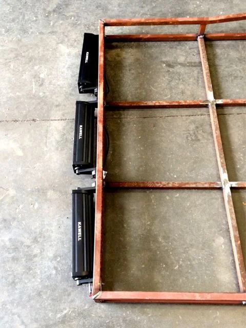

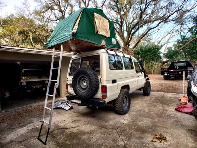

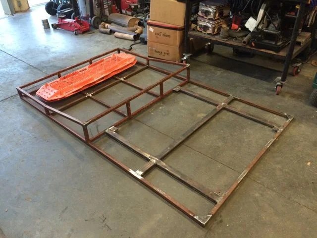

And I did some more modifications to my rack to hold both my max tracks and cut the back section off to hold the tent. I'll add the light brackets tomorrow and some expanded steel mesh to the front part too.
It's a one piece knock off. Haha. I still like the way it looks :)
With my advanced age and poor eyesight, I hadn't noticed the absence of the joint. :)

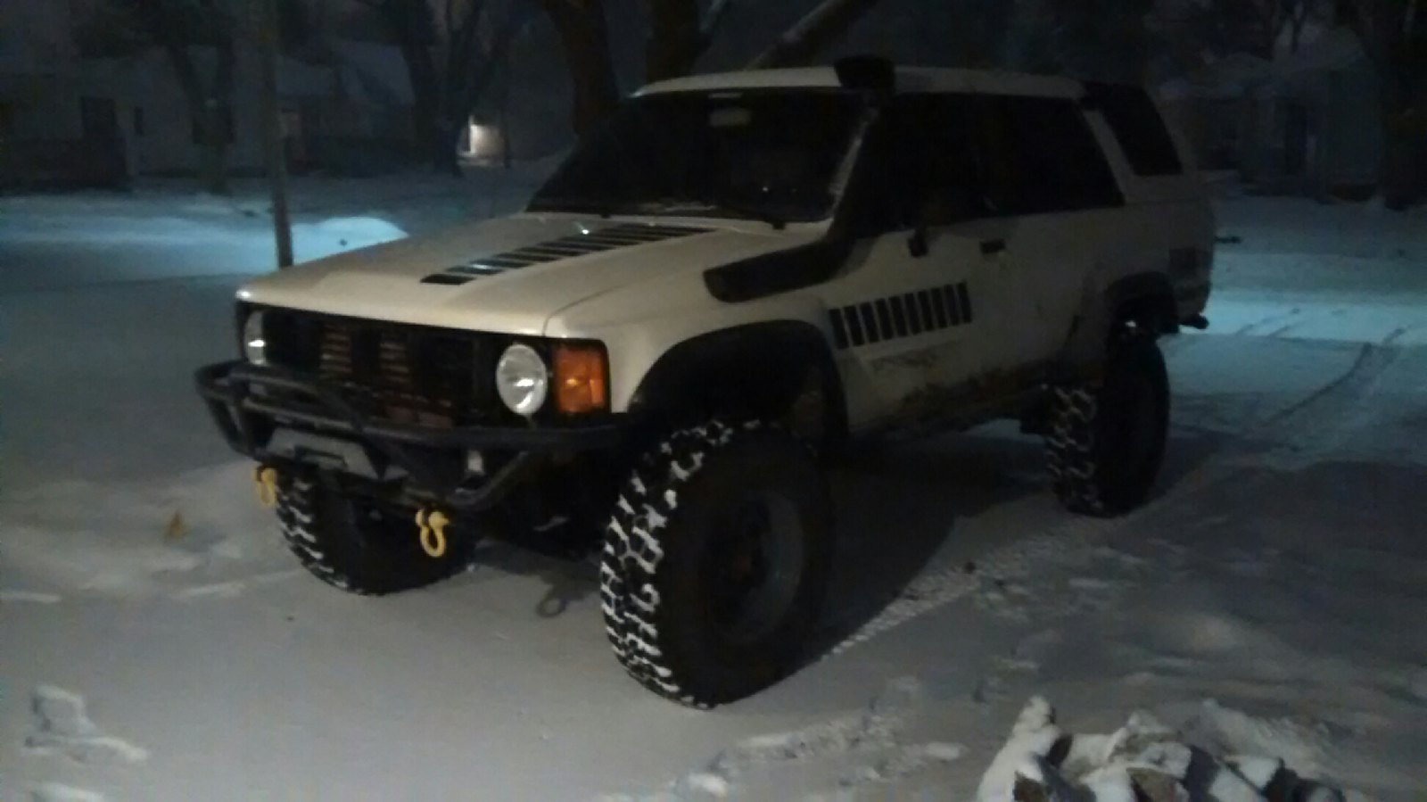

Made a little progress on the troopy, but the big news lately is I sold my 1st gen 4Runner. Really cool guy flew down from Iowa and drove it home. Made it through a blizzard :) I really loved that truck, but now I should have the funds to finish the troopy :)

Back to the build, got the inside of the fenderwell painted black, along with the front behind the grille.

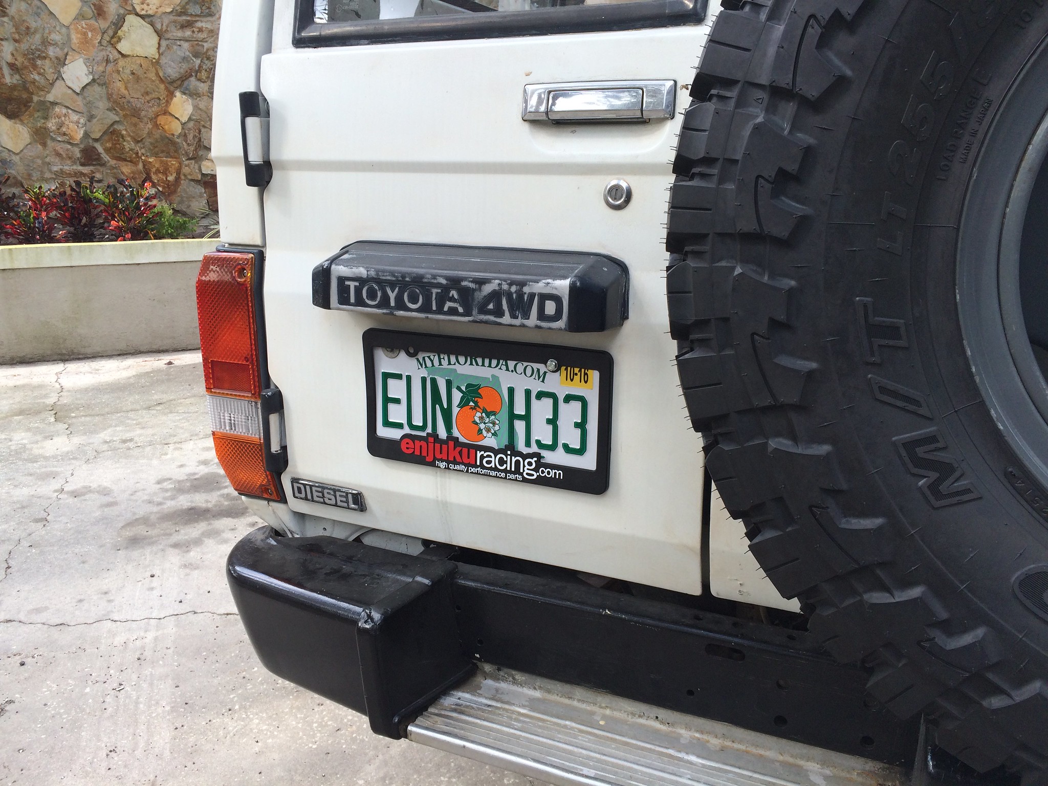

What do you guys do with license plates? The holes don't line up with American stuff :( I don't think it looks terrible, but I don't love it either...

In Georgia (the State that Onur hates), we just use bailing wire to attach the license plates. :)
