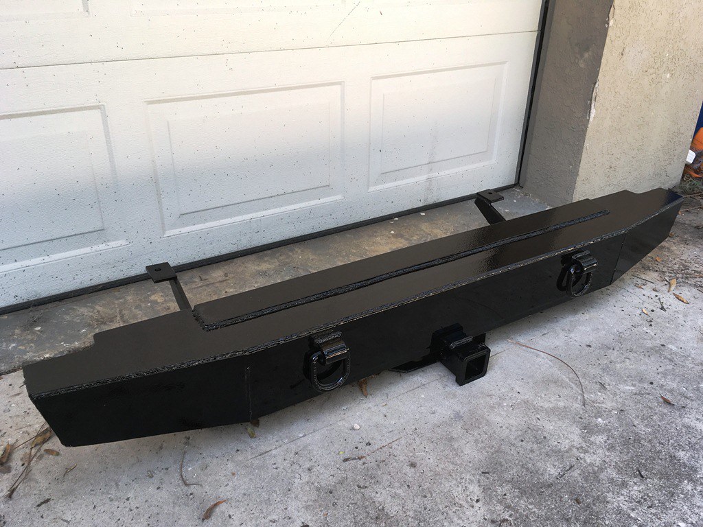

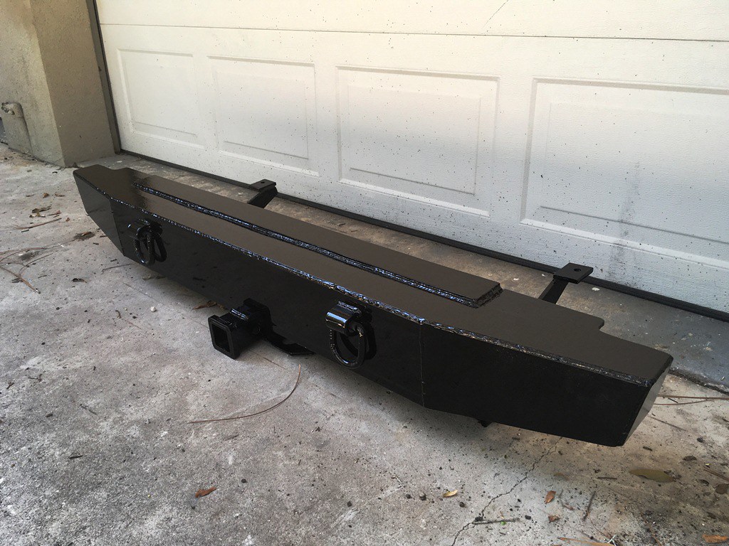

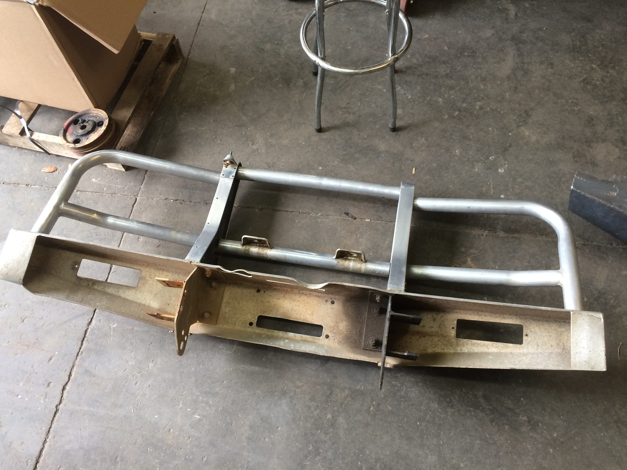

Front bumper, rear bumper, side steps, and roof rack will all be tentatively done in matching black bedliner. I'm on the fence about possibly doing everything in a dark gray bedliner that matches my wheels. Black is definitely a more "classic" look I think. Gray could end up looking really cool or it could end up looking too "matchey" for my taste... for lack of a better word.
@61Mk+ did a nice job of color matching all his bumpers and wheels and sliders. I really like the way his truck turned out, but I'm still on the fence about it. I need to finish some things on my roof rack still, so I have some time to decide.
My front and rear bumpers are black as well as the side steps, rear ladder and roof rack. In my opinion, it's hard to beat black.
I have all black, its a safe and easy option, but when i paint mine dark brown, I'm thinking of doing all barwork the same colour. I have seen white troopies with white barwork/wheels and it looks smart. If i don't paint it brown i will be going all white. In Australia there seems to be a trend of matching barwork to body colour as well, for example i think ARB has off the shelf colour options on barwork to match common modern vehicle colours. Food for thought.
I am in the process of making this decision too. My car will be white.
I am thinking either graphite p2 (sorta metalic gun metal grey) or black for the front bar, back bar, sliders, rollbar.
As Damien said black is a safe easy option that is tried and tested, but I wonder if I'm just being lazy and taking the easy option?

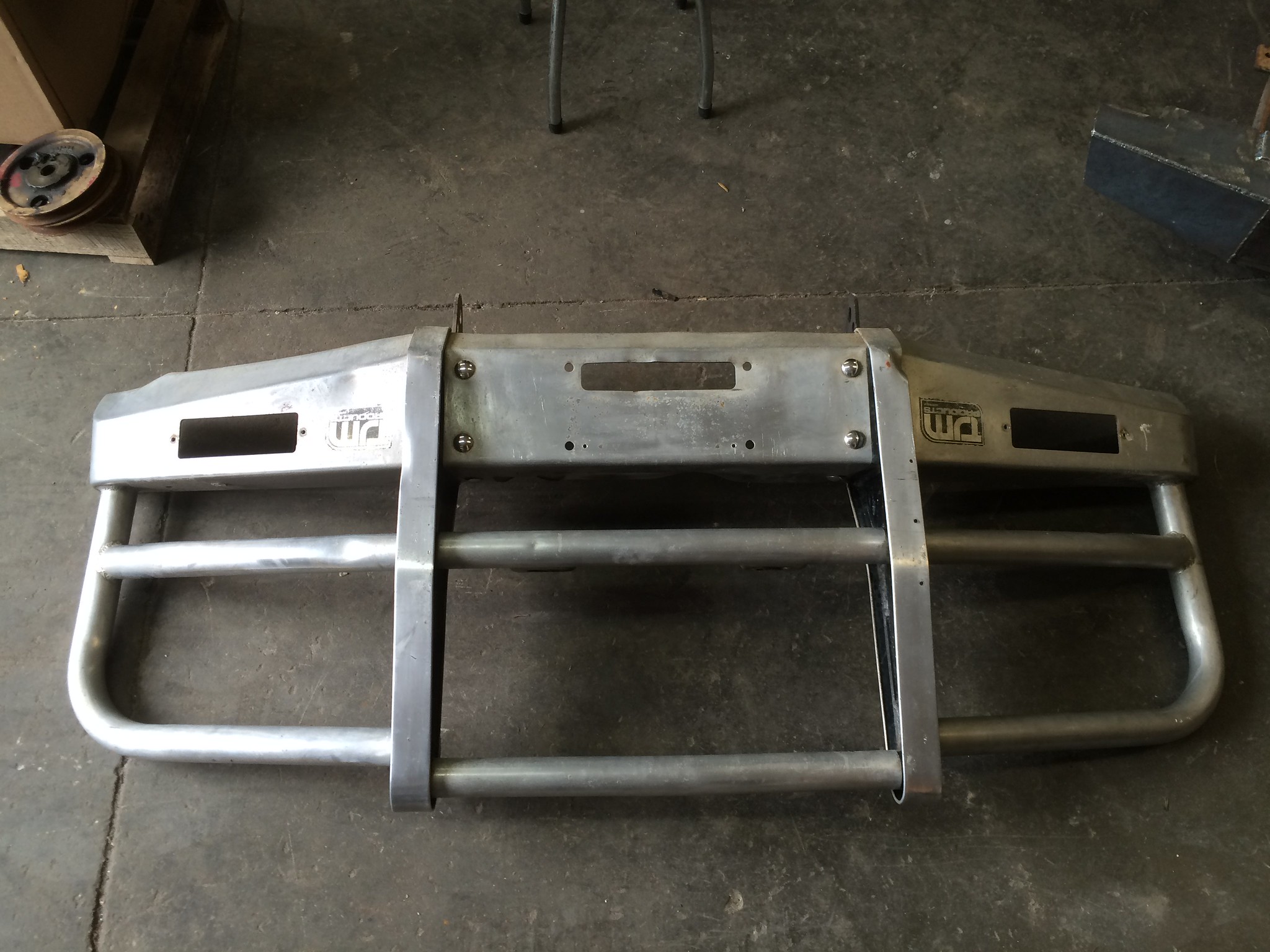

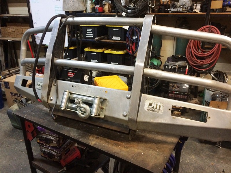

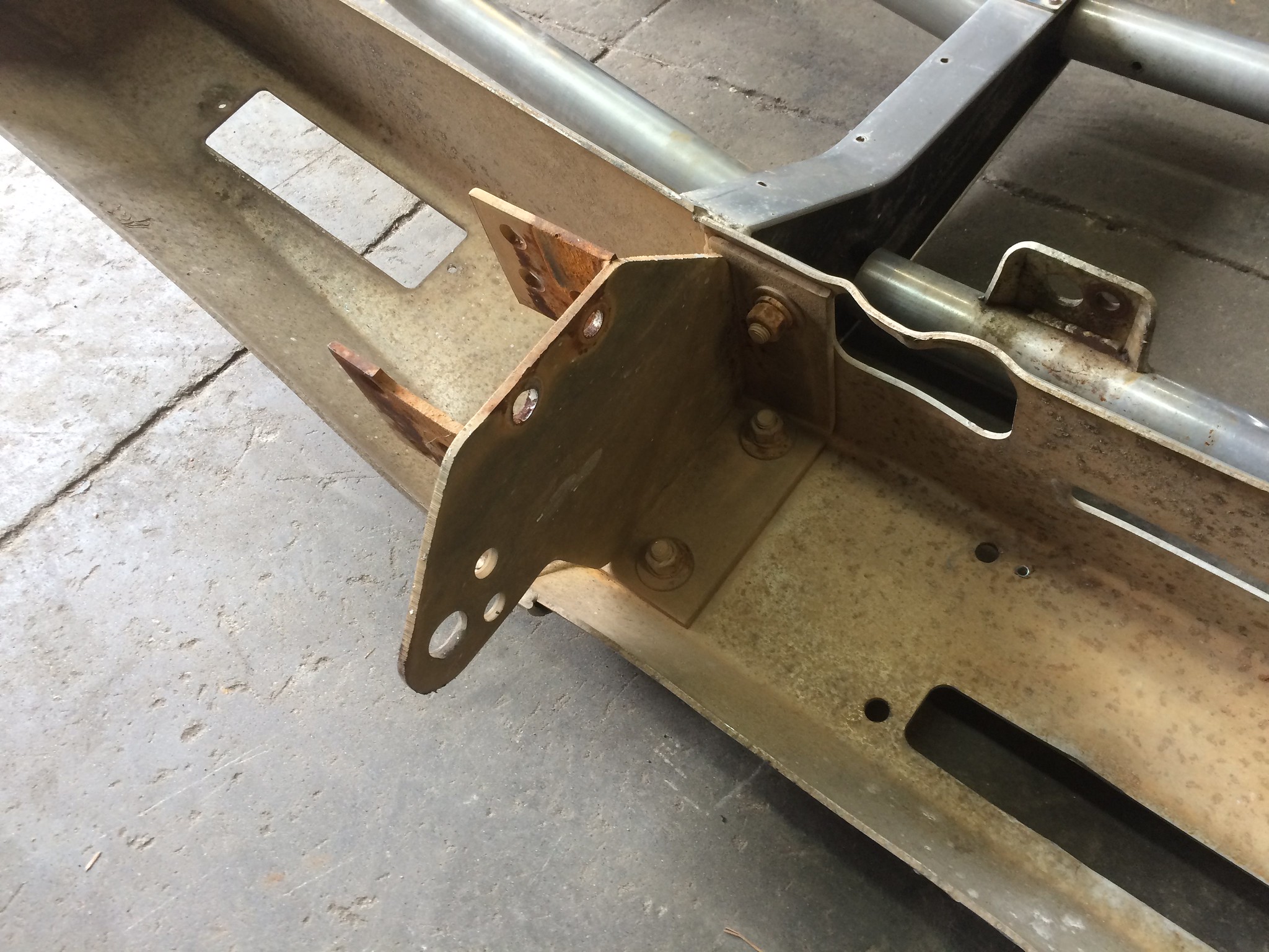

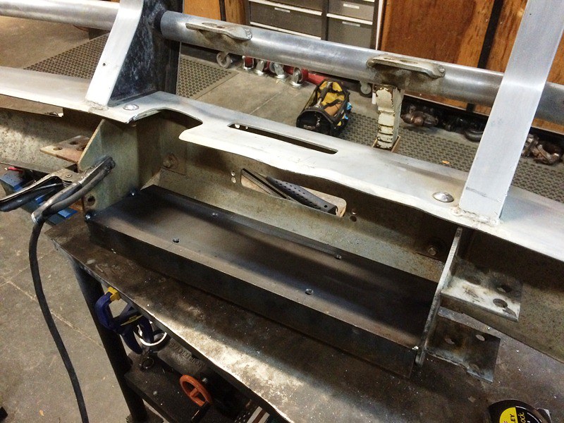

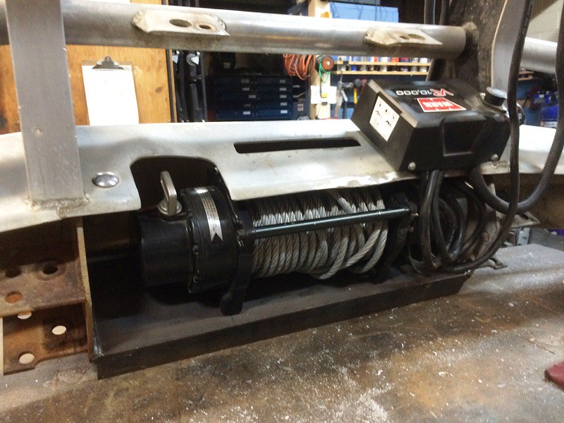

Oh, I forgot! I did add a winch tray to my TJM bumper. It's just 7 inch C-channel welded between the steel bumper mounts. The bumper itself is aluminum but the mounts are still steel. I test fit a Warn VR10000 I had at work, but I will be running an M8000. The VR's work well on our F550 drill rigs at work, but they're not doing extended pulls. Typically just a couple feet out of a mudhole. They get hot quick, but they've been a great budget winch for infrequent use applications.
