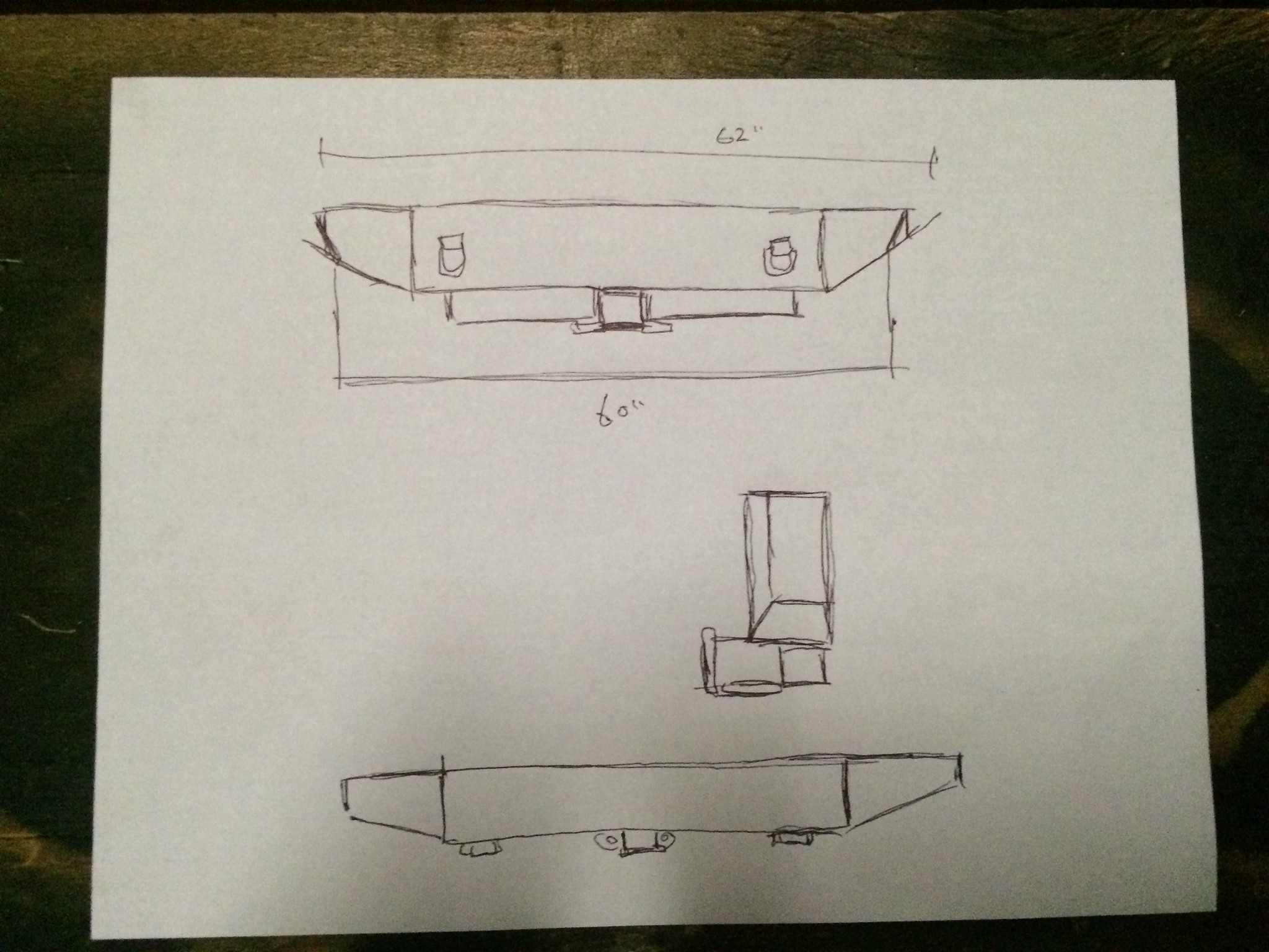

Made good progress on my rear bumper today. Started with a sketch.
IMG_9467 by CA18 Sean, on Flickr

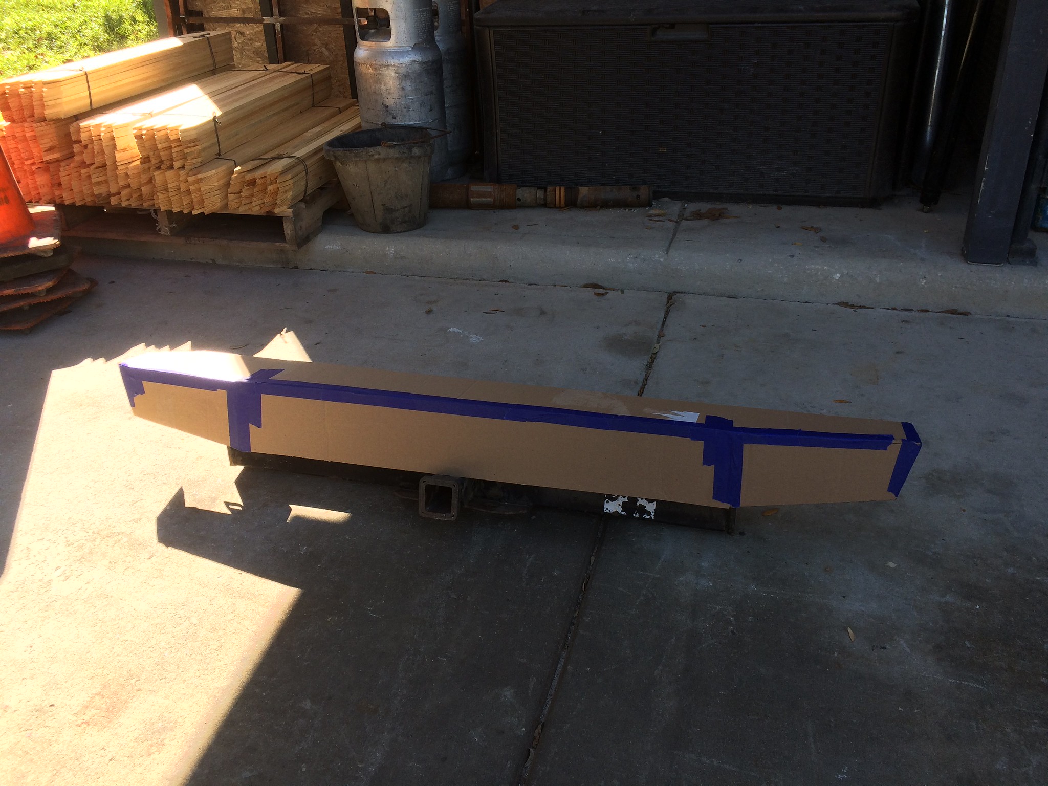

Then a cardboard mockup. I'm using the reese hitch that came with the truck as my base to attach to the frame.
IMG_9469 by CA18 Sean, on Flickr

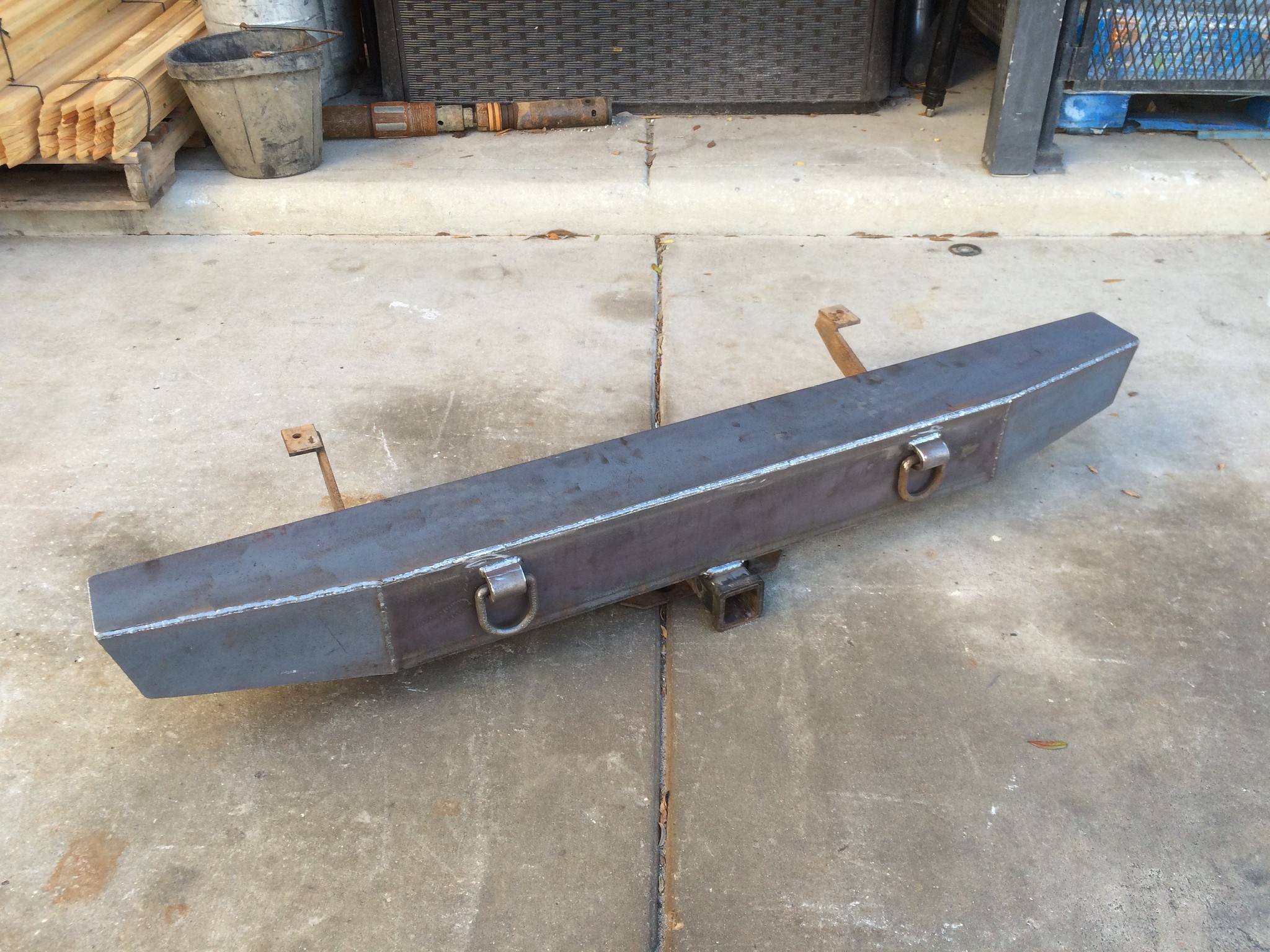

Tacked together.
IMG_9482 by CA18 Sean, on Flickr

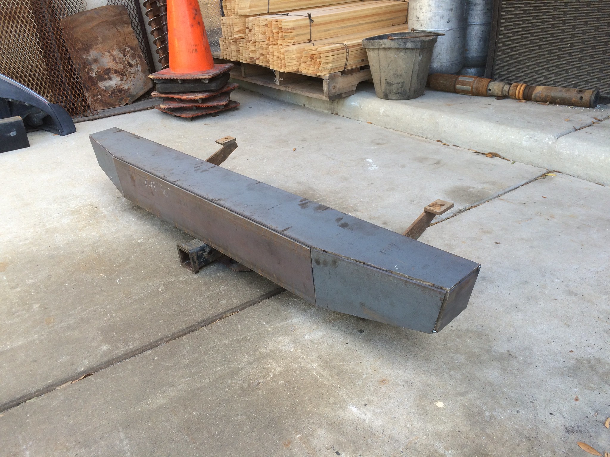

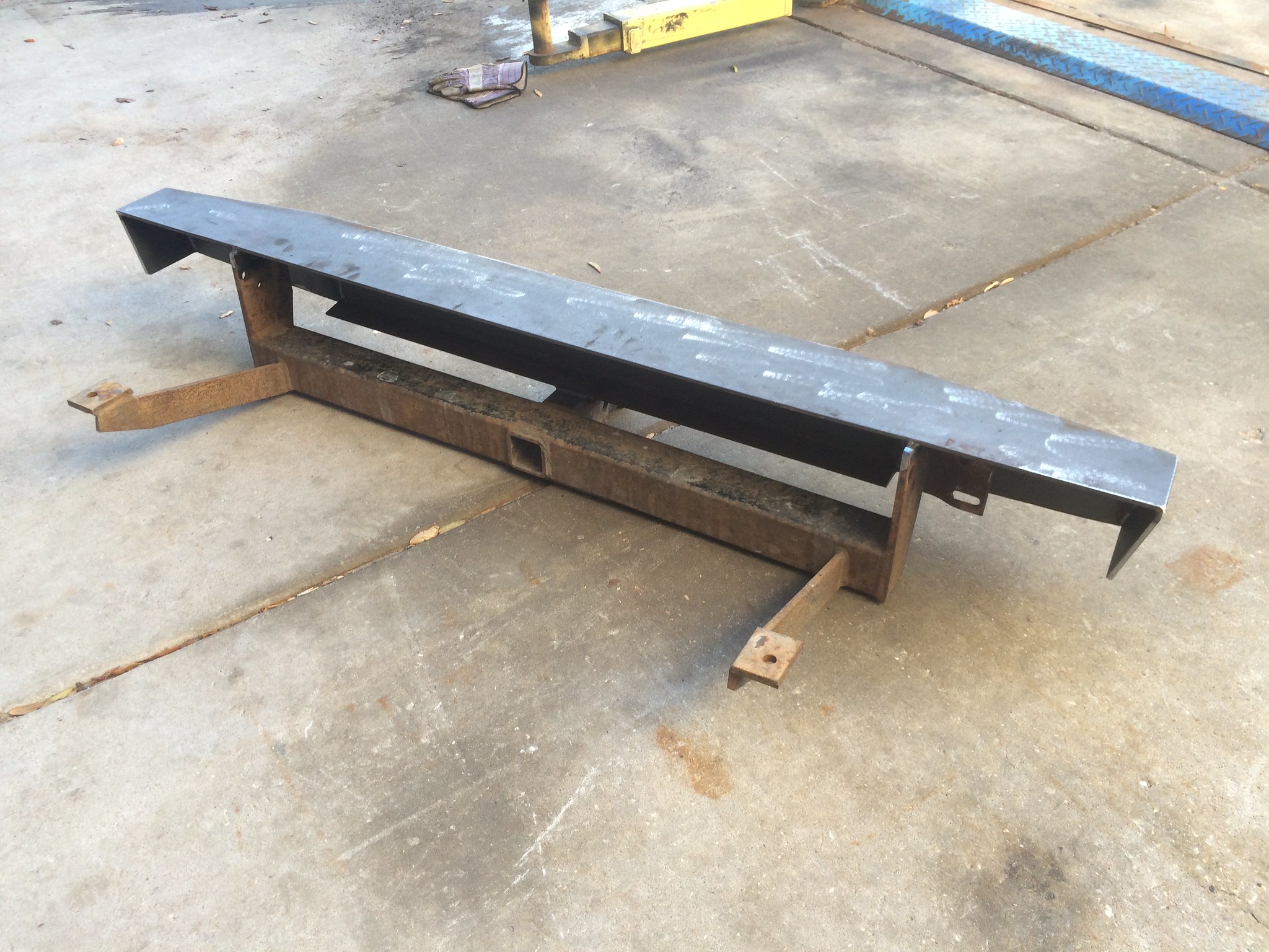

All welded up. Gonna head home and test fit now. Hopefully my measurements were all correct!
IMG_9484 by CA18 Sean, on Flickr
IMG_9485 by CA18 Sean, on Flickr

Looks nice, very clever way of using the hitch as the frame mount!
Thanks, it worked out pretty well. Need to make some more slight adjustments, and I had to trim some around the taillight area. Still need to clean up my cuts, but I'm happy with how it's turning out!
