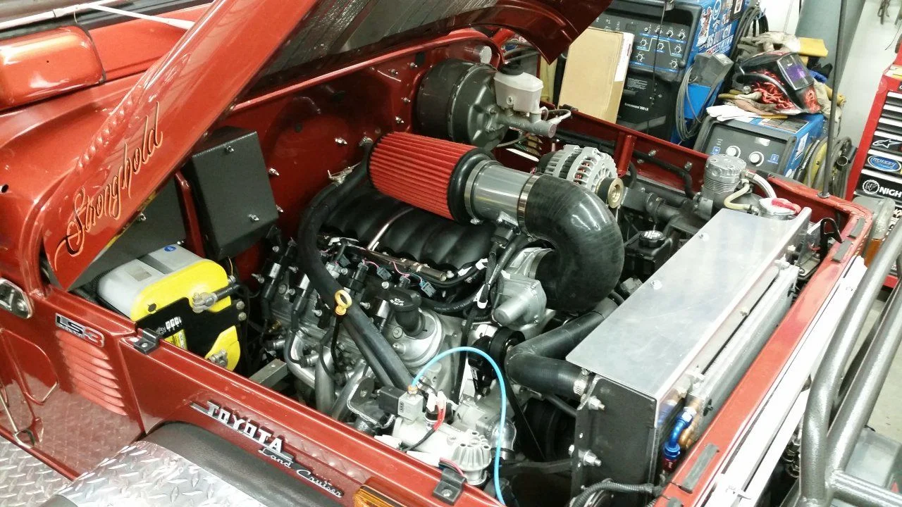

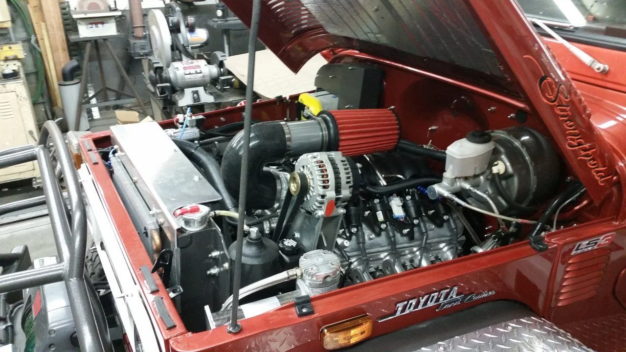

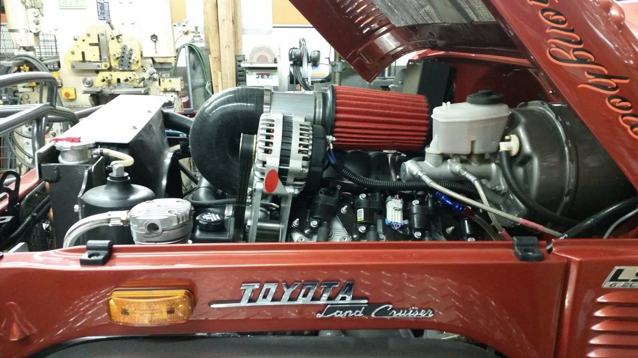

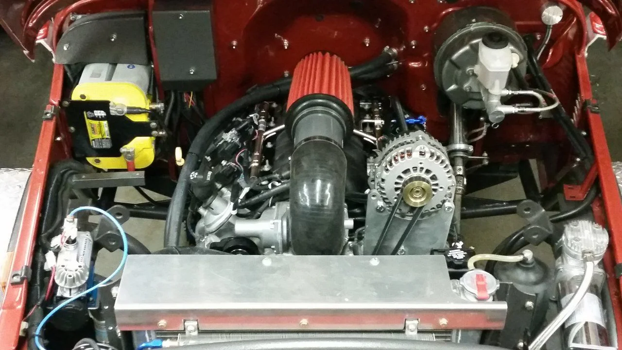

The air filter looks a little corny, but will have to do for now. Mounting the battery in an upright position is my next task.....the last pic is a total poser pic, but for the flatlanders, a little inspiration to wheel the San Juans.

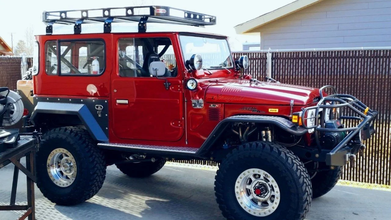

few new goodies..Got some new tires and wheels, the 17's E rating aided in highway manners, along with Powertank monster valves.....LED headlight upgrade and oem Toyota front signals with LED's. Dumping the spare tire for a tube set up, and a slide out tool tray in bed area
Thanks guys !! They are 37" x 13.5" Toyo Open Country M/T....sidewall E rating on Trail Ready 17" x 8.5"......I HATE the time wasted in airing down at the trailhead and have no affiliation with Powerttank but their Monster Valves are freakin awesome.....from 58lbs to 12lbs in 28 seconds...WELL worth the coin in my opinion
i forgot to mention that i went with 4" b.s.....this required Spidertrax 1.5" spacers. these are temporary until the Dynatrack 60 come in.
