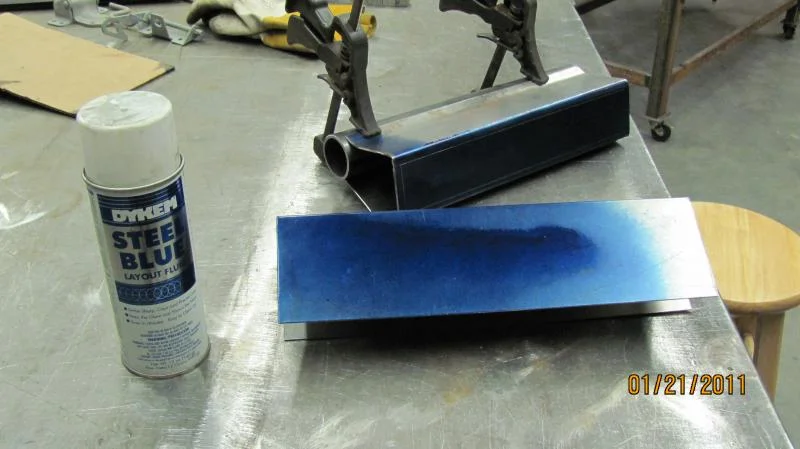

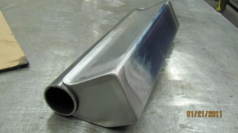

Bent, cut and welded this 16gauge switch panel, as there was no other place to put them. Mounted the panel on the cage, at first i though it was a little gawdy, but for practicality reasons, it grew on me. Easy to read and reach.

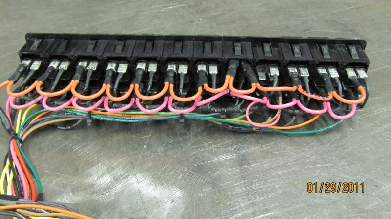

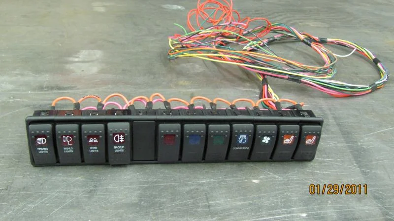

Here is the swith layout, switches from OTRATTW.com Great quality connected to wiredwagon.com relay box. The layout has changed since pic, but you get the idea.
