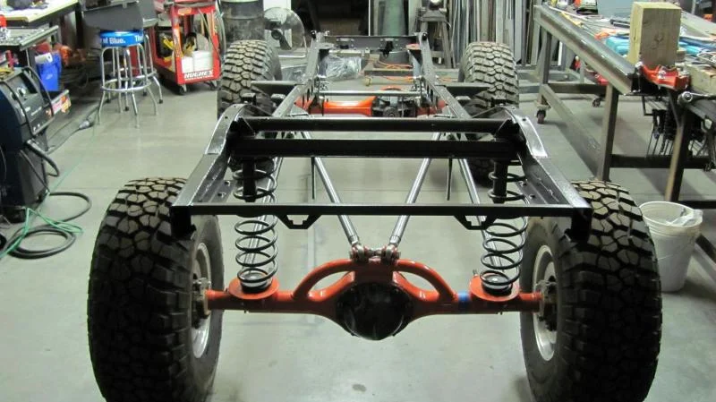

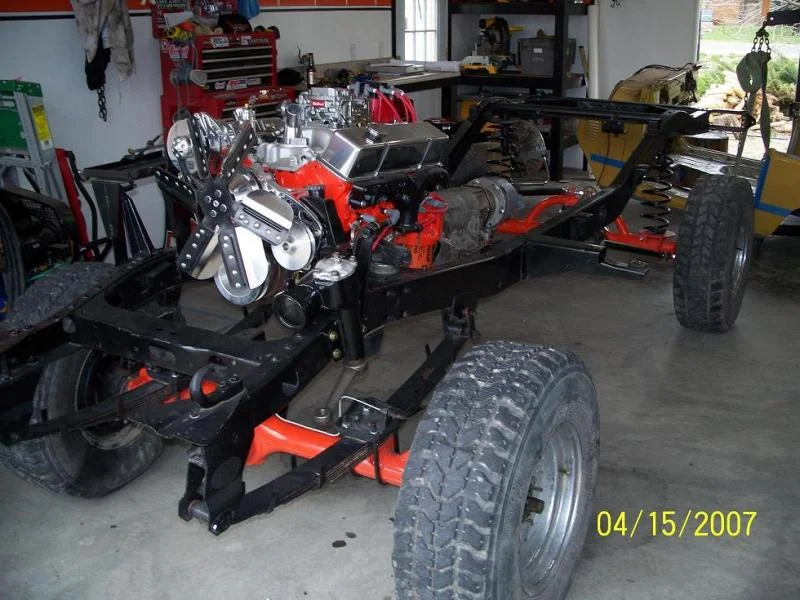

got the frame back from Proffitts with the coils in rear and SOA, in the meantime sandblasted and painted frame

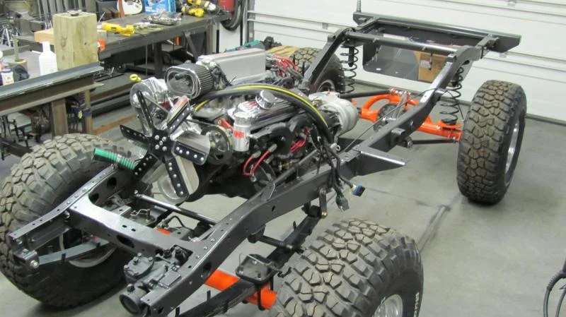

Prior post is how everything stayed for 2.5 years with small changes and additions done inbetween work and life!!. Below is how it sits from getting frame blasted again and powdercoated as of last week. Being i was this close, it was senseless for me not to take the time and a few hundred bux to not go the extra bit and coat the frame, as i have stared at this for so long debating if i will ever have to weld anything else to the frame, coating was a great choice.
First pic is of the frame, then next night with rears in , then Ram Jet, with brand new Hughes Trans and 3.8 Atles. Extended the frame 8 inches in the rear, being the wheel base was extended with the 4 link, dropped in a 20 gallon cherokee tank, and homegrown bumper.

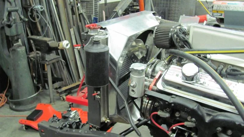

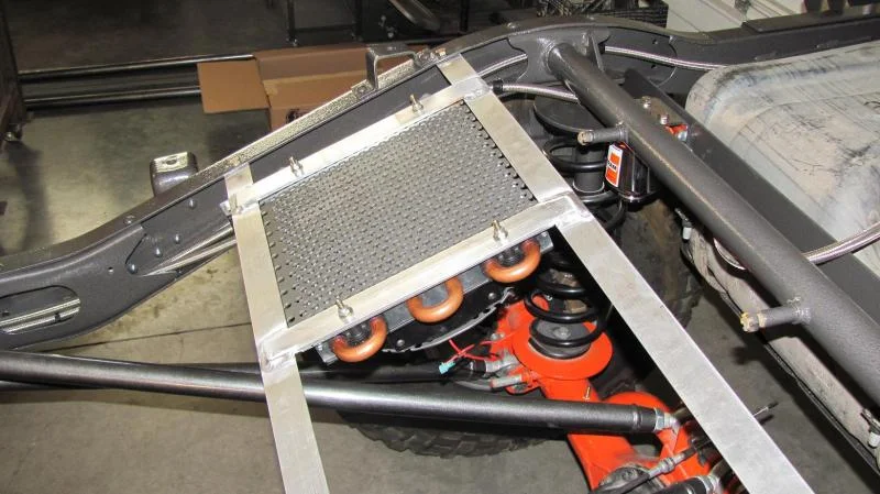

finished up the homegrown radiator bracing and shroud.....then plumbed up oil cooler, power steering lines..............then finished up trans cooler bracket and lines

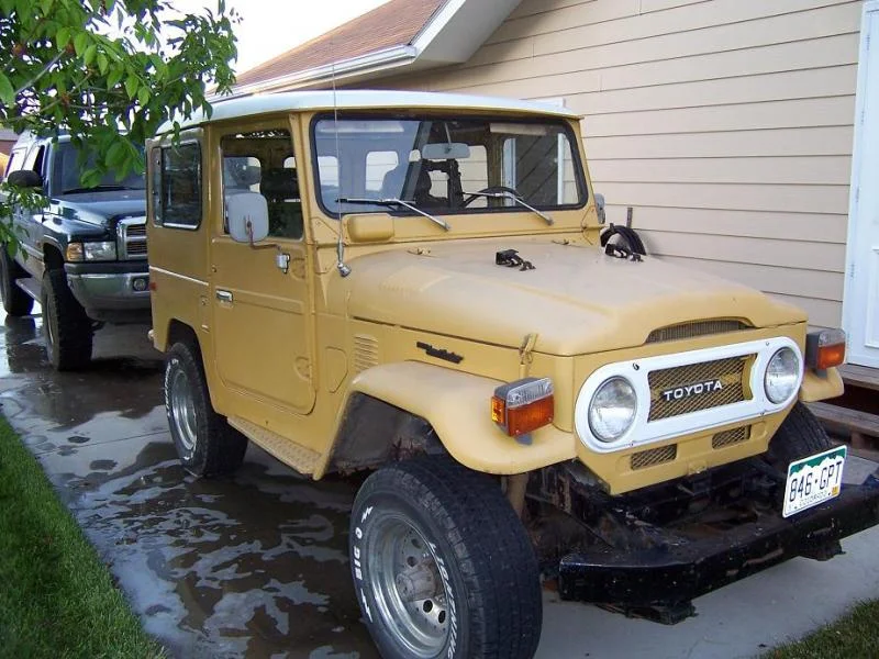

NICE WORK. I see the PO had the bezel upside down. I know that you know better than that.
ya know....this my 7th cruiser and until i started toolin around on MUD, i never even noticed. "DAMN THOSE EYES!!".thanks, it'll be right when i get the tub back

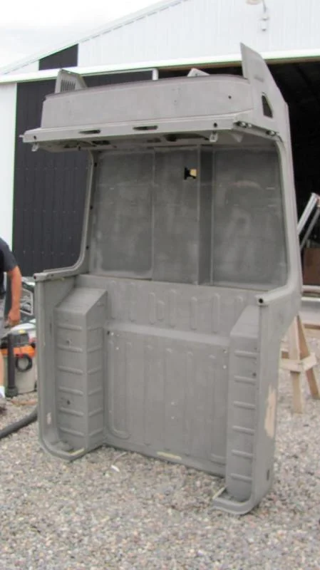

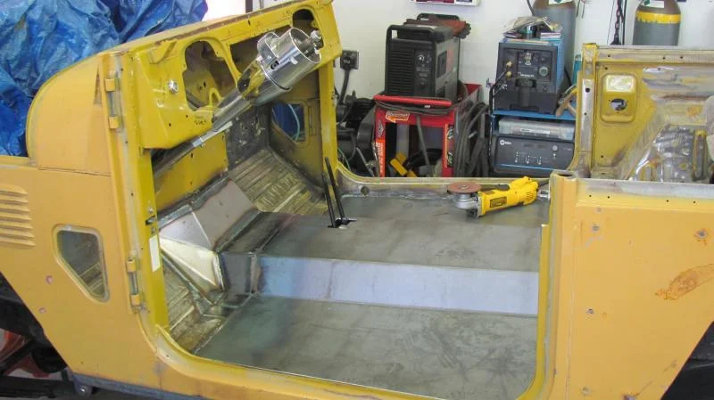

Cut the old floor out and re-did my tunnel. .then welded in all unnecessary holes in firewall............then to sandblasters.

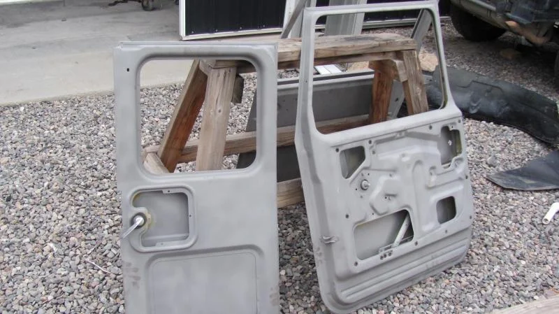

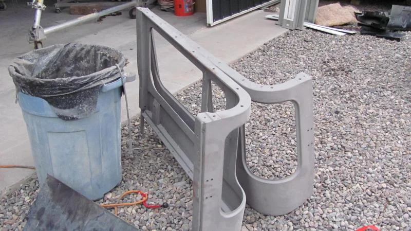

All four doors and cap sides got the same treatment awaiting paint as we speak..........hopefully should have tub back end of next week....then get the inside and underneath Rhino lined.

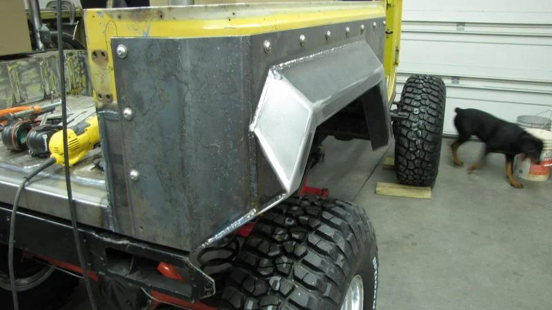

Question. It looks like you followed the existing lines on the rear frame channels, and the backspacing on your rear tires looks aweful close to frame rubbing on compression. Do you plan to limit up travel, change backspacing, or???
Best
Mark A.
Yeah...i see what you're lookin at, must be the way the camera took the pic. From where the frame continues rearward from factory, rails runs parallel to bumper. Tires should clear frame under full compression by 2.5".
That straight up and down clear, or rocking up AND IN clear?
up and in, i compressed just one corner to make sure.....good eye Mark!!
