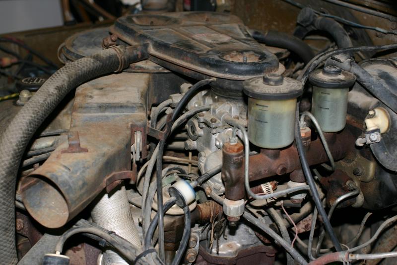

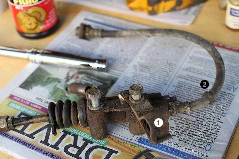

Replacing the 34 year old (note the ring - #2) hose and slave - should have done it when I replaced the master - as lostmarbles recommended.
Anyone know if anything goes through that clamp/guide (#1)? I don't see anything around the slave that looks like it threads through there?

Theres normally a bracket in that location that is for holding one end of the return spring for the clutch fork. Maybe someone lost it and replaced with that?

The return spring bracket is there, just hidden behind the bolt on the left. In fact the end of the spring on the left is hooked in to it. Funny thing too is that #1 clamp looks like it's made from copper or maybe brass, need to clean off the crud to tell. And it looks original...

If that is a factory bracket then by the looks of it it holds a rubber hose of some sort as it has a rubberized end for low friction as seen on other areas under the hood. The only thing running in that general area thats rubber are the fuel lines, both coming and going from fuel tank. But they usually run more on the frame side.
