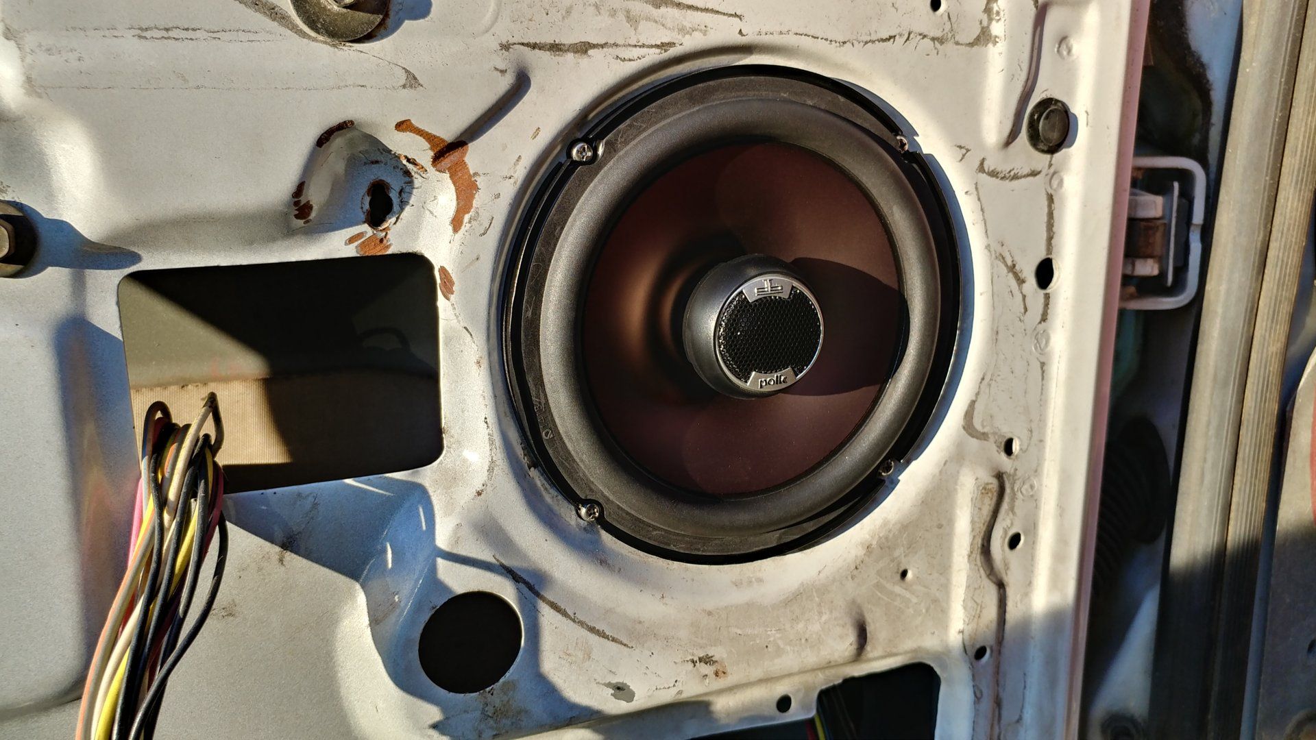

Well plan "b". I started fiddling with the components and decided that getting those in along with the amp and all that wiring was way more than I wanted to fool with, especially when it is 90°+ outside, so plan "b" it was.
I had a set of Polk 6.5" DB651's in my stash, so I decided to just bolt those in the holes. I pulled new speaker wire from the head unit to each side since the old PS speaker would come and go.
So now we have tunes all around. Hopefully the head unit is good. I believe the overtemp circuit cut out on it and since it has cooled down it has worked fine. We shall see.
