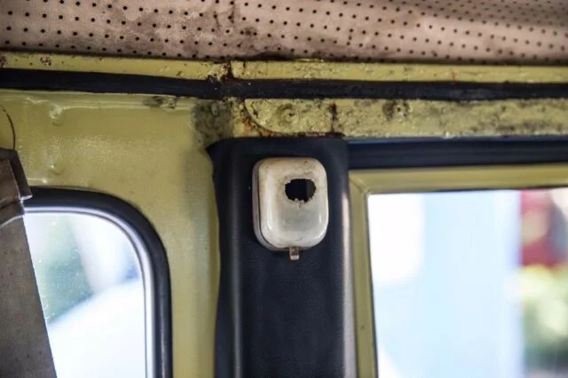

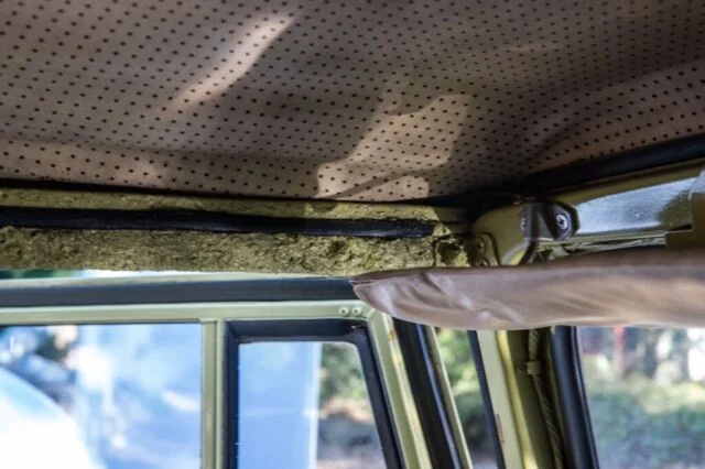

  2. The top has horrific rust. It looks like the seams in between the roof (steel in LatAm models, I believe) were bad, water got in there and it just sat. And sat, and sat.

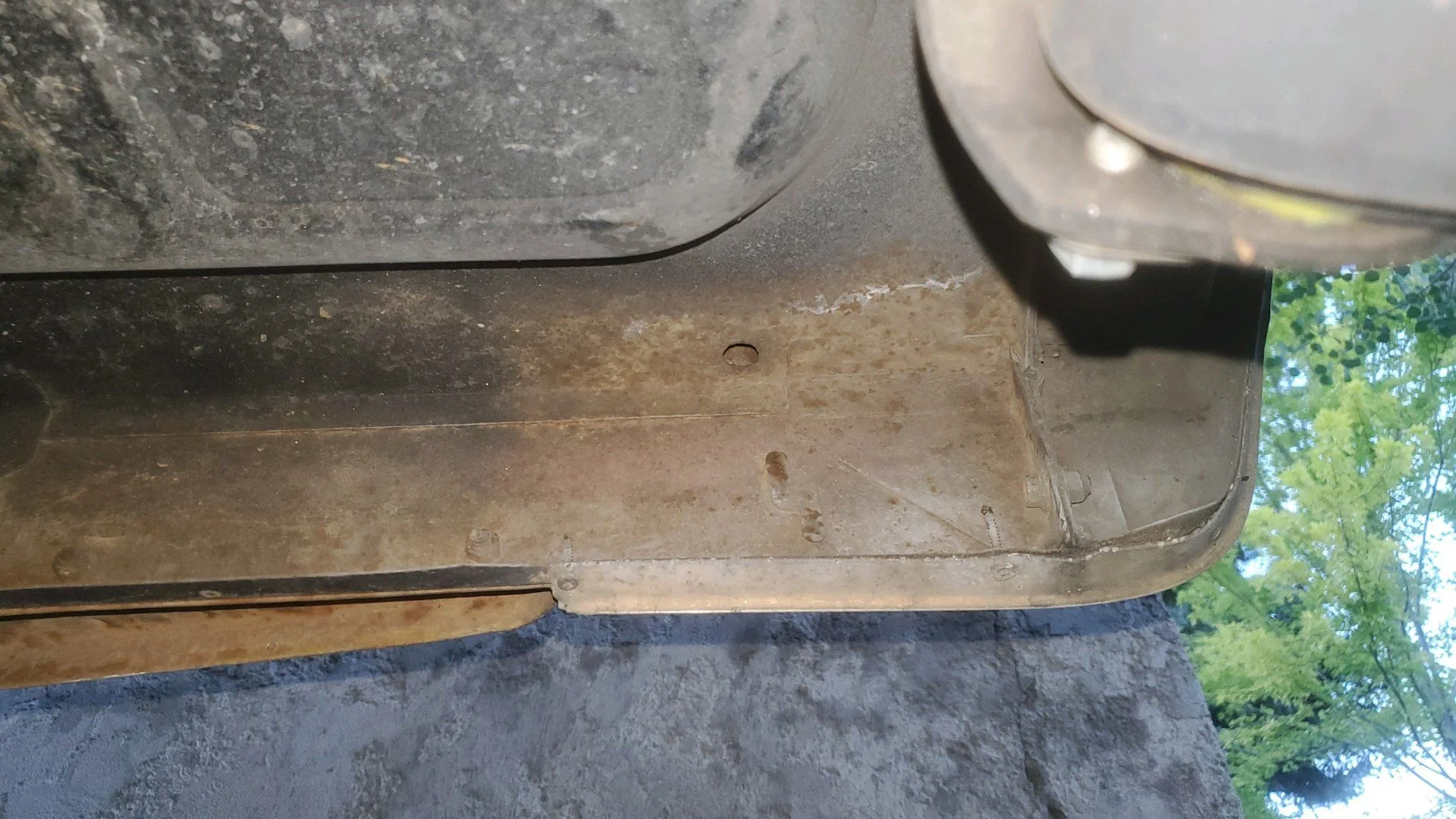

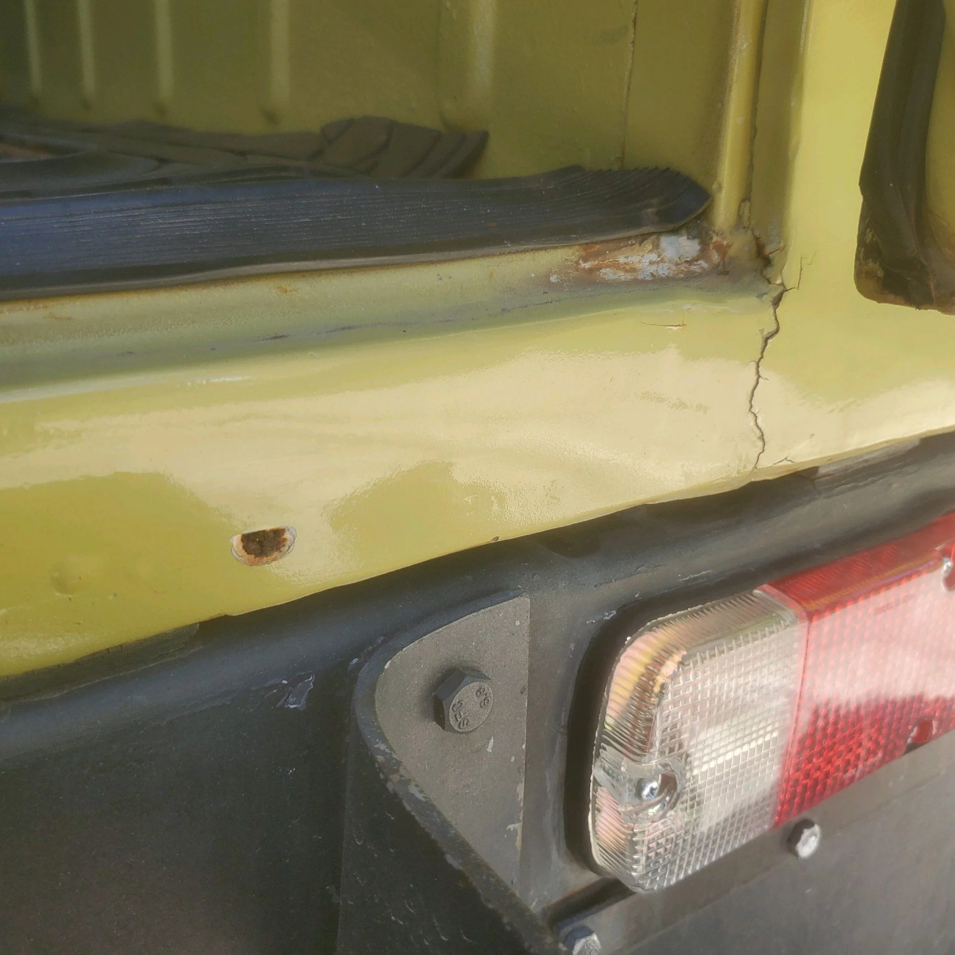

  4. Rear sill repair starting to bubble.

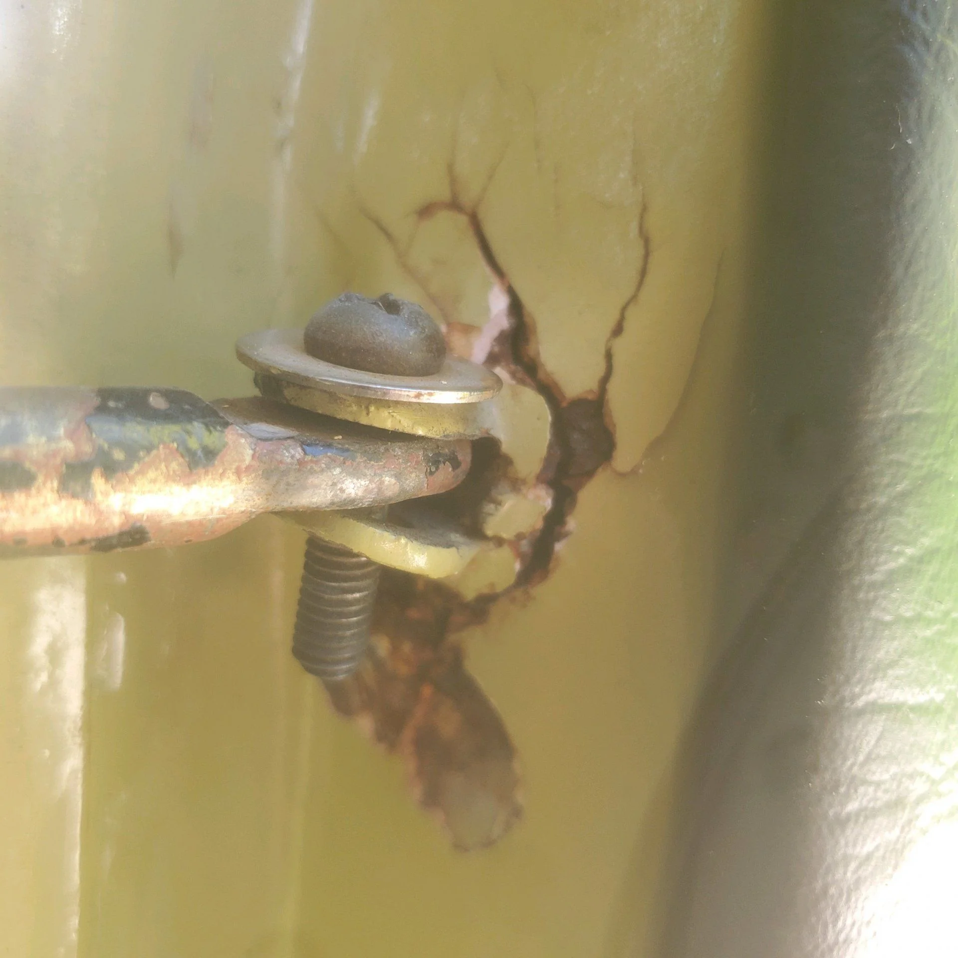

  7. Door stopper on passenger door compromised.

  9. Fix passenger side door stopper.
  10. Start uncovering rust on rear sill and elsewhere to stop the spread now and correctly.

  15. remove and repair top. Needs all new gutters and thorough, proper rust repair.

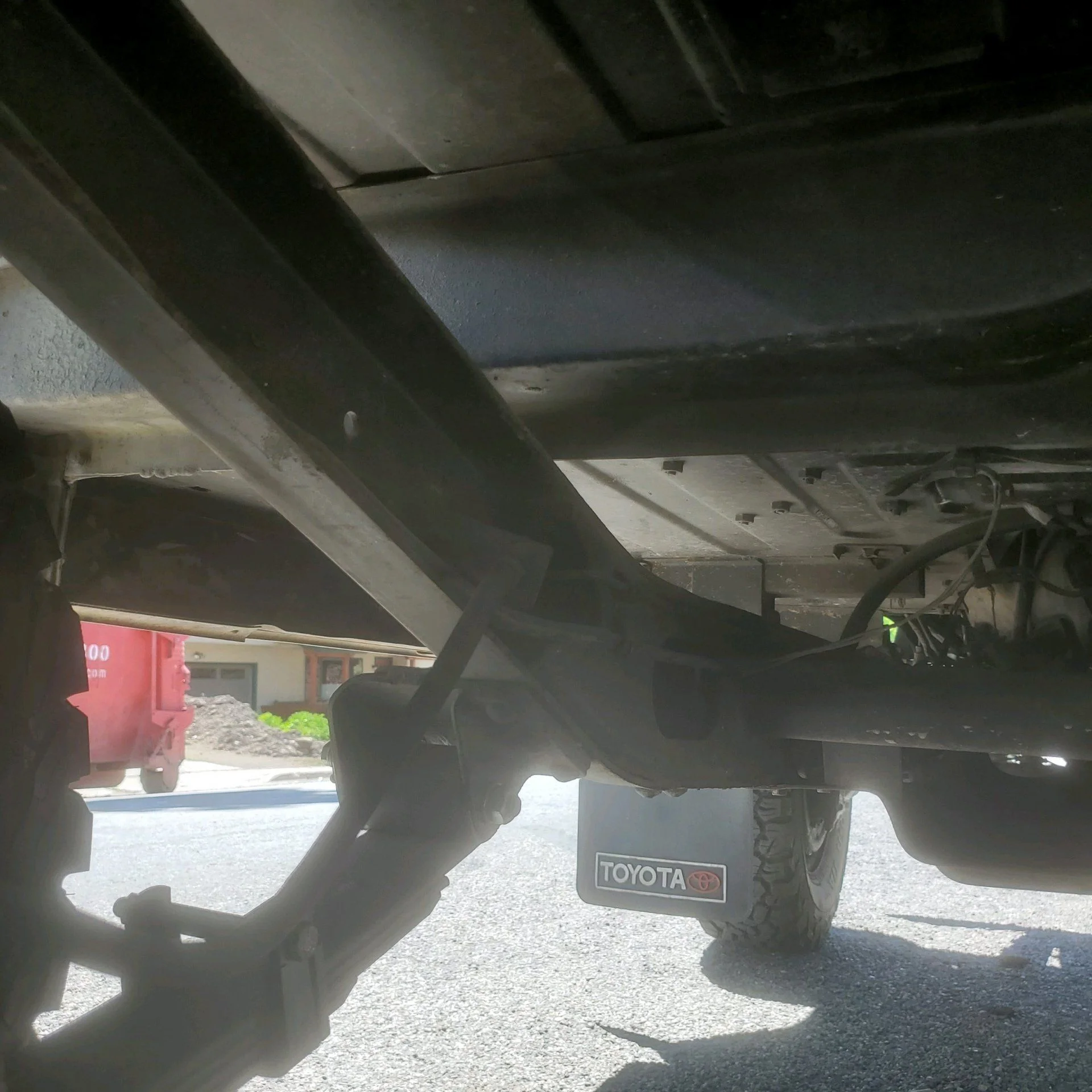

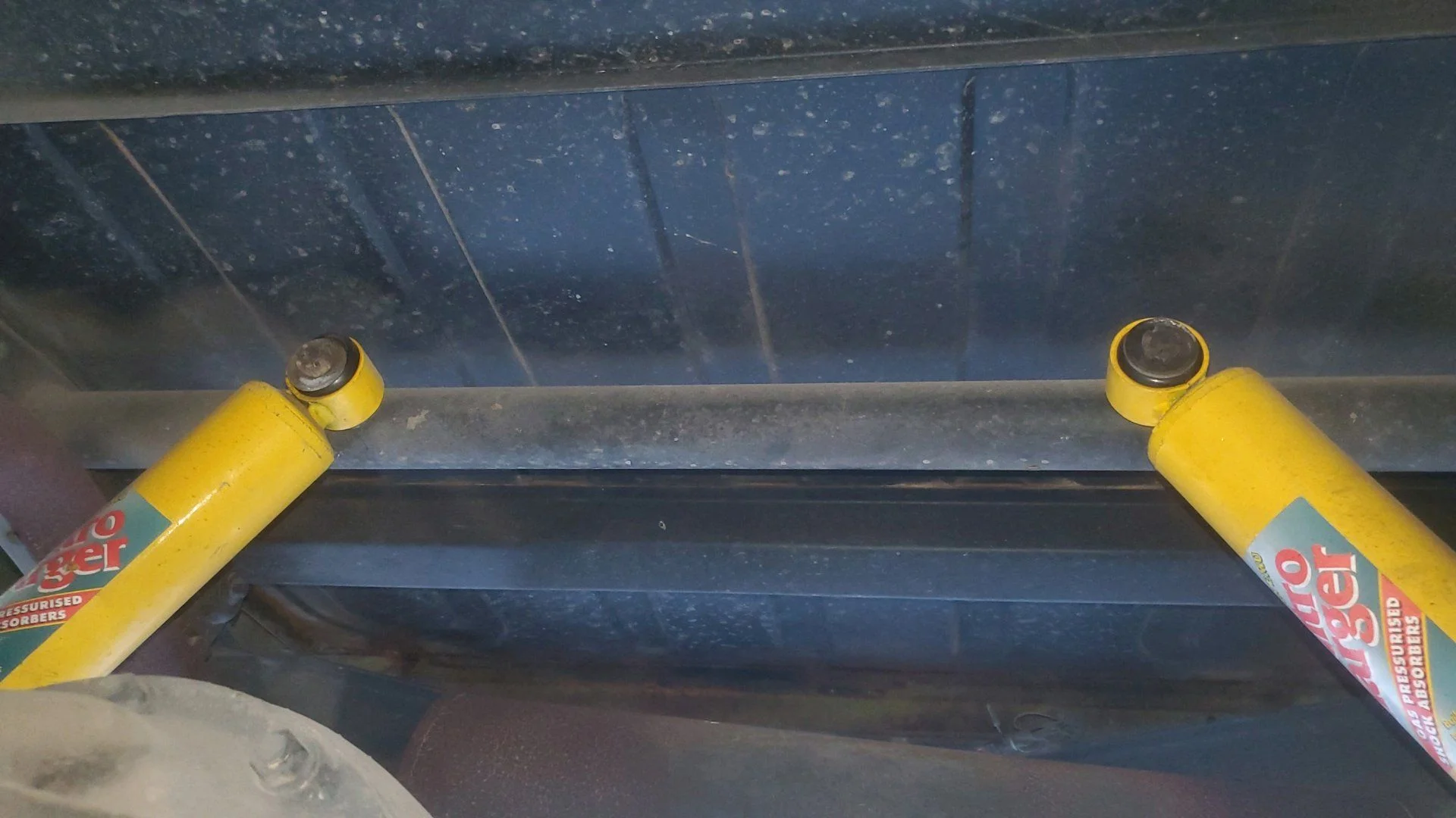

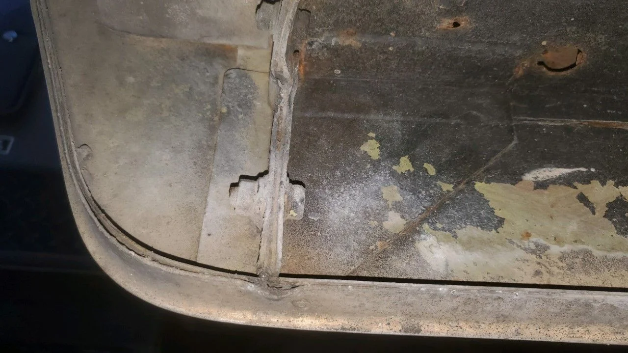

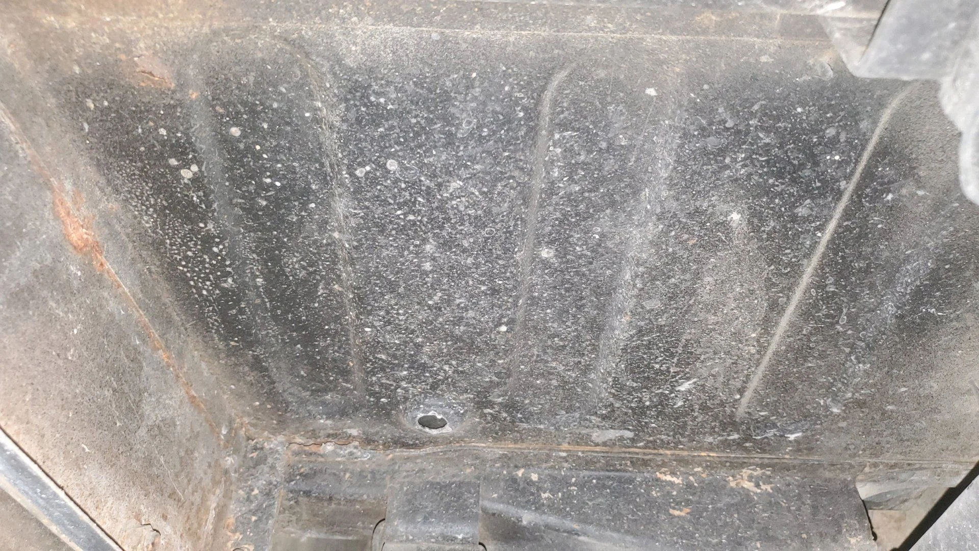

in the meantime. I just went and laid under it, gobsmacked. It's definitely it's best side. I've found a couple of less than dime-sized spots where there's any sort of rust. So, for now, all I have to share are more pics. :)

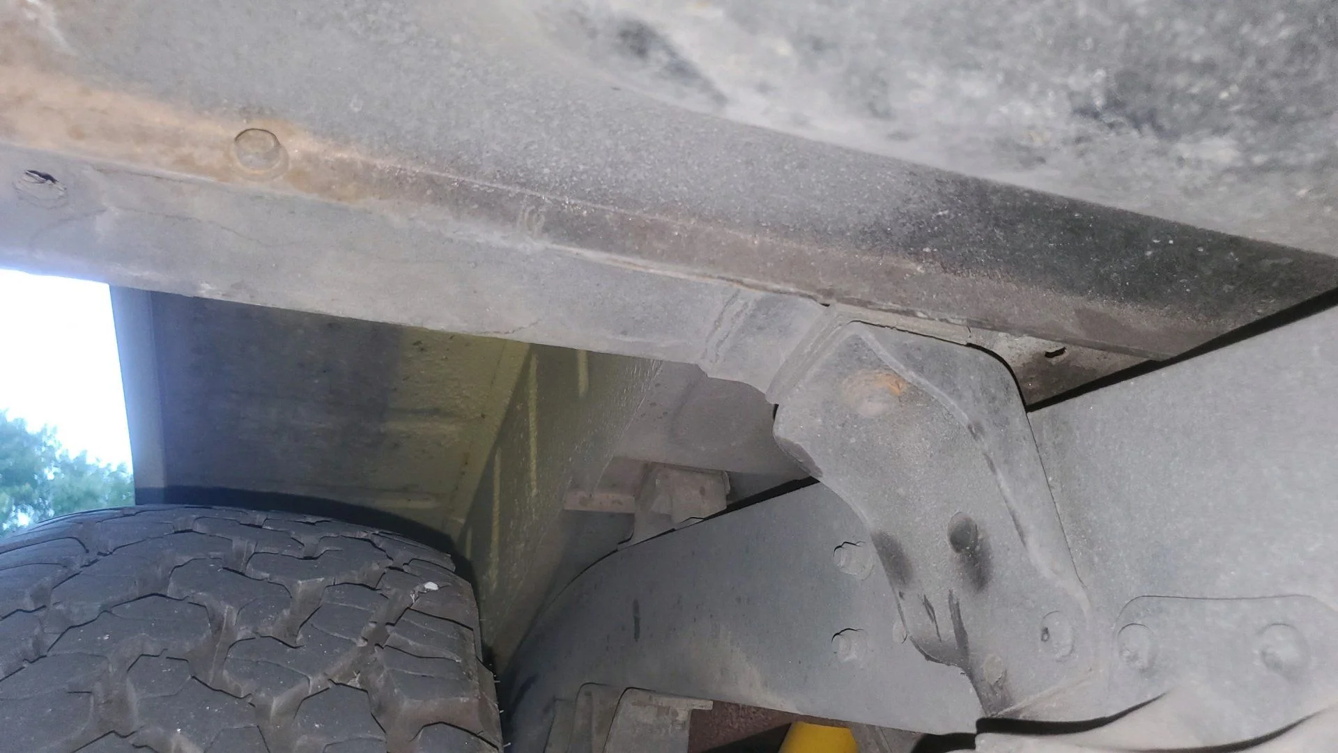

couple more

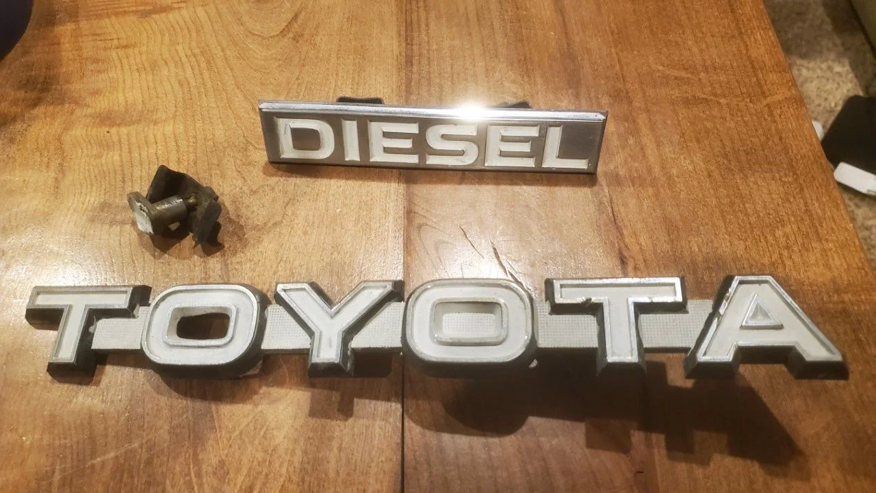

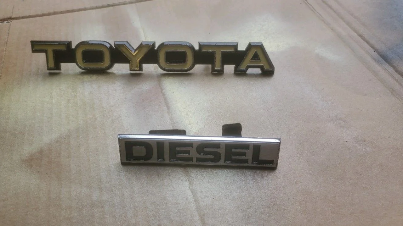

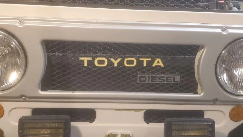

More little things... pulled off the poorly painted emblems up front and touched them up. Painted the diesel logo back to glossy black, and the Toyota emblem back to black, yellow and chrome. Hit 'em both with some clear after. Used aircraft stripper to take off old paint. Worked great and DIDN'T remove any of the chrome from the plastic. Then did a lot of taping, the spraying painting, then touching up with a very small paint. Also used superglue to re-affix emblem to mounting bolt.
Had a helluva time finding a yellow that was close the emblem yellow, but I think I got pretty close. Someone here once used Testers' "phoenician yellow" a '64 Ford color, but I could only find that color made by Plasti-dip. But I found a warm yellow color from Rustoleum and Home Depot that looks pretty good.
Anyway... before and after.
thanks @joestewart - I'm glad I have it as well. Some early easy fixes has the wind in my sails currently. Hope that continues.
I've "revved" up the front emblems (thanks for the edit @joestewart (can you name who wrote that tune?). Looks better already.
Now I just need to get the white off the front bib and the silver off the bezel....

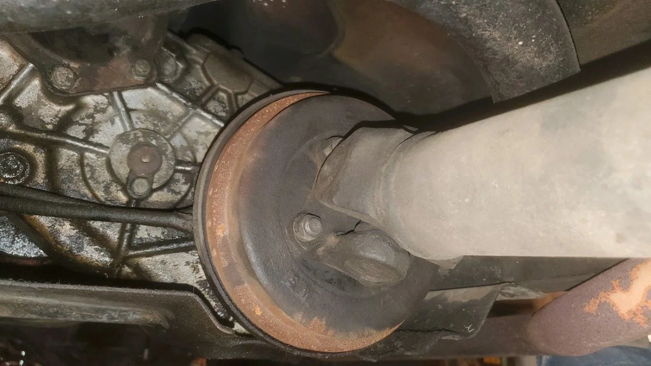

I have just begun to tackle the parking brake don't really have much to offer except some good PO bashing and well-worn words of wisdom.
I went to empty the transfer case as the first step in repairing/rebuilding the parking brake and it was thick graphite gray oil and not every much of it. Like a half-pint's worth. Luckily I haven't driven much, just around town a bit - probably less than 30 miles total and no more than 3 or 4 miles at a time.
I do this with every vehicle I get, but some take me longer than others. It need to be done as soon after purchase as possible - CHANGE ALL THE FLUIDS!
And while I was under there, I saw this:
an orange-rtv coated oil pan drain plug. WTF, people! Most likely just missing the crush washer, which is on order. I'll see when I change the oil, which is also on my to do list after parking brake. Along with a radiator flush and changing the oil in transmission, diffs, etc.
speaking of parking brakes - the cable is connected, but when I pull out the lever, it's like it's not connected.
Any guesses as to what's wrong?
At least it's pretty clean.

Parking brake is working now. Pretty easy rebuild on that one.
